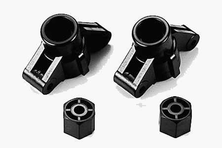

Re: NIKKO 'BRAT' Up Works
Ok , I checked my old mails (2005) and found the nrs inthere:
53345 or OP-345 TL01 Toe-in rear upright set
that 's a plastic tree which has the hexes on it.
http://www.tamiyausa.com/product/item.php?product-id=53345
these are 10 mm, not 6 without a doubt
