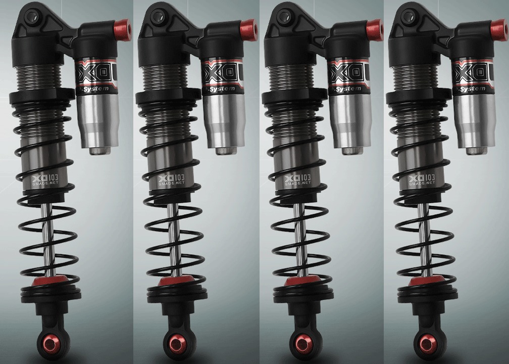

I also bougt new shocks right away. they look real good, and should be a sep up from the integy leakers i have in there now! I got 103mm rear and 93mm front. They are GMade XD Piggypack shocks. Supposed to be good.... heres a pic of them.

You should've just stuck with the stock shocks, they're fantastic. Good luck with the piggybacks, I've always heard they're a joke, that's why you don't see many people using them. JMO
Re: My RC10GT to go brushless
Yeah, the Integy piggybacks aint any good. These get excellent ratings though.

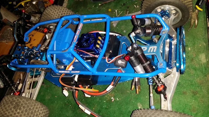

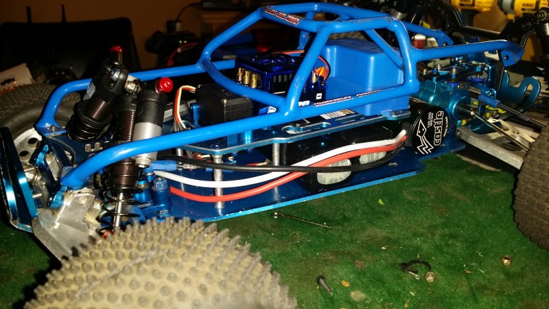

Well guys, my build is getting closer to completion. I got the ESC's and bluetooth programming adapter, and the PC link programming adapter as well. I also got the right pinions (this time)
I got 13-14-15T pinions to play with. I see I need some 4mm bullet connectors, and a few odds and ends yet. I wanna get a new body for mine, the same style. I seen a black "Monster Energy" schemed one on flea-bay, but it was 45.00 ;-(

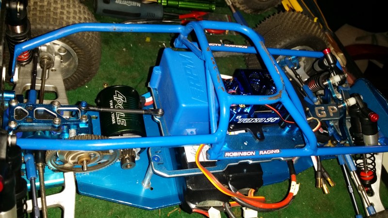

Ok, here are a few pics showing how it will be set up. I need to figure out how I am going to secure the battery's on the lower level. And I need to secure the ESC and receiver box to the upper level. Cut the motor wires and solder up the connectors. but all in all the layout is pretty good IMO. Let me know what ya'll think!?

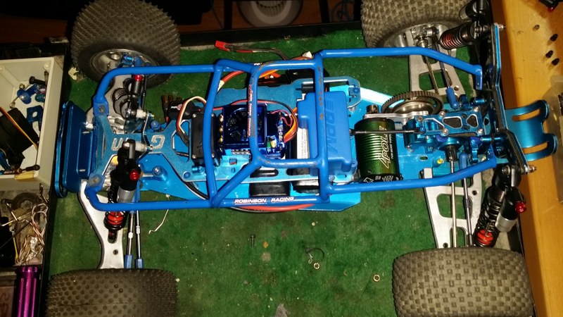

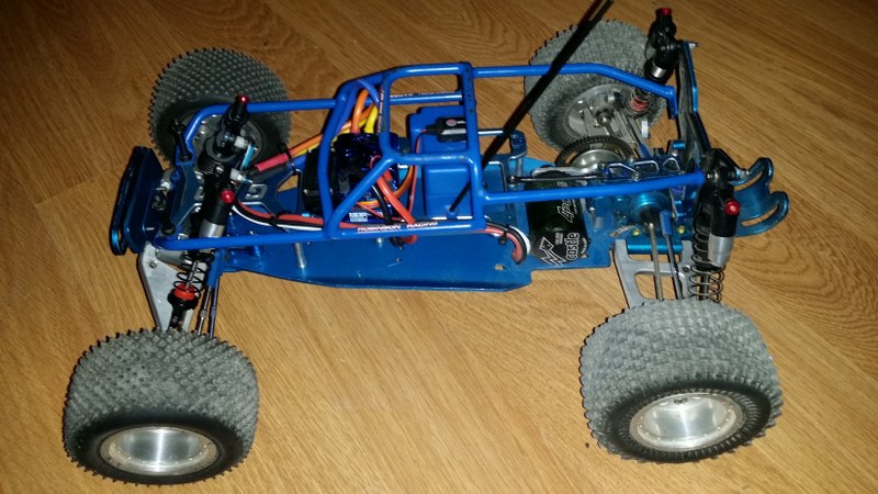

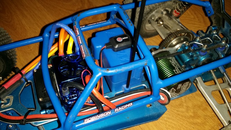

well guys, I can honestly say, my build is 99% done. I got the ESC in and all wired up. I managed to get it working with the WiFi programmer and my Galaxy Note3, so I can program the ESC right thereon the course! Very nice option! (One thing though, one of the ESC's arrived DOA! Im getting another one as a replacement for it, these things can happen!).
Now another thing. Everyone out there rants and raves over the Neu-Castle motors. And Everyone figured this setup would be hairy on 3S, but honestly, I dont think its all that! With one 3S 2200mah pack, i get about 2 minutes of runtime before the cut off sets it down to 30%, and I have to limp in! So im running 2-2200 mAh packs together for 4400mAh. Still not very good run time, and it could be alot faster IMO!!! Im running a 15T pinion for my first try, and will put my 14t on it and try that tonight yet...
with that said, can you guys recommend a truly fast/powerful motor I should try? I don't want to just keep buying motors as a shot in the dark.... I want an insanely powerfull motor on 3s..... hell, this ESC will do 4s, so maybe I should look for something that can handle 4s? I want uber power, but still be drive-able. My trucks weight is certainly a factor, as its all aluminum, and a bit heavier than the average 'GT.
Here are a couple more pics of the almost completed build! Hope ya like!

I just got back inside from trying the 14T pinion, and I believe it may be what im looking for! The acceleration out of the hole is very quick, but im not sure if there is enough top end. I think its better than the 15T, but ill find out when we get our track built and start racing! I also noticed I need to try and set up the geometry of the truck too, when i come out of a turn, and add the gas, it want to whip around too easily. I think i need to transfer more weight to the rear..... thats part of the fun, setting them up! So far so good..... But im going to order a Toro 4500kv motor I think and give that a try. Ill prolly get a couple different motors over the winter to get it set up just right!

Looks good. I like that cage on there.
Thanks! Yeah, i like the cage too... As a matter of fact, my son really wants one for his build as well, and I cannot for the life of me remember where I got it from! I cant find anything "cagey" for him! Im also looking for another RPM "upper frame deck" as it sure worked well mounting the ESC/radio box up top on it, and the lipos on the bottom on the main frame "pan". I have to send one of the SC120A ESC's back for replacement, as it came DOA.... but the seller states they will fully refund my shipping back to Kong Hong and send me another working one. Its a minor set-back.THEYTOOKMYTHUMB wrote:Looks good. I like that cage on there.
