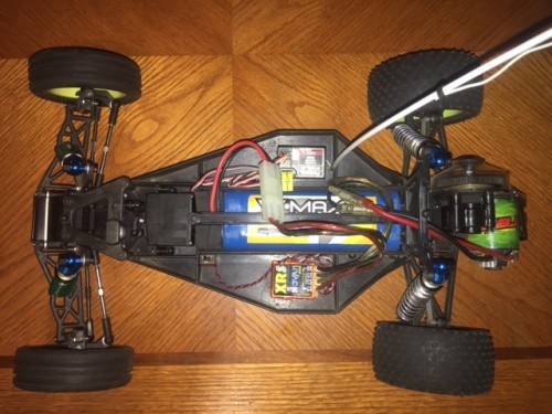

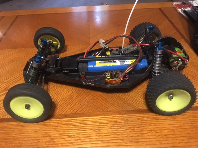

Re: RC10B2 shock help
Well I got this 21 year old car running with old school electronics. I am going to upgrade to modern radio, lipo and brushless at some point.
Here are a few pics without the body, I need to strip the ugly white paint job and repaint. LOL
