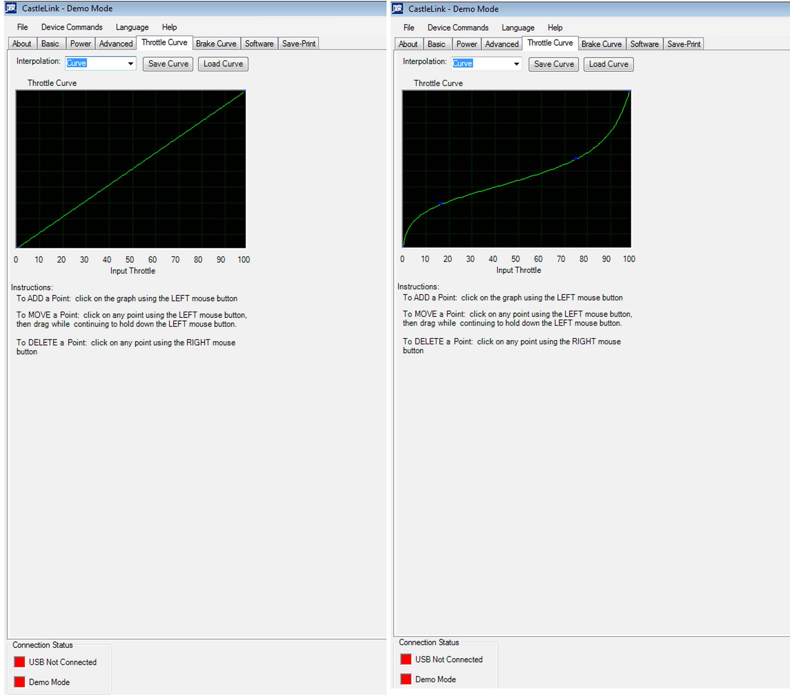

I also recommend you invest in the Castle Link. Being able to adjust the ESC with a computer is so much easier and you can fine tune the settings to your driving style. You can download the software from Castle and run it in demo mode to see what it has to offer (http://www.castlecreations.com/downloads.html). I like to play around with the throttle curve. Right now I have mine set like the one on the right below (the one on the left is default). The initial steep curve helps eliminate the cogging at low speed, the gradual straight line helps reduce wheelies, and the increase at the end is like hitting nitrous.
