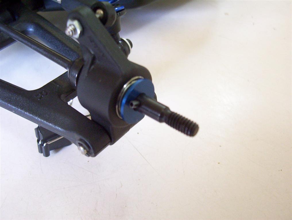

My parts turned up :D
The B4/T4 axles worked with the RPM hubs with the addition of one #7368 shim per side,
http://www3.towerhobbies.com/cgi-bin/wti0001p?&I=LX2976&P=7
and using the Blue washers, 9608.
http://www3.towerhobbies.com/cgi-bin/wti0001p?&I=LXEAD3&P=7
But with the axles I received, the roll pin hole is loose, I had to put a crimp in the center of the roll pin,
using an old set of side cutters, to get them to work.
I checked the B4 and T4 manuals, I have the correct roll pin # 7369.
https://www.teamassociated.com/pdf/cars_and_trucks/RC10B4/drawing_b4.pdf
https://www.teamassociated.com/pdf/cars_and_trucks/RC10T4/Factory_Team/drawing_ftt4.pdf
I just sent Team Associated an E-mail.

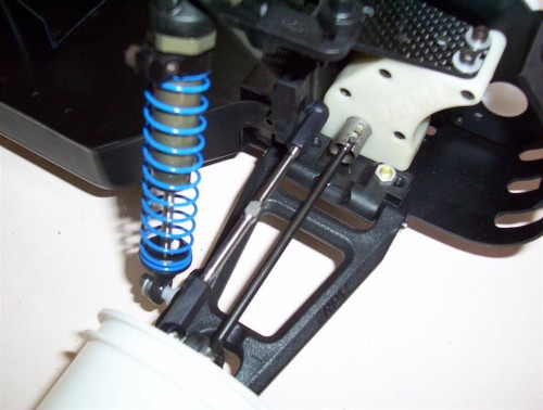

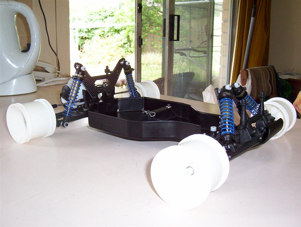

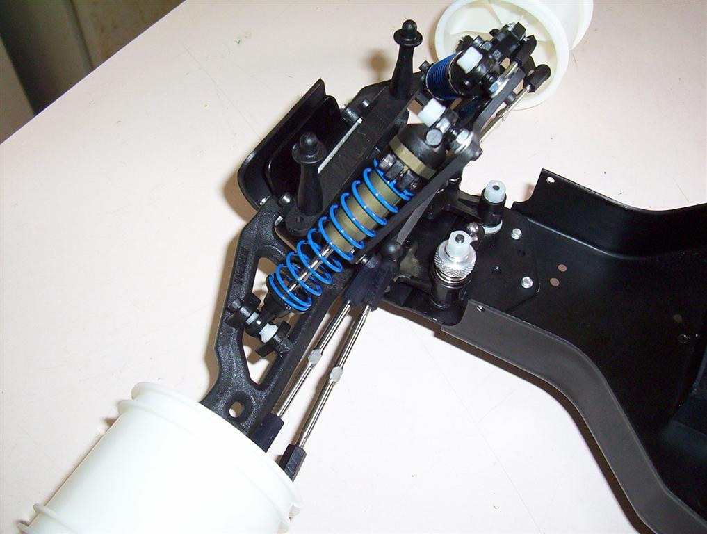

Hi Guys,
Latest pics,

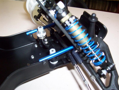

I put the blue Team nose tubes on, I didn't think I would like them.
But with the blue springs it looks great.
Need to take a pic.

Hi Mate,
I am not sure, this is where things will slow down,
I wanted to use a Team body, but I only have an early body from TBG.
Here are some more pics,
