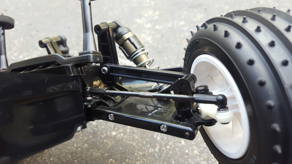

I took the gamble to drill out the ball studs and it was a good idea. I found some old hex style AE turnbuckles that were the perfect length with the shorter AE ballcups. I also flipped the steering blocks and installed some AE ballstuds on top. Bump steer is gone and steering works fantastic, if anything there was too much steering to the point where the tires would touch the body. The EPA had to be dialed down a few % and seems perfect at the moment.

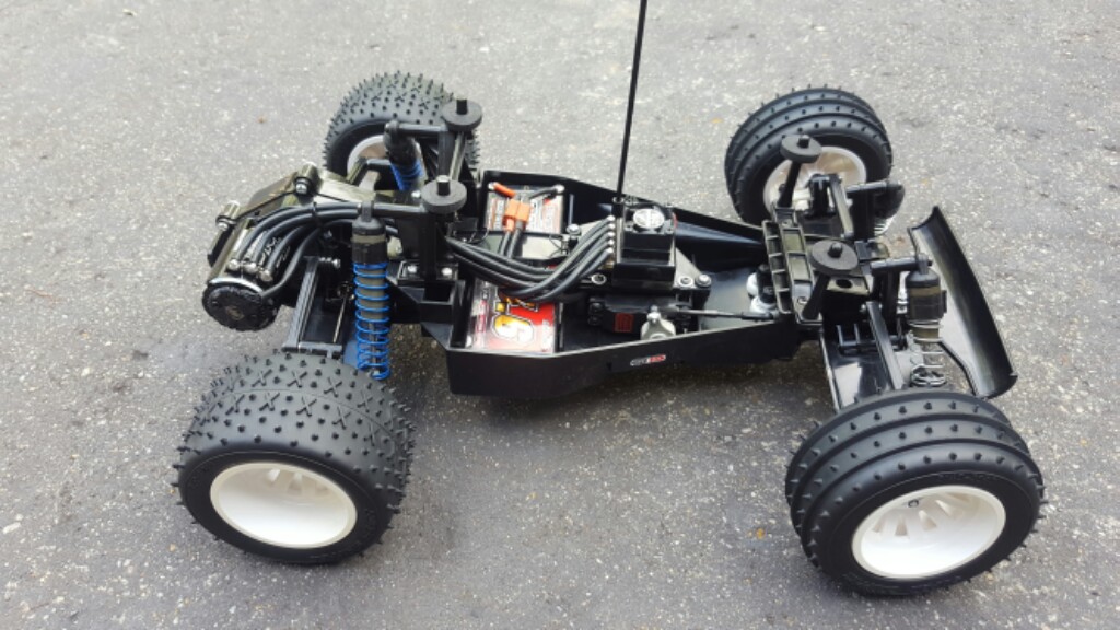

Not the best photos but here is the new steering set up and electronics.

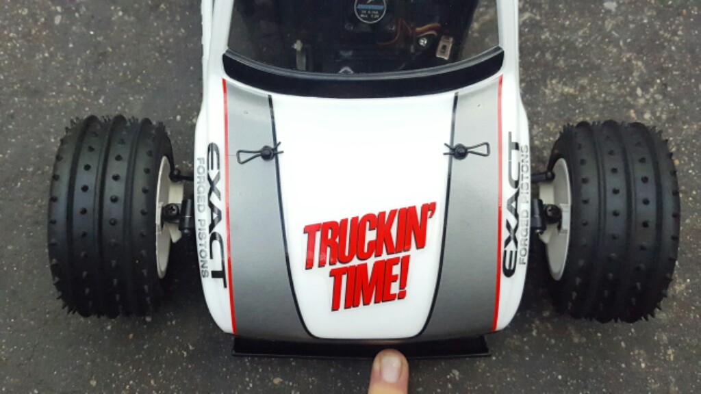

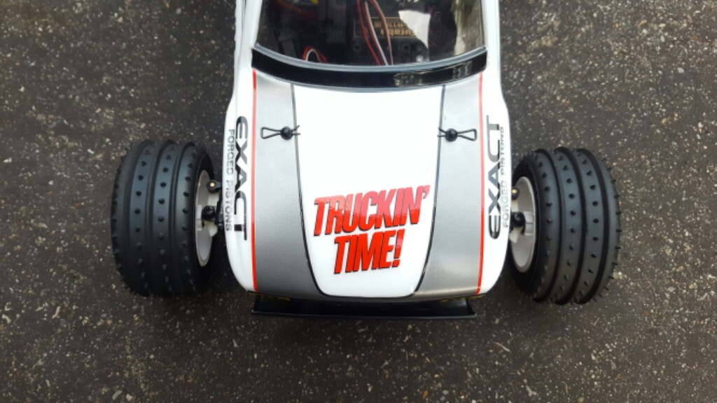

And bump steer before and after.
#1 Ride height
#2 Suspension compressed (Original design)
#3 Suspension compressed (Modified design)
#1 Ride height

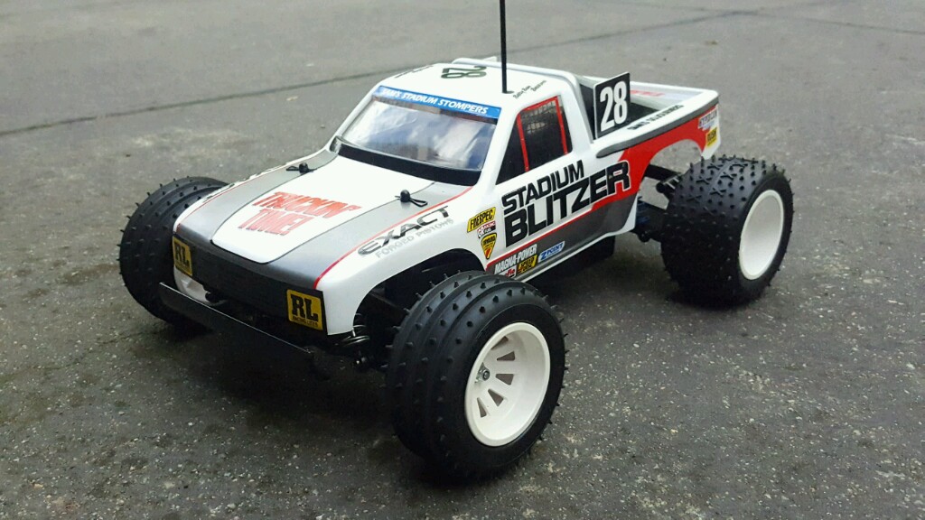

All ready for a truckin' good time...

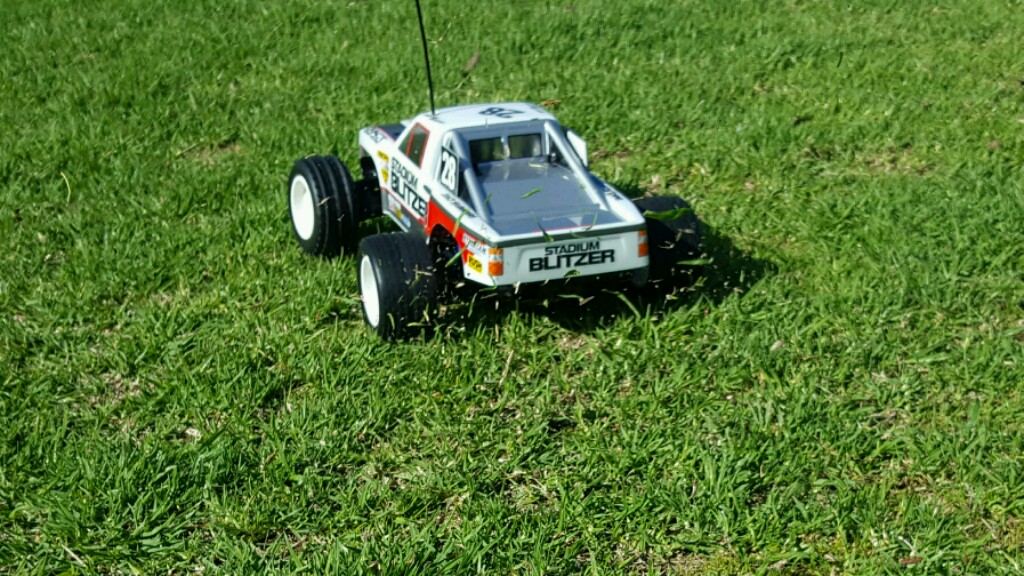

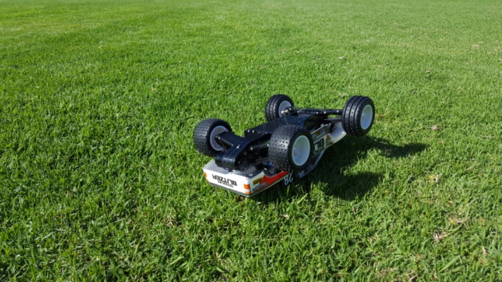

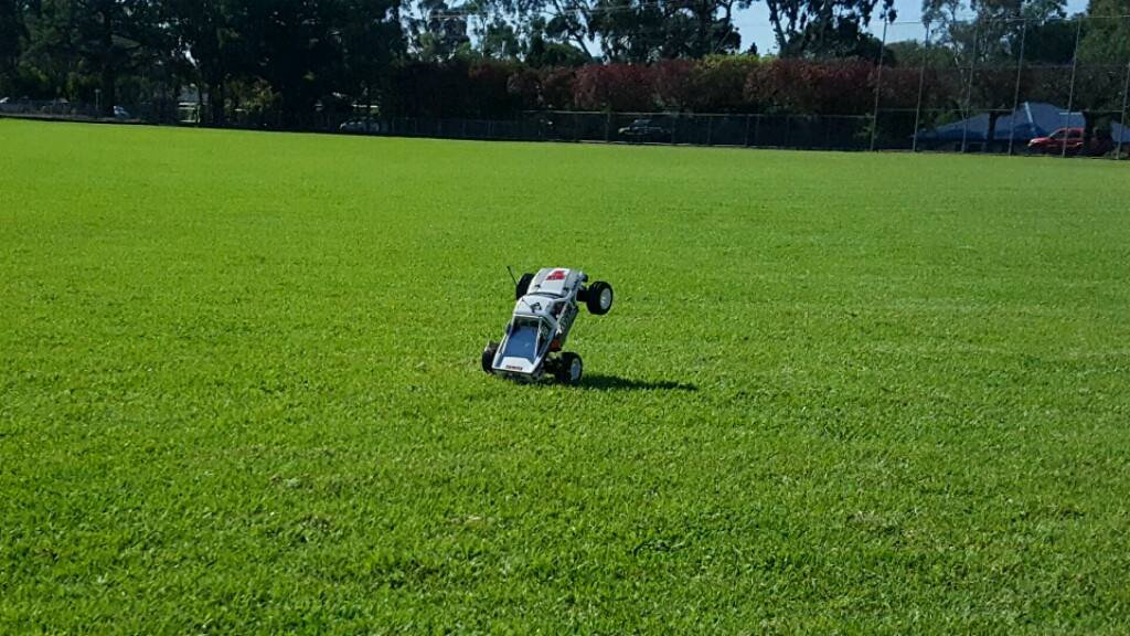

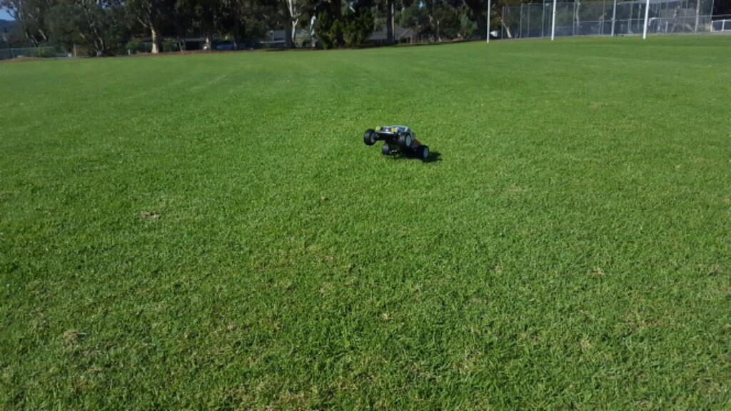

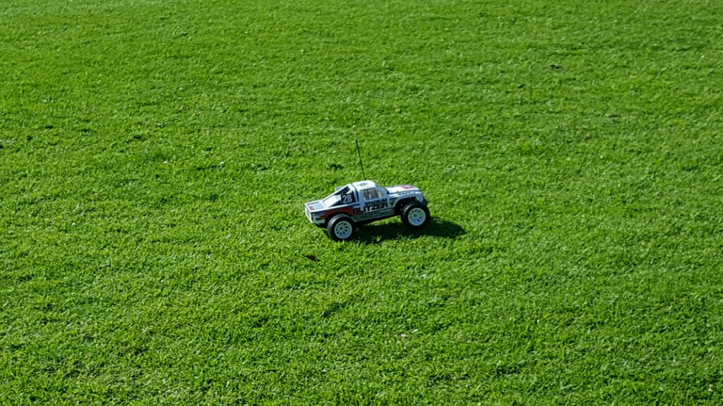

Went to a park today and had a blast, it was good to get back to the basics and have some fun. Even the wife had fun driving the Blitzer around.
There was a bit of boost and turbo wound into the ESC which was good in the wide open space, plenty quick and plenty of power. The grass was pretty power hungry but battery life was good considering.
Photo uploader will kill picture quality but here are some action shots

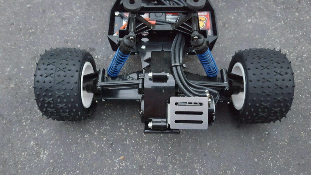

Keeping with the theme I added a basic heat sink that I think is pretty fitting. The motor gets warmish running in the thick grass with boost so hopefully the heatsink makes a little bit of difference. I will dial it back a bit as it's much quicker on the asphalt then it needs to be, but borderline out of control on the grass is fun, lol
