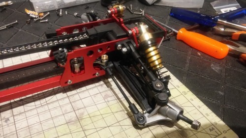

I have not worked on one of these in 30 years and that was a Turbo Optima Mid Se. These sure are not easy service. Goes together like an erector set and to do one thing involves taking practically all apart. Very cool though in a retro way. Interestingly the red ano kit did not come with the bottom chassis plate. I may just polish it up for contrast.

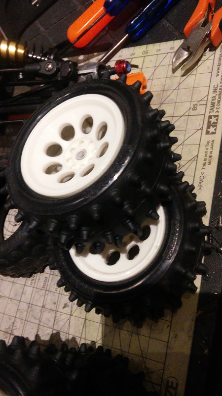

You mentioned some Schumacher tires might fit the original wheels? I was thinking these from CRP? Anyone confirm before I buy? Or any others that fit original wheels, the original wheels are growing on me. Might even paint them, it won't get much run time.

I haven't used those Schumacher tires, but they look like they'd fit. 1.9" - 2" inside diameter, all good. As long as they're between about 35mm to 39mm or so wide, they should fit.

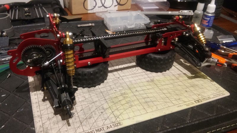

Just noticed the original tires 340-30-20 markings on side, same exact as these CRP one. So I ordered them up.

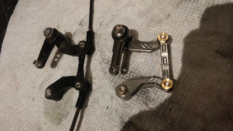

Jazrider steering.

RCveteran wrote: Fri Aug 11, 2017 4:55 pm 20170811_095158.jpg Jazrider steering.
I've seen Jazrider's parts, have a bunch of them in my eBay watch list...they look pretty nice, and the price is right...is that steering crank a drop-in replacement, needing no mods?

I did have to drill out one of the arms as it was just too tight on the steering post. Basically I found a drill bit that was just slightly larger than hole and honed it out. Not a huge feat. So I can't say it was perfect but maybe i was just unlucky. Beyond that for the price it is beautiful and works very nice. It is a drop in and comes assembled.

The CRP tires fit wheels perfectly.

If you're looking for some road tires, CustomWorks Street-Trac rear tires also perfectly fit the Turbo Optima 1.9" wheels...use foam inserts, of course--not the stock Turbo Optima plastic inner rings. The outside diameter is less than stock T.O. tires, so you may need to gear up a tooth or two to compensate.

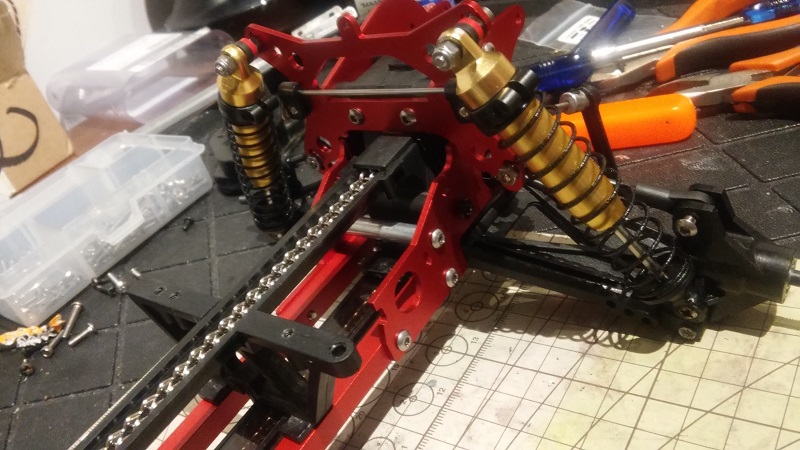

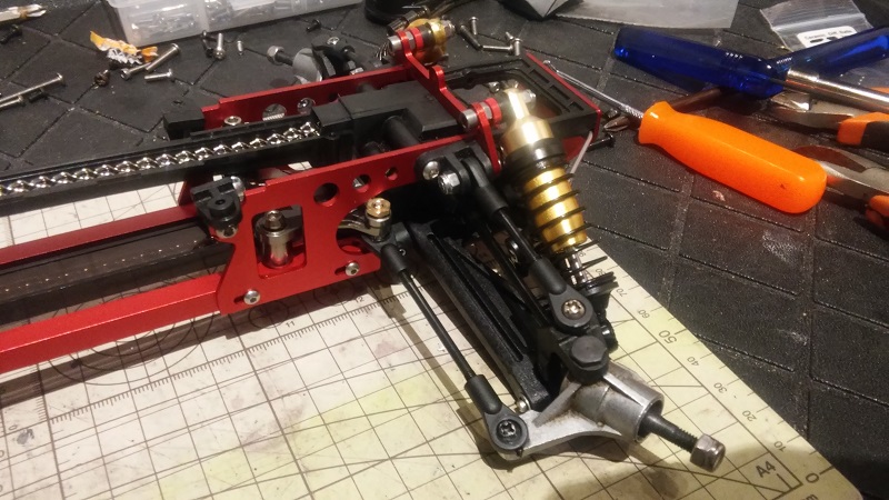

Almost there.

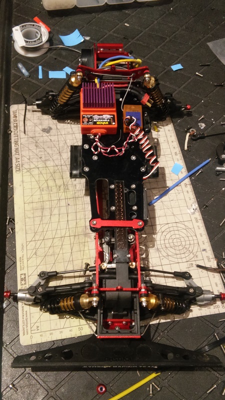

Re: I Salute You.
Post by RCveteran »
Almost there, waiting on red shock collars from Korea. Last time it ran was 86 or 87 maybe 1991 at latest per my buddy.
