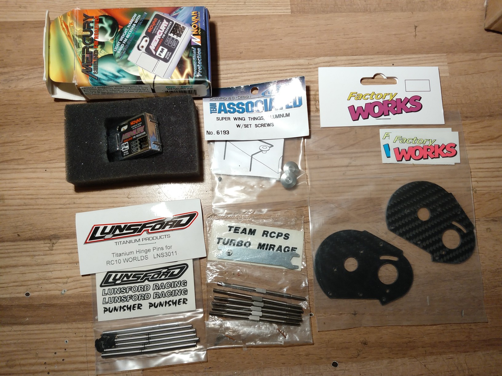

While some parts are getting the peroxyde treatment before the dye, I dug further into the parts box, looking for andy's arms.
And I found some rears and other tidbits I would not use this time anyway:
Unfortunately, no matter how deep I dug, no fronts to be seen... I have some white fronts, but, c'mon, not gonna dye these :roll:
I did find a set of parts i had totally forgotten about, though 8) I certainly won't use them for this build but hey I feel good having them in the stash :mrgreen:
Net - I either find a set of Andy's fronts (going to the BST section now) or this will receive team car RPM or stock AE worlds black arms.
... which also show I have pretty much all needed black parts to start that build anyway (who cares if I run 1.5deg or 3deg rear toe).
Still waiting on a couple of other tidbits and we shall get started sometime in march :)
