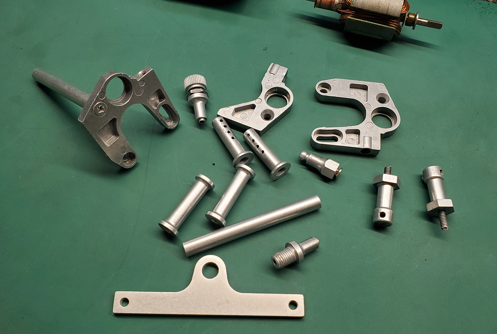

The lazy-man technique that has worked the best so far is vibratory tumbler with green resin pyramids. The parts below were a bit rough, and all I did was run them trough an ultrasonic, rough sand the high spots, then threw them in the tumbler overnight. I have about 5 minutes of actual work on them, and the final finish is just about what I was looking for.
- Coelacanth
- Posts: 7421
- Location: Alberta, Canada
- Been thanked: 325 times
Re: Making Aluminum Parts Like New Again; I.E. Clean But Not Shiny
Nice...those look about as original as you can get. It's great that it was also so little elbow grease.morrisey0 wrote: ↑Sat Oct 30, 2021 8:58 am The lazy-man technique that has worked the best so far is vibratory tumbler with green resin pyramids. The parts below were a bit rough, and all I did was run them trough an ultrasonic, rough sand the high spots, then threw them in the tumbler overnight. I have about 5 minutes of actual work on them, and the final finish is just about what I was looking for.
