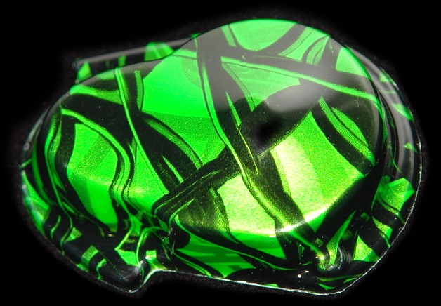

I've tried a new film, and I really like it.
It's on Sabulatech's RC10 6 gear clear gear cover. A very nice, strong cover that fits my motor mount perfectly.
Dipped on the inside, the film is backed with Createx iridescent green and then white.
Not quite as reflective as the metal flake on the blue flames dip but very nice.
Chuck
Chuck

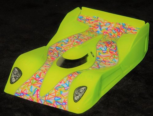

Thought I might try something a little bit different.
It's going to need a lot of MCI stickers though, just ordered them.
Not really sure if I like the "look" yet. Stickers should make a big difference, I hope.
Chuck
Chuck

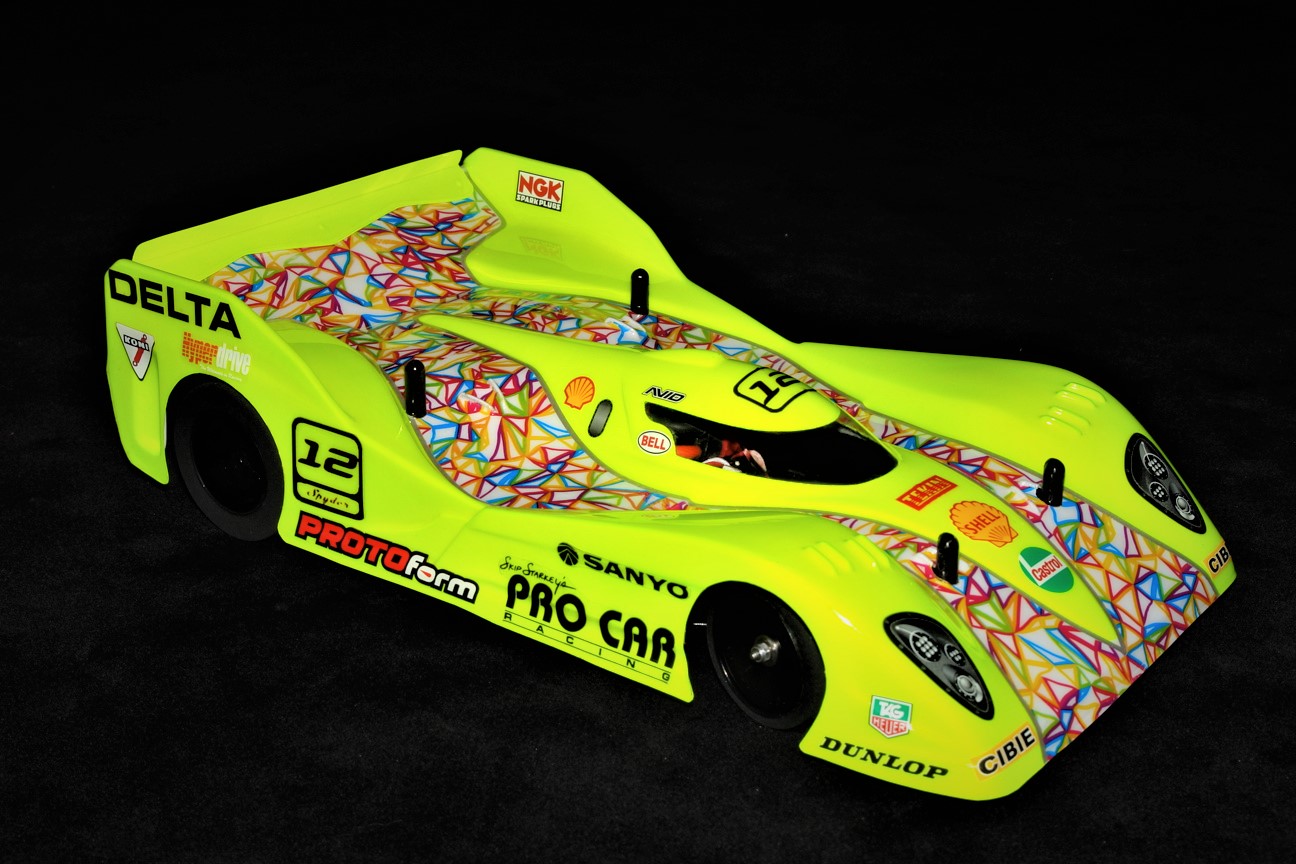

Finished the body and I must say I think it changed dramatically.
Every bit as nice as I hoped. Under good lighting the paint is very fluorescent, it really pops.
Some of the decals are truly vintage. Tekin , Sanyo and ProCar Racing are over 30 years old.
Delta, Hyperdrive and sponsor decals are MCI.
The number decal, I made.
Chuck
Chuck

Amazing Chuck, just stunning!radioactivity wrote: ↑Tue Oct 09, 2018 9:38 am Finished the body and I must say I think it changed dramatically.
Chuck
