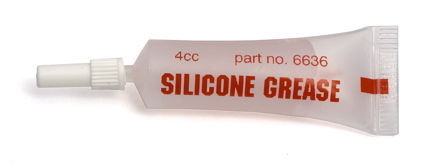

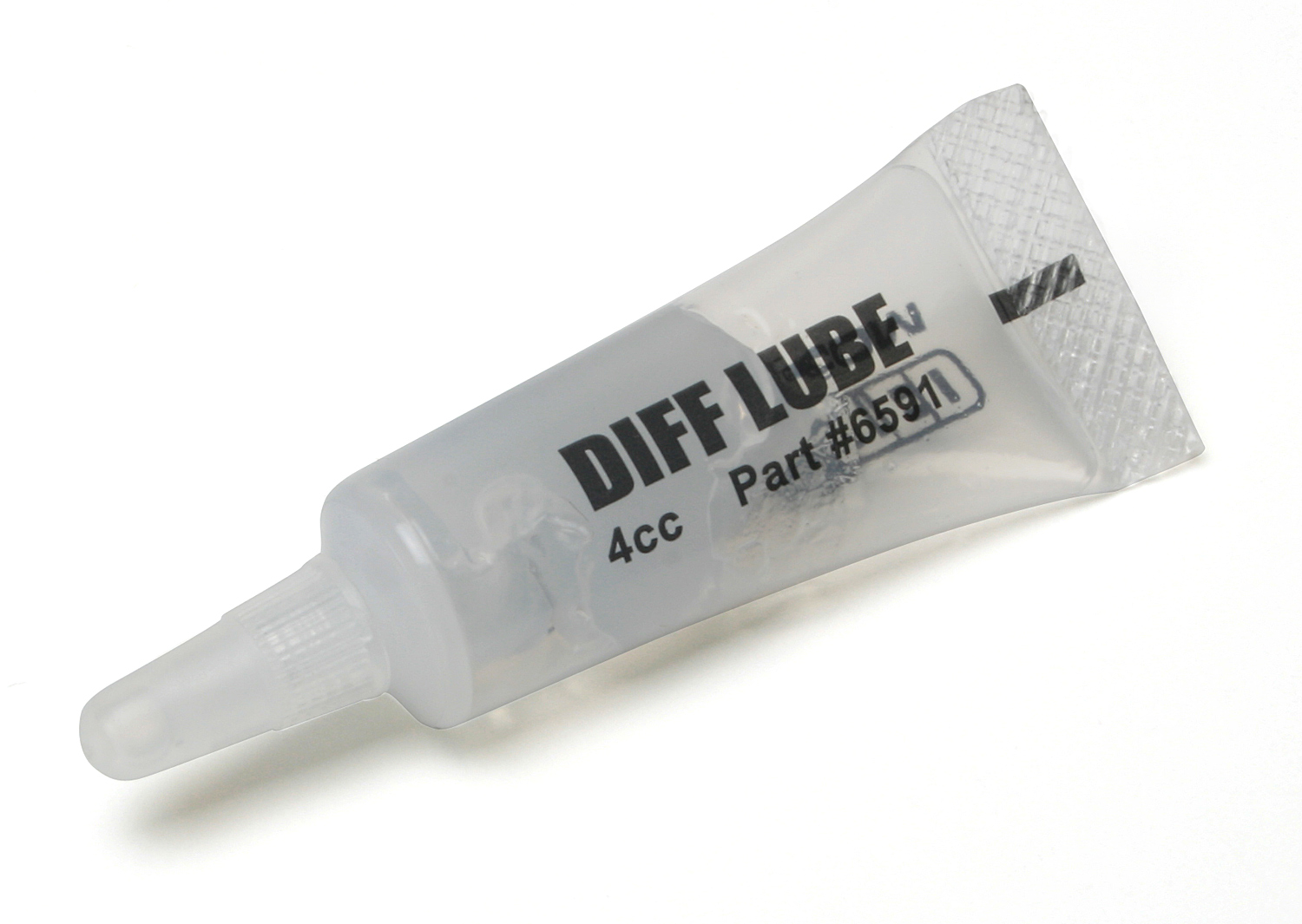

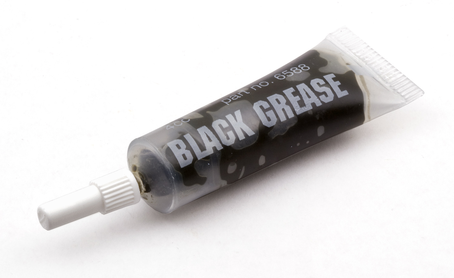

Here are the three greases AE make or repackage. The standard silicone grease will kill a diff.

The associated silicone lube looks suspiciously like the silicone lube you use for plumbing fixtures and rubber washers.
