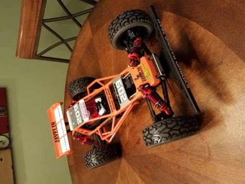

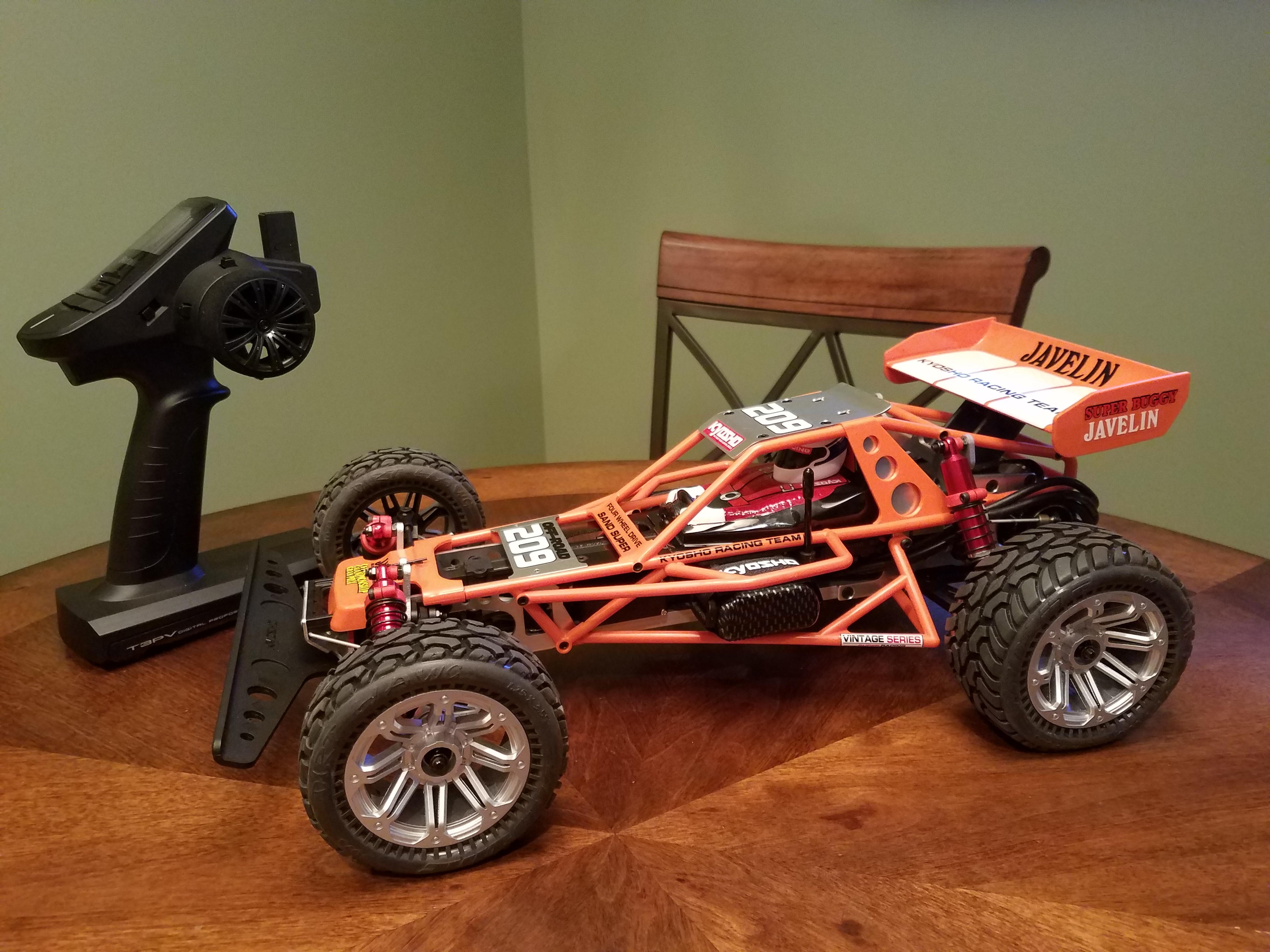

Get a load of this...
Kyosho America only shows peppermint green, white & orange bodies for the Javelin, however, red, yellow and black are available in Japan. I ordered a black cage & think I'll have to build another Javelin just as soon as it gets here. The black is just too bad-a! My wife is gonna kill me.

I've got all the colors myself at this point on the way. Can't believe what some of these flippers are charging for these re-re cages. I didn't pay over 39 bucks a cage set myself and can't wait for some more pix to surface of builds. I was thinking and all black annodized set along with a black cage all murdered out would be cool but need to stock up on some more javelins/optimas before I can do that

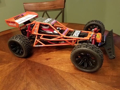

Today I received care a package from Kyosho. I ordered a stabilizer bar kit, a spur gear designed for a brushless set-up and front & rear 4wd Dirt Hog wheels. The stabilizer kit & gear are still in the box, but I wanted to see how the 2.2" Dirt Hogs looked on the Javelin.
I have to say I was hoping to use Turbo Scorpion satin chrome rear wheels front & rear on the Javelin for running...but they are on backorder and who knows when they will be back in stock. I mounted a set of front (now discontinued) Dirt Hawg tires and rear Dirt Hawgs on the Dirt Hog wheels...I know...lots of hawgs and hogs. The Dirt Hawg tires have been in my inventory for a decade and were looking for a good home.
The look isn't exactly anything that trips my trigger, however I'd bet that they will do pretty well for a basher. I've used Dirt Hawgs before on the rear of 2wd basher buggies and they last a long time and work reasonably well on a variety of surfaces. I like to play around the house on a long concrete driveway, on an asphalt cul-de-sac in front of the house as well in grass and dirt in our yard and woods around the house. The Dirt Hawgs are a pretty good all-around basher tire.
I'll keep the kit wheels & tires for the shelf...and probably paint the Sand Super's white for good measure.

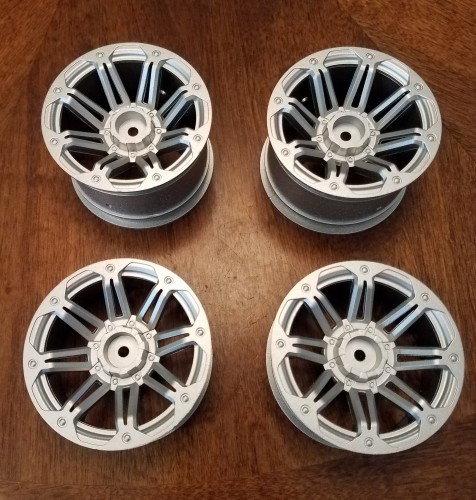

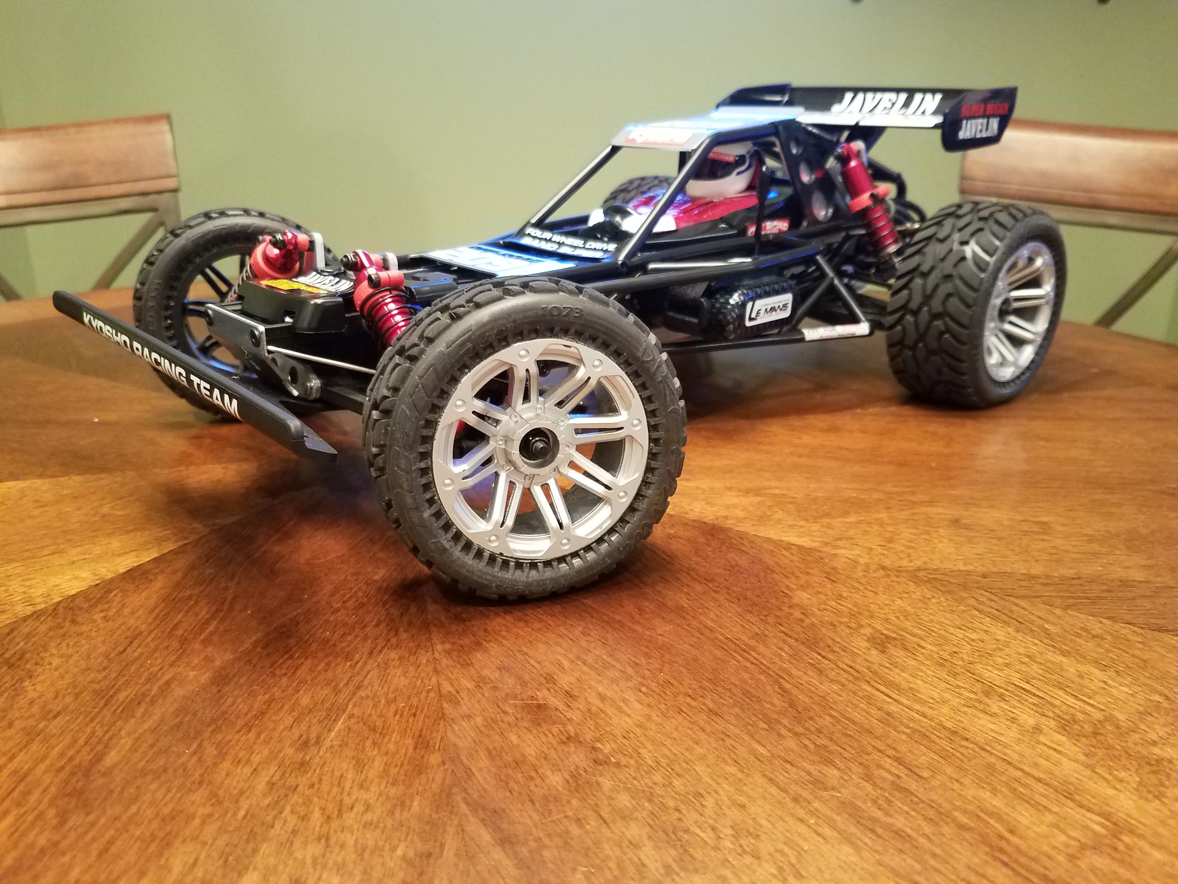

Thanks for the encouragement. I looked in the garage and still had a can of silver (supposed to replicate chrome) Krylon that I used to refinish my original Javelin wheels back in 2007. It was still good.XLR8 wrote: ↑Sat Jul 14, 2018 11:55 am Yeah, I agree, if you prefer a different color then just paint them. Actually, I think you will find that the paint will hold up very well. Probably should use the toughest paint you can find though. I painted the exterior of the Mid body with Krylon epoxy enamel (allowed time to cure fully) and after many runs, it hasn't a single scratch; it's held up beautifully. I wouldn't hesitate to use the same paint for wheels.
While it does a poor job looking like chrome, it has just enough shine to look like brushed aluminum. I think they turned out pretty good. The picture doesn't really do a great job capturing the finish. They actually match the brushed aluminum on the chassis and body pretty darn well.
It's a shame Kyosho doesn't offer these wheels in any finish other than black. There is a lot of detail in the design of the wheel and it gets lost in an all-black finish.

Holy smokes! Yes, tons of little details that you just can't see when they were just black. I think they look great in satin silver.
For a little added protection, you also could apply a couple coats of duplicolor clear that is made for wheels. I use this for my polished motorcycle parts and it works great.

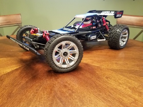

Re: A tale of two Javelins...

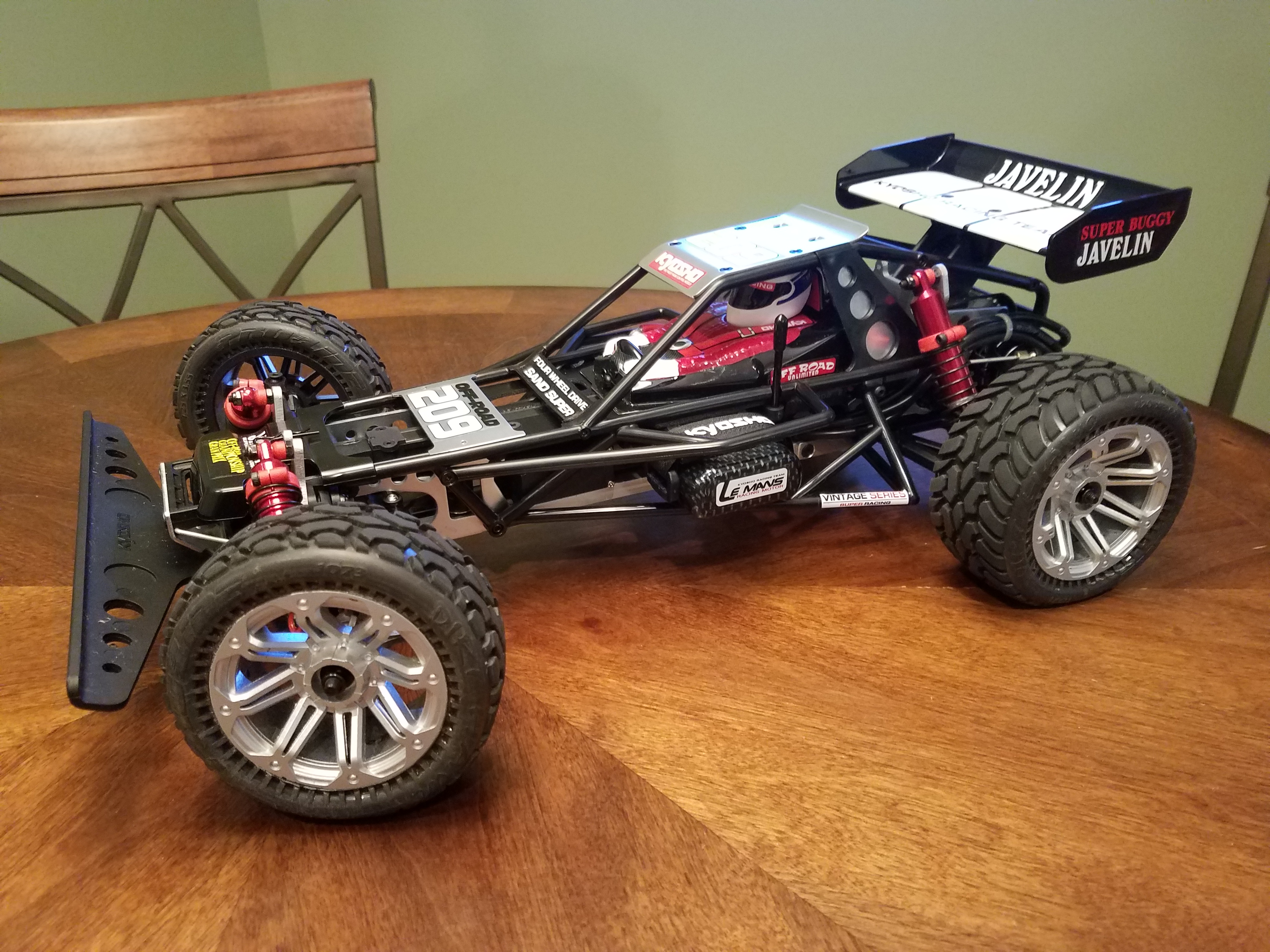

Here's what it looks like with the Dirt Hogs painted silver...
...(in my humble opinion) much better than they looked in black...
They may be hard to see, but the stabilizer bars are in place. I also installed the 51 tooth spur gear intended for brushless motors. The instructions said to step up to a 30-32 tooth pinion but that was based on a 15.5 turn motor. Since I'm running a 8.5 I installed a 25 tooth pinion...we'll see how it goes.

That looks fantastic! Well done.
When it comes to gearing, I tend to sneak up on it. It's ridiculously simple. Start with a small pinion then check motor temps often during the initial run and take note of run times. My technique is also very unscientific; if the motor is too hot to touch, I've gone to far and it needs the smaller pinion.

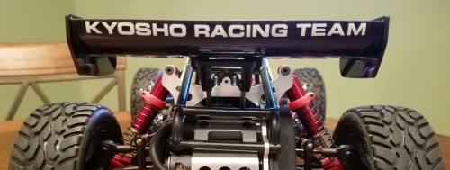

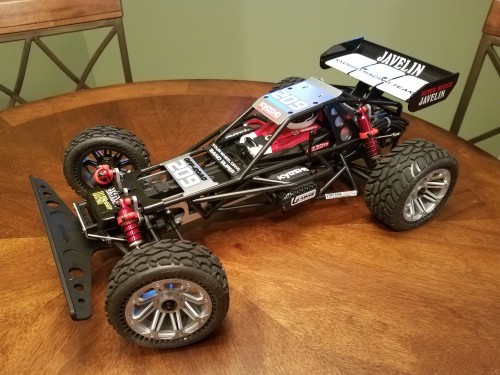

Last night my black body arrived from Japan...
I've ran a couple of packs through it and feel that 8.5 brushless was a good choice. It's fast but controllable. A full throttle pull even with the buggy at speed will easily cause a wheelie.
The handling is light-years beyond my 2wd Kyosho re-re Turbo Scorpion and Beetle. The Javelin is actually really fun to bash.
