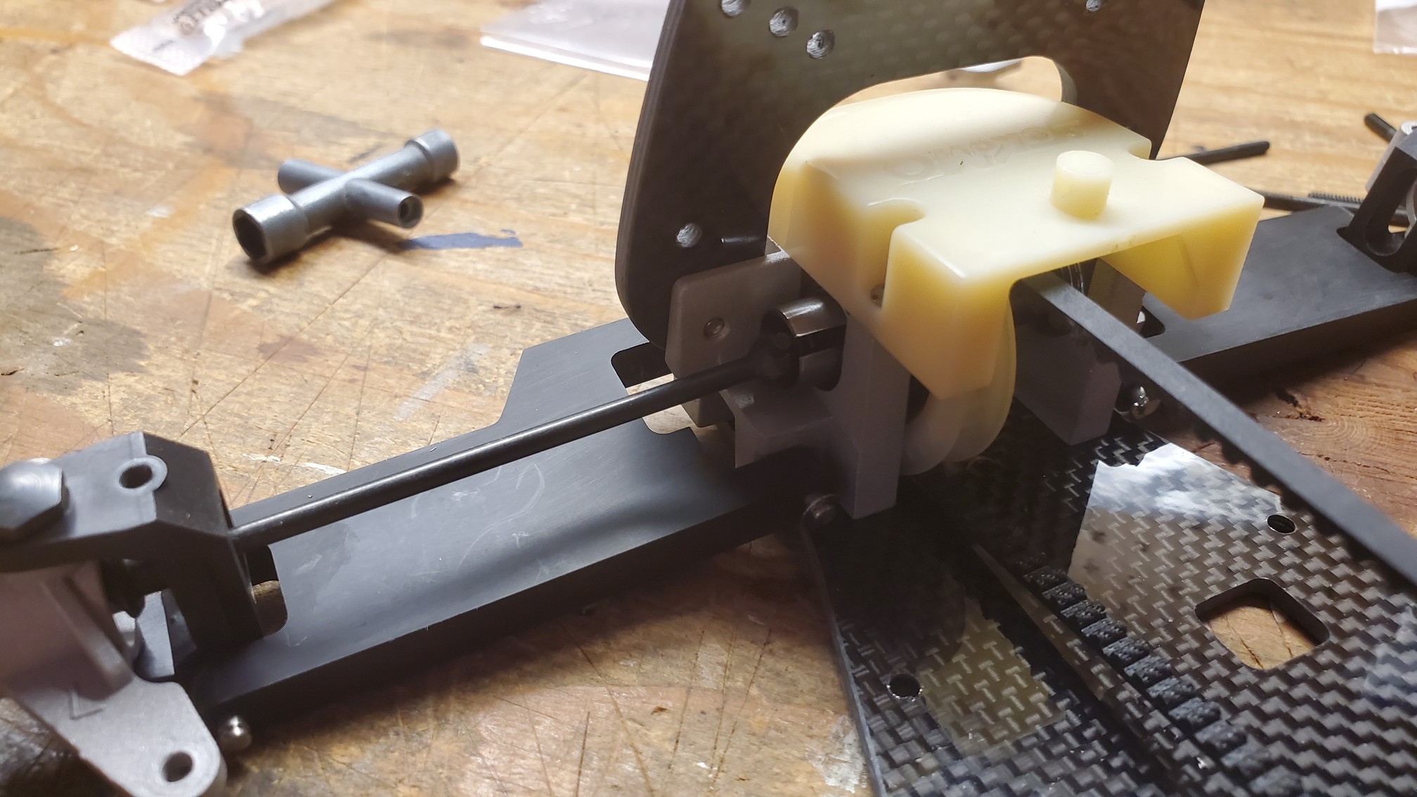

mikea96 wrote: Thu Oct 10, 2019 9:03 pm Well I got the diffs built and installed, belts installed and caps. Then installed the shock towers.
The finish on modern CF just blows away how it was done BITD. That fiberlyte chassis looks like it belongs inside a Mclaren. I spent a LOT of time getting the '91 Stealth finish as close to the original as possible but it would have been nice to have one with that high gloss. Do you have an original Yok body for this or are you using a replica?

Mounted the suspension arms. Axle bearings are soaking then I will install axles.

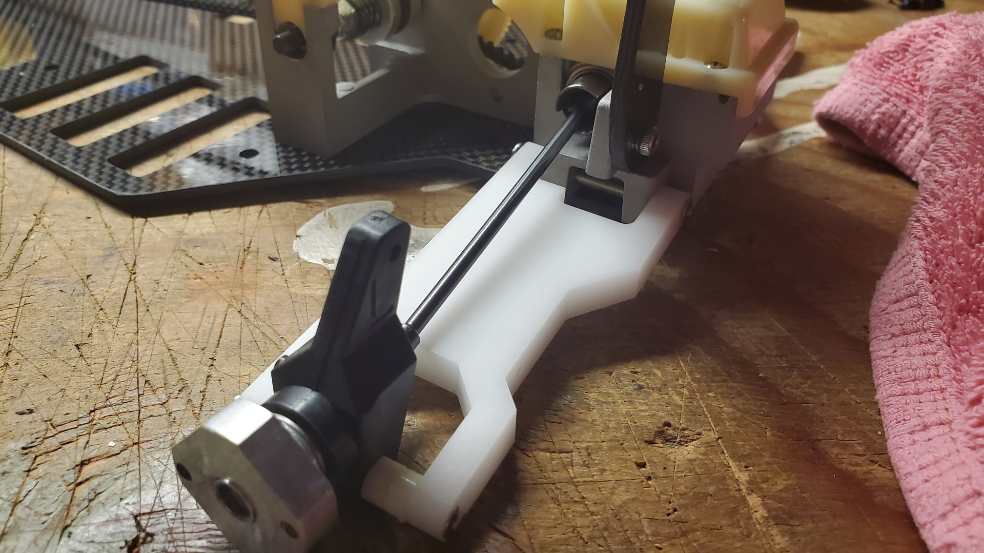

Ok yokomo experts I need some help. So I'm running rear arms on the front and I installed the wide front end kit with longer universals but they are too short. Is there a longer universal or do I need a different steering knuckle? Thanks guys.
jwscab
Posts: 6580
Location: Chalfont, PA
Been thanked: 505 times
Re: 870c project
Post by jwscab »
Long front arms should need rear universals.

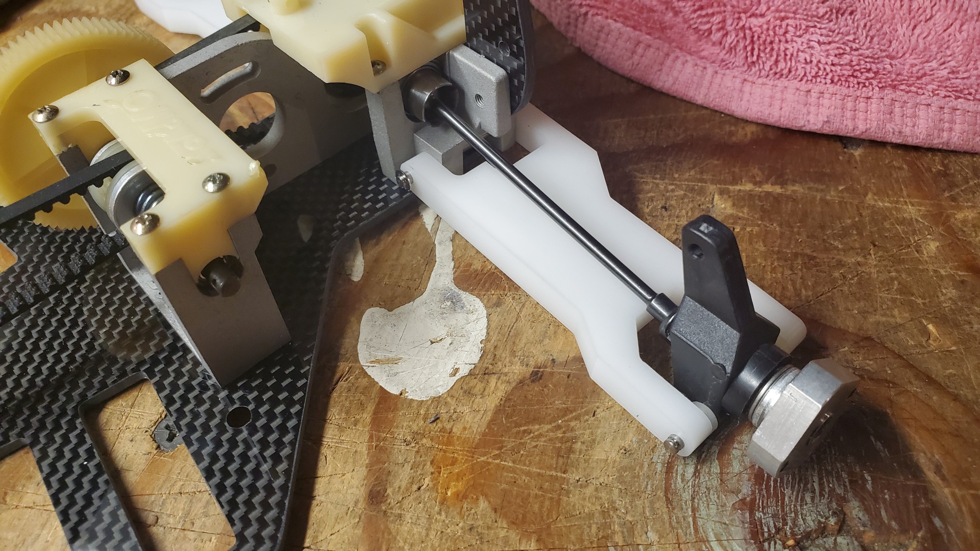

mikea96
Posts: 3599
Location: Puyallup, WA
Has thanked: 659 times
Been thanked: 878 times
Re: 870c project
Post by mikea96 »
These universals are the longer ones. They are longer then what the stock ones were.
jwscab
Posts: 6580
Re: 870c project
Post by jwscab »
Not sure about those arms. The long front setup used rear arms up front. Those look aftermarket. They might use later yz10 universals and later wheels with the greater offset.

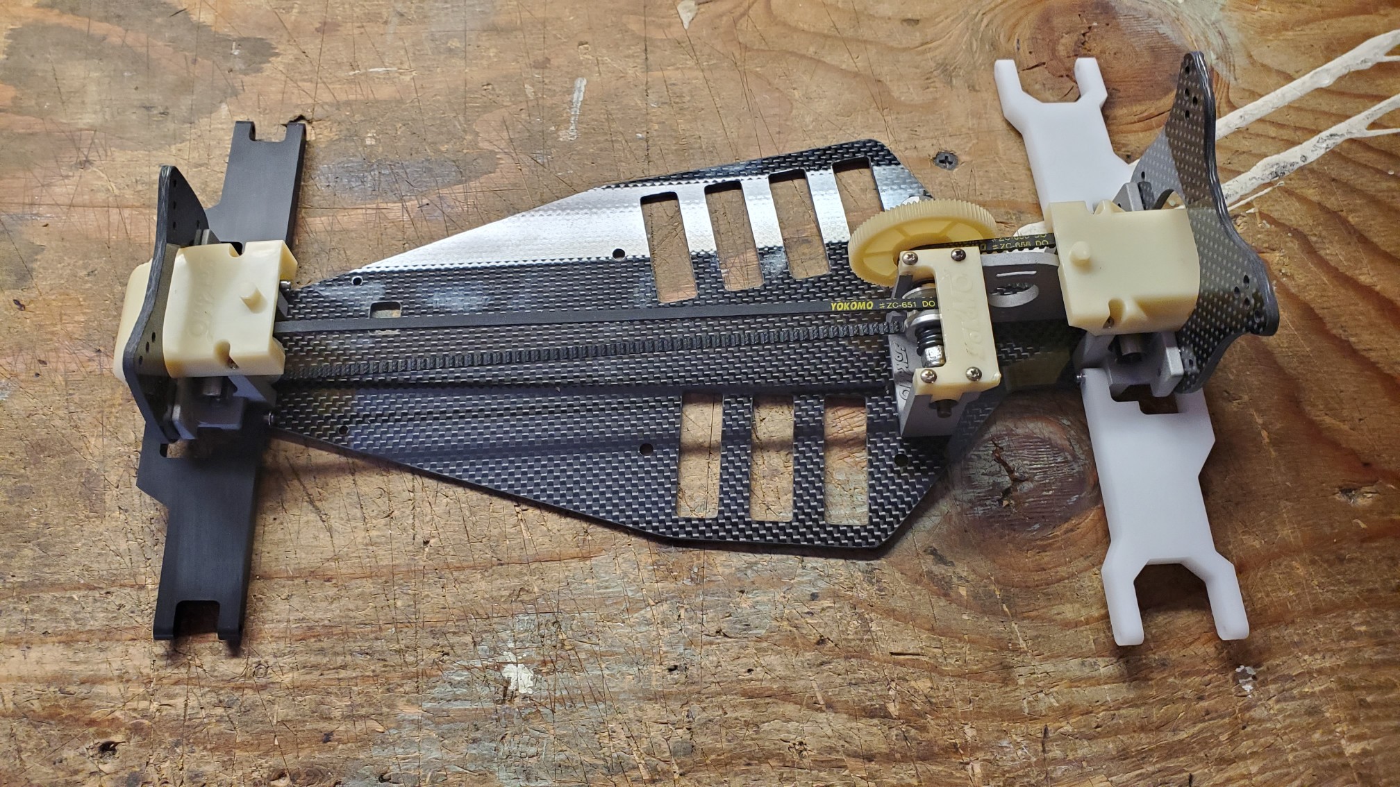

mikea96
Posts: 3599
Re: 870c project
Post by mikea96 »
They are aftermarket but the same exact dimensions as the rears.

Got the back setup correctly. Lot of material had to be removed from inside the hub.

I think I need the zc423 universals for the front. These are the zc422 universals.
mikea96
Posts: 3599
Re: 870c project
Post by mikea96 »
After looking at some other photos I think I just need to flip my wheel adapters around on the front and these universals will work.
mikea96
Posts: 3599
Re: 870c project
Post by mikea96 »
Nevemind the universal is still too short. Has anybody used the yokomo zc405 front long suspension arm kit? What am I missing here?
mikea96
Posts: 3599
Re: 870c project
Post by mikea96 »
After more checking I didn't realize that the stock 870c front arms had two outer holes on the arms. It looks like the wide front suspension kit is for using the outer hole on the stock front arms not for using the rear arms on the front.
