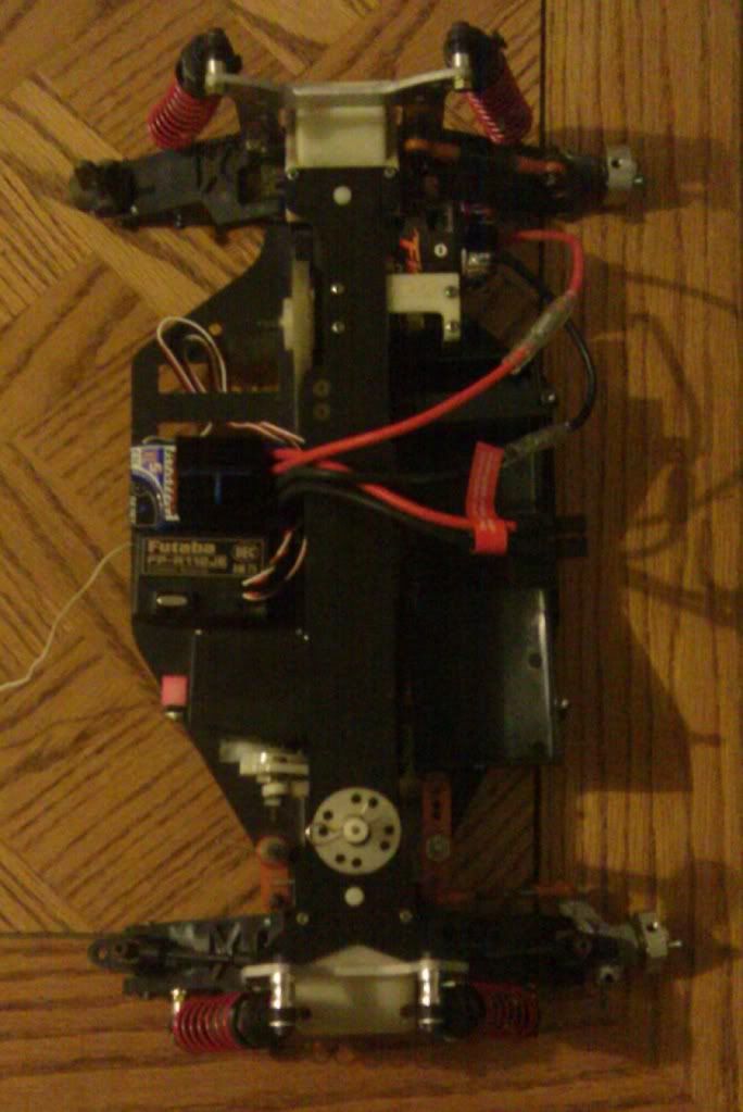

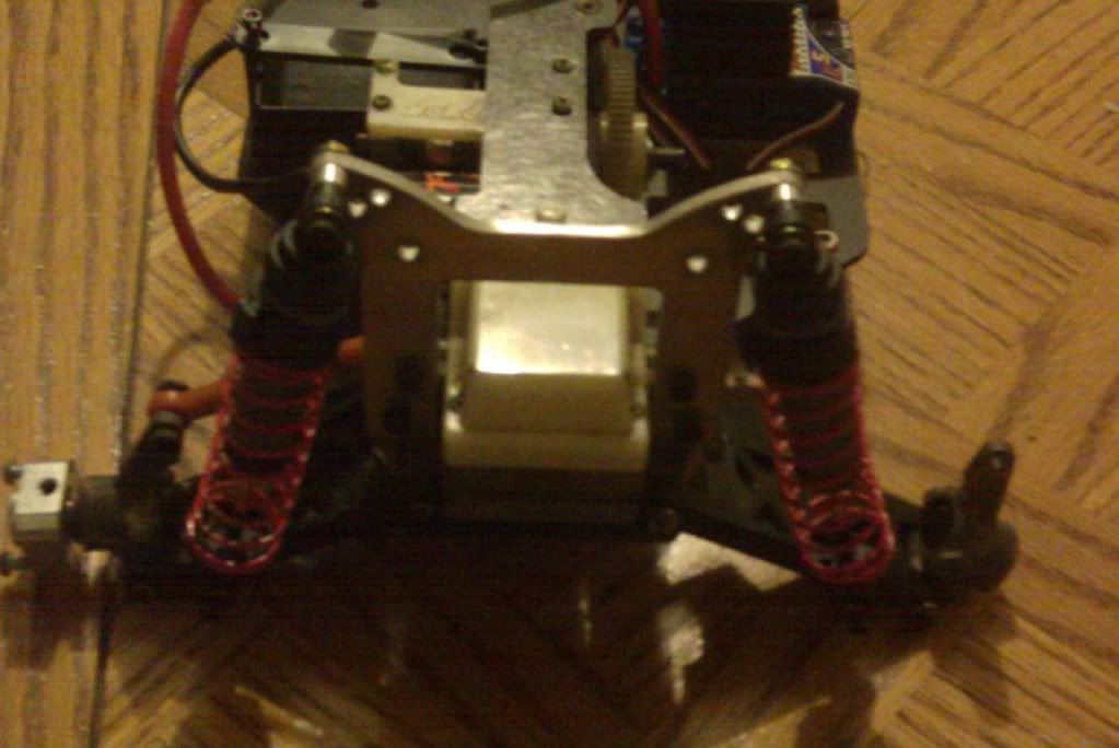

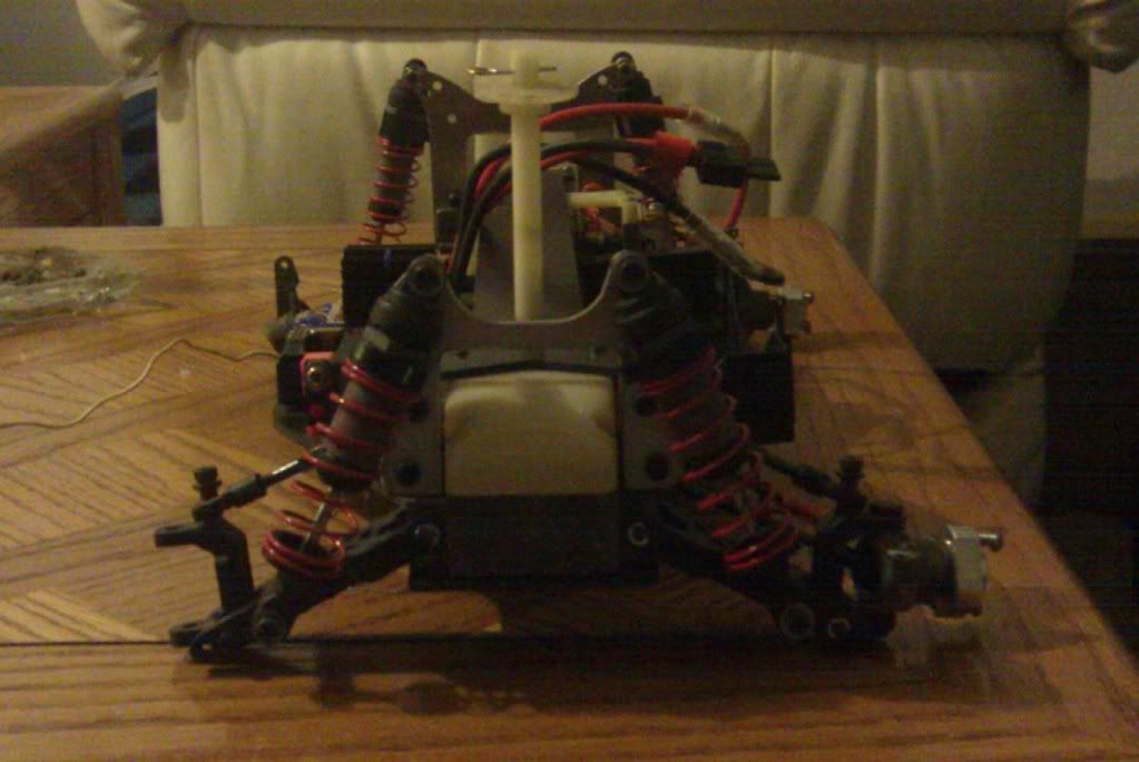

back tower
front
from the top
They are crappy pics. As I get it cleaned up, I'll put up more. I have stuff coming in this week, and will try and get some done this weekend. The post on the front is from a truck cap that was put on it.

I'm not exactly sure what shocks those are, but they look a little long. If possible, you may want to put spacers inside to limit the travel...or have some longer shock towers made. With those angles, you may wind up bending your universals....which are getting very hard to find.
You did a great job on those shock towers.

Good call. I have the springs set pretty tense, I'll reset them. A bit down the road I'll probably try to find the proper shocks. And yes, one of the differentials bent, I just thought it was because my son hit the buggy with his truck. I do have diffs on the way though...highwayracer wrote:I'm not exactly sure what shocks those are, but they look a little long. If possible, you may want to put spacers inside to limit the travel...or have some longer shock towers made. With those angles, you may wind up bending your universals....which are getting very hard to find.

it's not so much of how tense you set your springs but more of the actual length of the shock shaft. if you put some spacers inside the shock on the shaft, you can limit how far the shaft could slide out.
