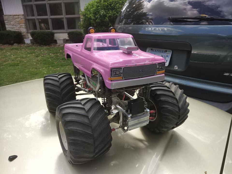

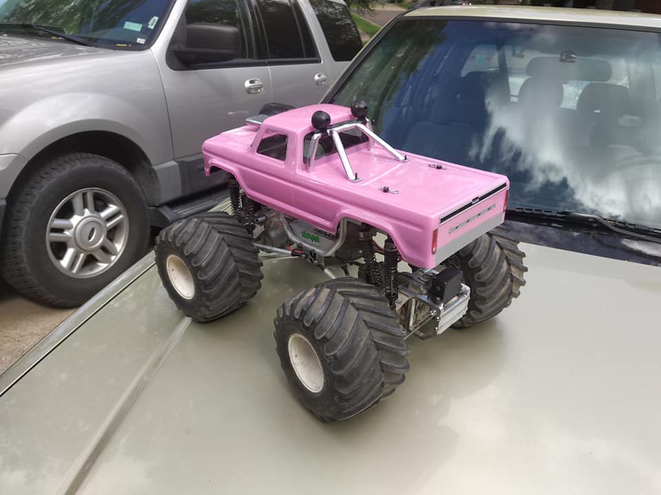

matt1ptkn wrote: Mon Apr 27, 2020 7:25 am www.clodtalk.com has loads of discussion topics about motors and electronics. The simplest, and cheapest, option is to run the stock silver can motors with an ESC that's capable of handling a 3s lipo, and run a 3s. That extra 3.7V makes a huge difference, and those motors will last a good while even on 11.1V. That body looks great (but you need to turn the tires around :wink: ).
thanks . lol yea it came with the wheels like that have not had to take them off yet (will have to remove them to install the servos will fix them then)

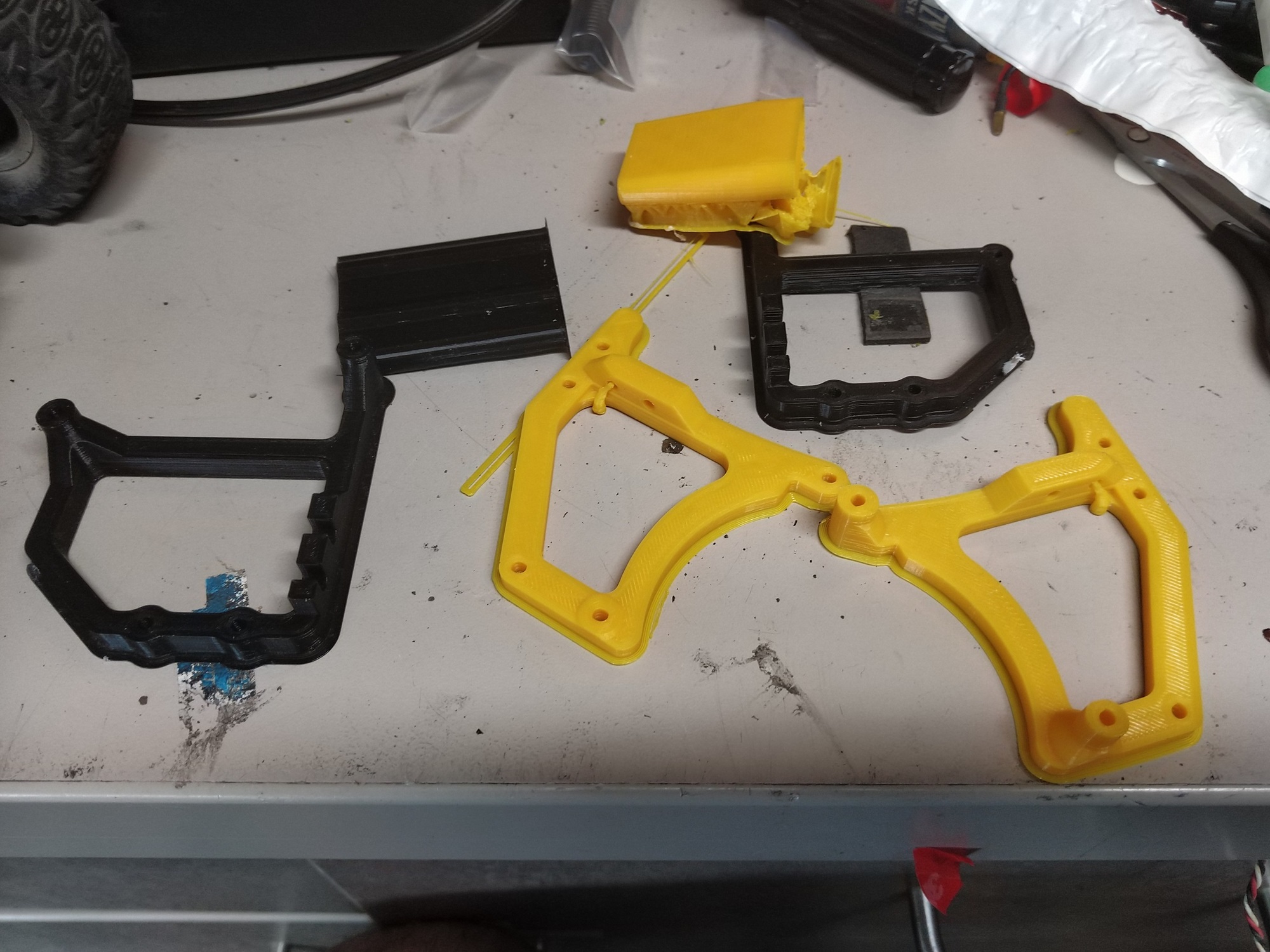

printed out some proper servo mounts last night and the scoop (still trying to find a printable bumper) .sucks the previous owner cut the mounting tabs off the servos and zip tied them in place . so im going to have to replace the servos

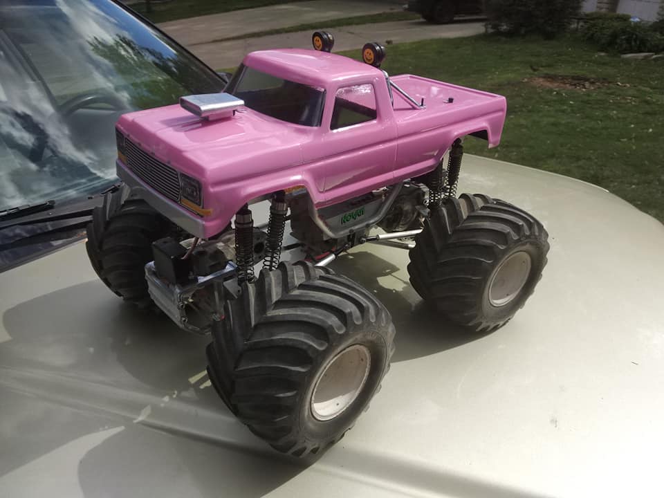

Getting there. new servo mounts painted and installed, hood scoop installed. printing a interior now.
