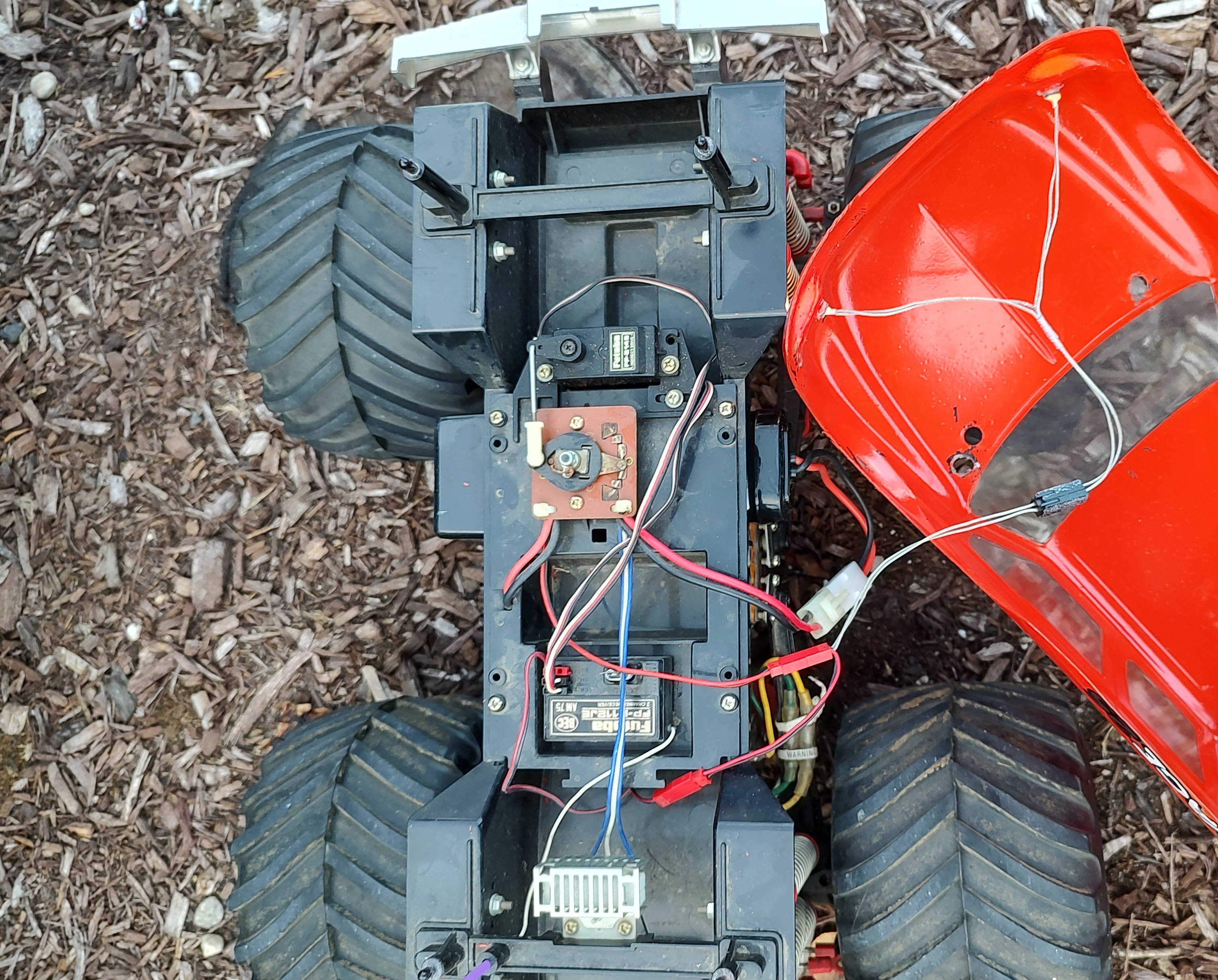

Md567 wrote: Wed Jan 08, 2025 7:27 pm Hello all!!!!! I love this website! So I haven't used my clod in a while, so when I plug in a battery pack she takes off......and I can't control it with the remote..please help thank you!
Can you take the body off the truck and take some pictures?

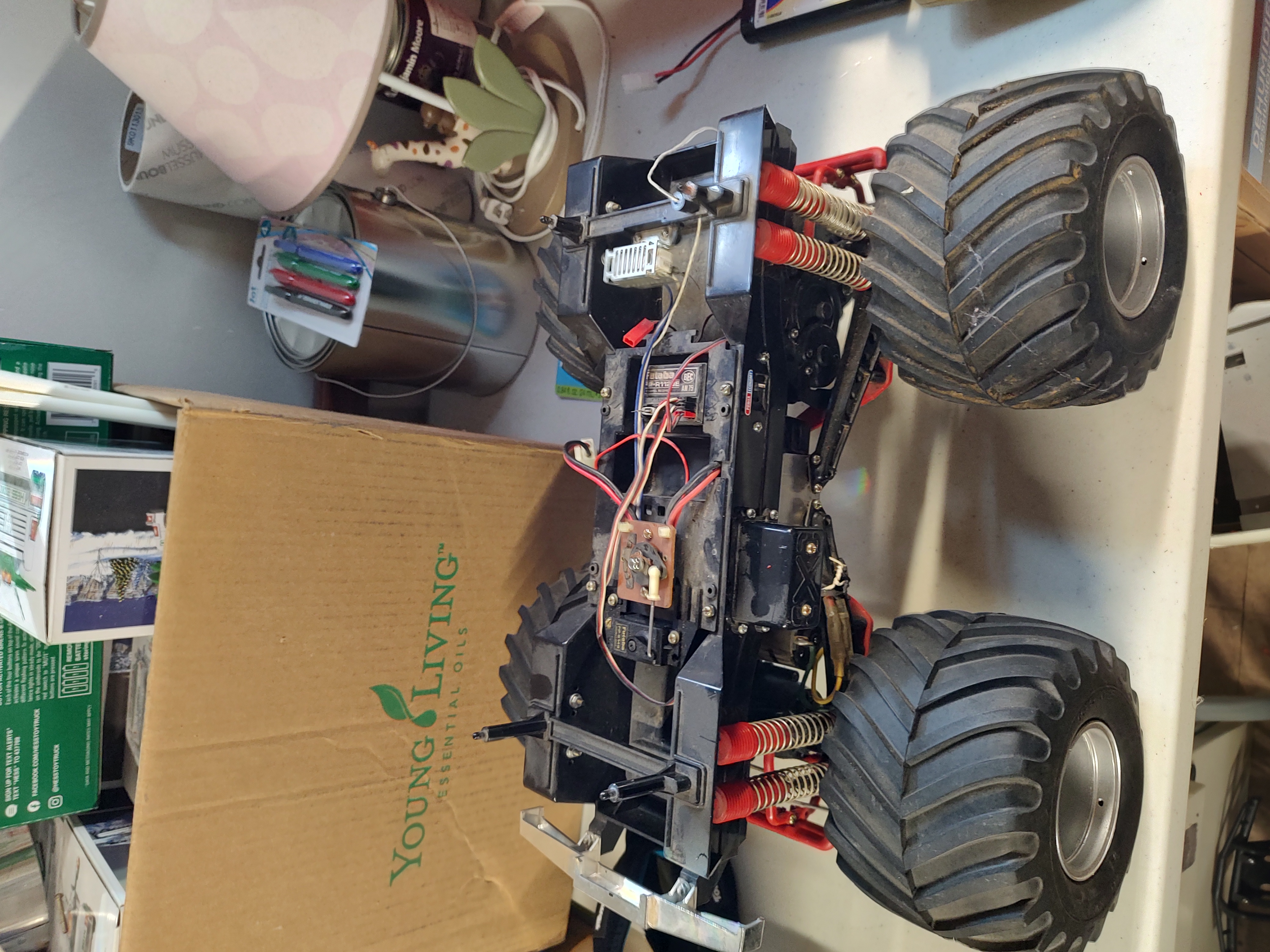

Here is the view from top/side....there is no onboard battery box, and yes the remote and truck are on when I plug in the battery.
morrisey0
Posts: 1802
Location: Richmond, VA
Has thanked: 87 times
Been thanked: 1852 times
Re: Clodbuster
Post by morrisey0 »
The MSC servo is a little out of adjustment, causing the MSC to be in drive when it should be in neutral. You can try moving the servo horn to the next tooth on the servo gear, or adjusting it on the radio.
The MSC arm should be perpendicular to the length of the truck when it is in neutral.
Md567
Posts: 8
Joined: Wed Jan 08, 2025 12:23 pm
Re: Clodbuster
Post by Md567 »
Yes!!! That did it thank you! The trim also on the remote I think is backwards too...runs great now!!
Posts: 3808
Has thanked: 2604 times
Been thanked: 2977 times
Re: Clodbuster
The receiver also looks like it has had a 4 cell AA battery pack previously connected to it. The value in that is being able to control the servos even when the main battery gets low.
Brendan2904
Posts: 563
Location: New York
Has thanked: 268 times
Been thanked: 258 times
Re: Clodbuster
Post by Brendan2904 »
Frankentruck wrote: Thu Jan 09, 2025 12:08 pm The receiver also looks like it has had a 4 cell AA battery pack previously connected to it. The value in that is being able to control the servos even when the main battery gets low.
Could be but it looks like a BEC switch setup instead. I think the OP needs to try both ways. I have set mine up both ways but I really prefer the battery box for reliability.

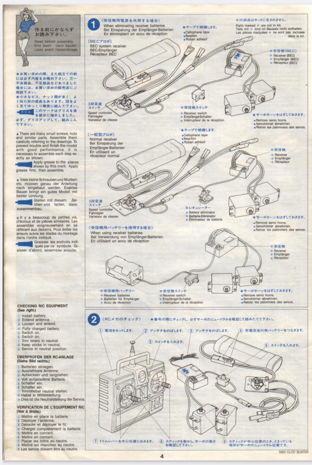

Posts: 3535
Been thanked: 2094 times
Re: Clodbuster
From the original manual. It is just power directly from the main battery, for use with a BEC receiver.
Click on image for better resolution.

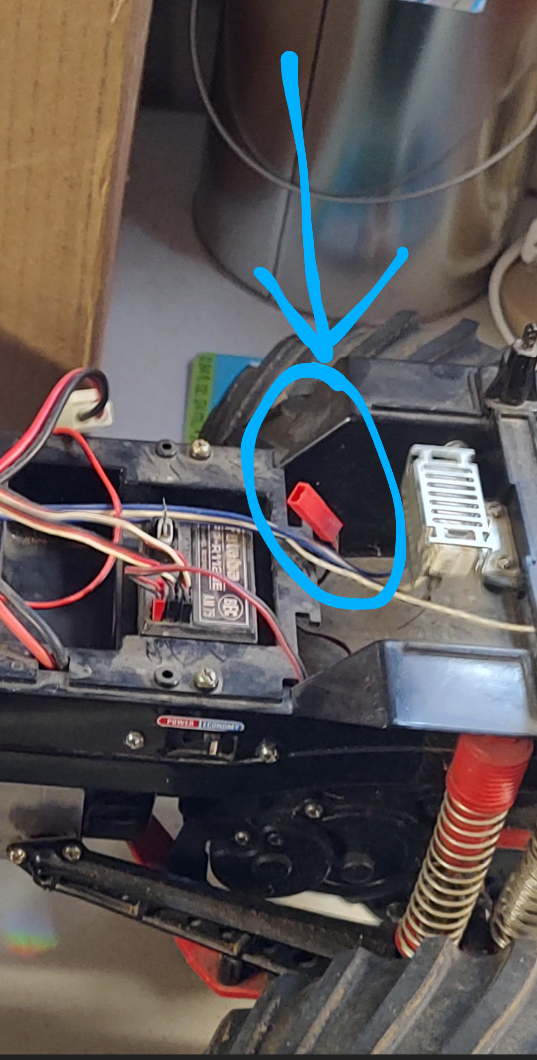

Md567
Posts: 8
Re: Clodbuster
Post by Md567 »
That's where the headlight plug went in...I disconnected it from the the body to repaint
