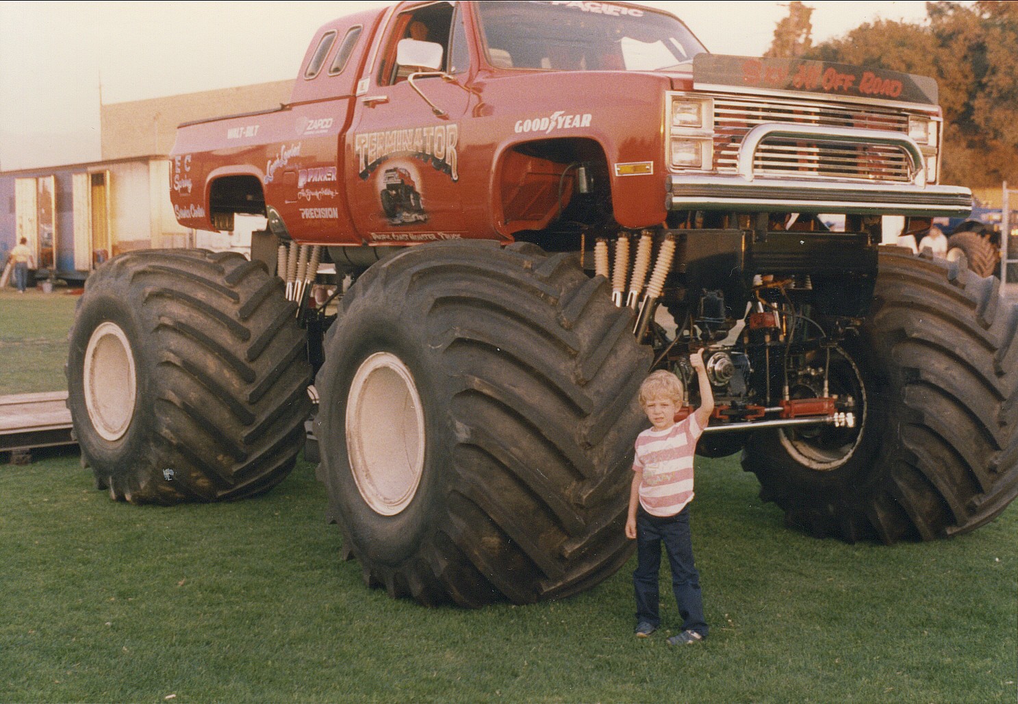

Re: Clodbuster advice?
Not quite the original Samson but very close, has more "Bruiser" attributes.
When trucks were trucks !
