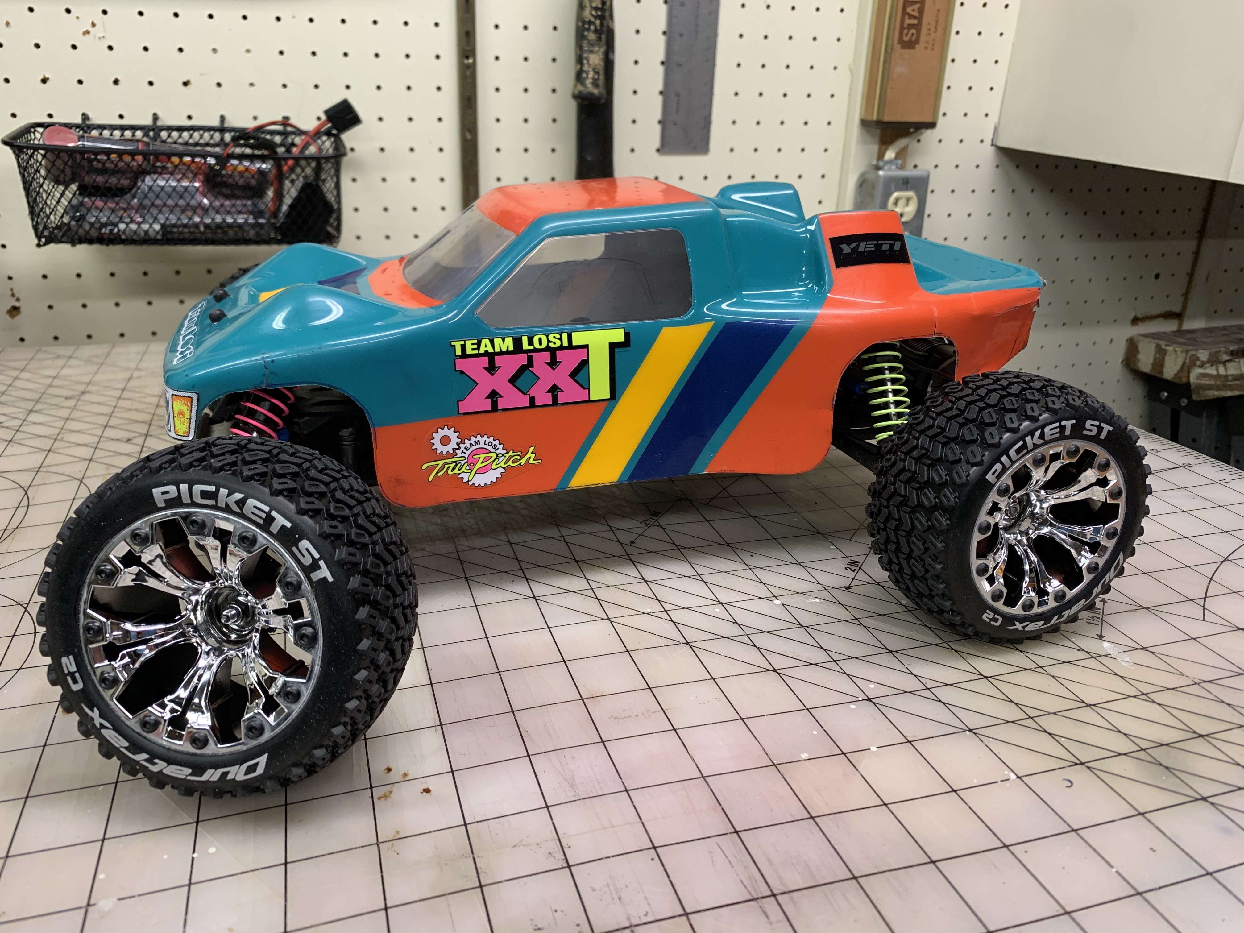

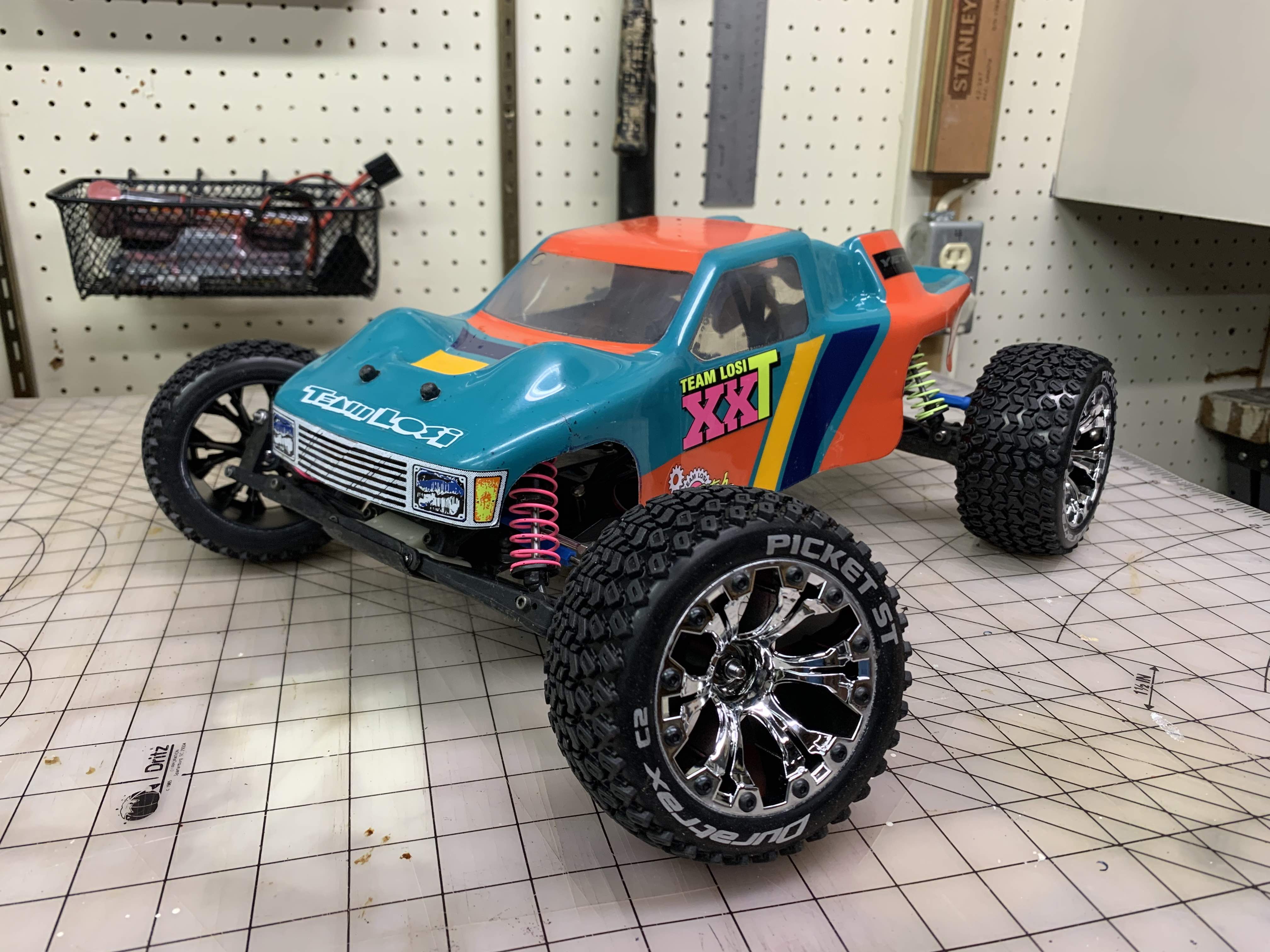

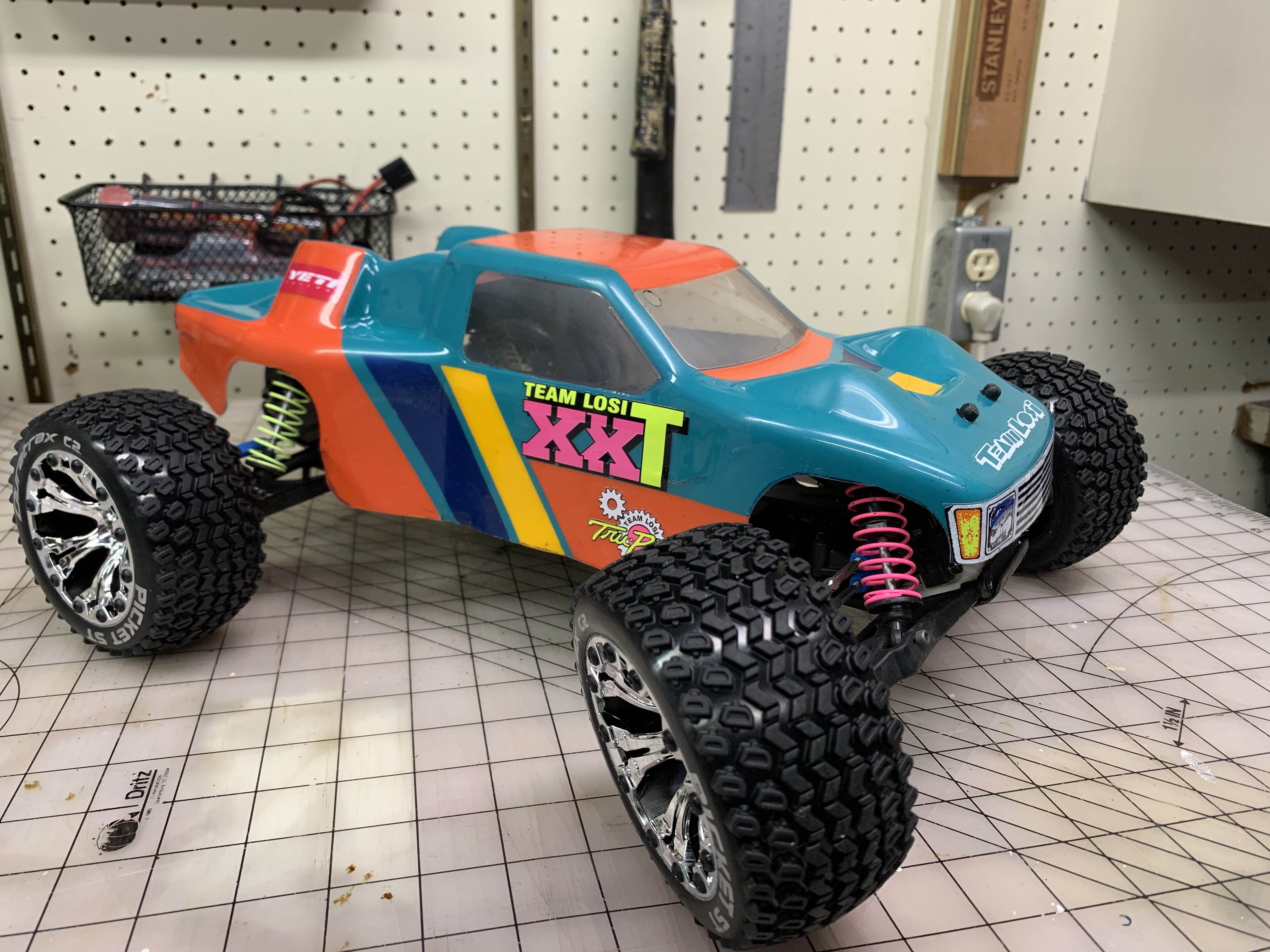

Re: Another quarantine inspired XXT
Put some new wheels on the truck and some original stickers on the body.
