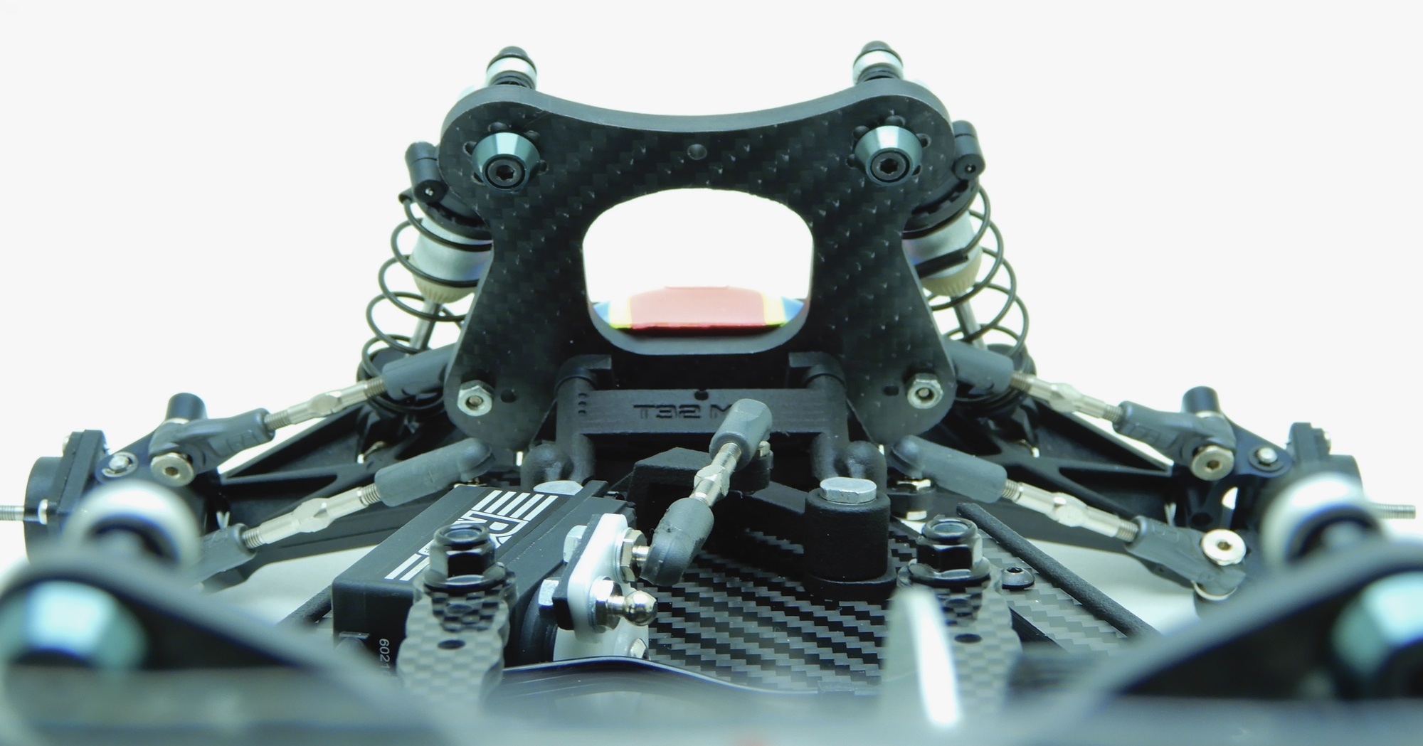

Re: DSPPC EXP3 MID kit Cougar
Today the last parts arrived for the front end.
Just put it all together, and “technically” the slider is finished.
Here some detailed photo’s again!
Enjoy!!
Enjoy!!
The wheels.....
Right, the wheels are mounted!
Did some other slight mods, especially the steering was off. Found the problem, ánd the solution.. haha.
If you notice, the front shock tower is currently changed. The one we designed was 7mm too low. So for now we fitted a Fibre-lyte C2W one, which ultimately is a tiny bit too high on this model imo, and too narrow on the top for the track conditions we have.
We will create a new one later on...
Next up... finishing the body...

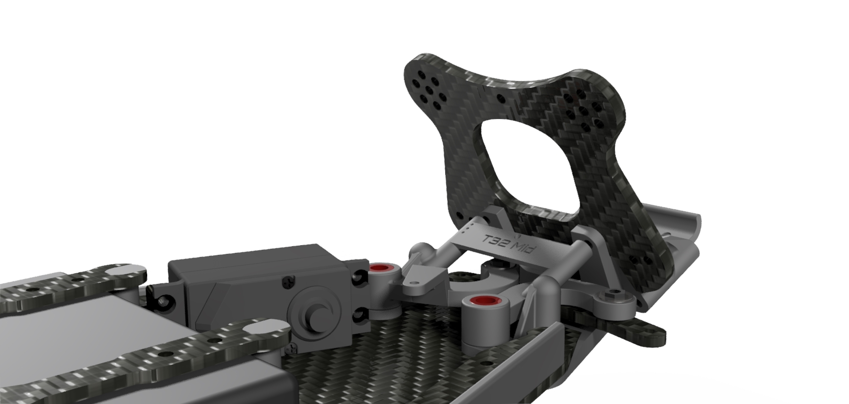

- Marshky
- Posts: 57
- Joined: Mon May 27, 2019 3:38 pm
- Location: The Netherlands
- Been thanked: 13 times
For those that are interested in rendered pictures of the CAD files, here are some. Only the chassis has been modeled, as the original suspension components would be maintained. Some of the original parts have been measured and recreated in CAD, so the interference with other parts could be checked and accounted for.
CAD software that is used, is Inventor. Enjoy!
