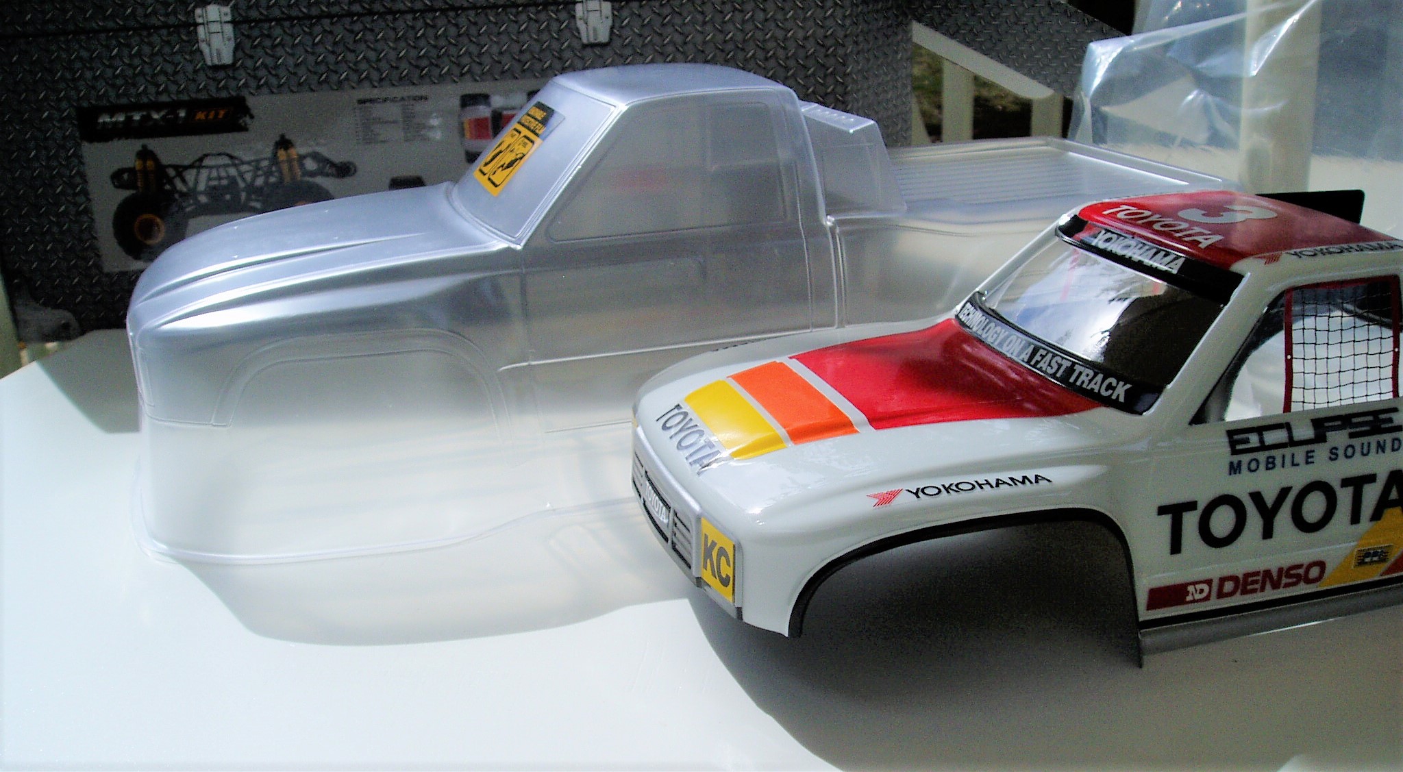

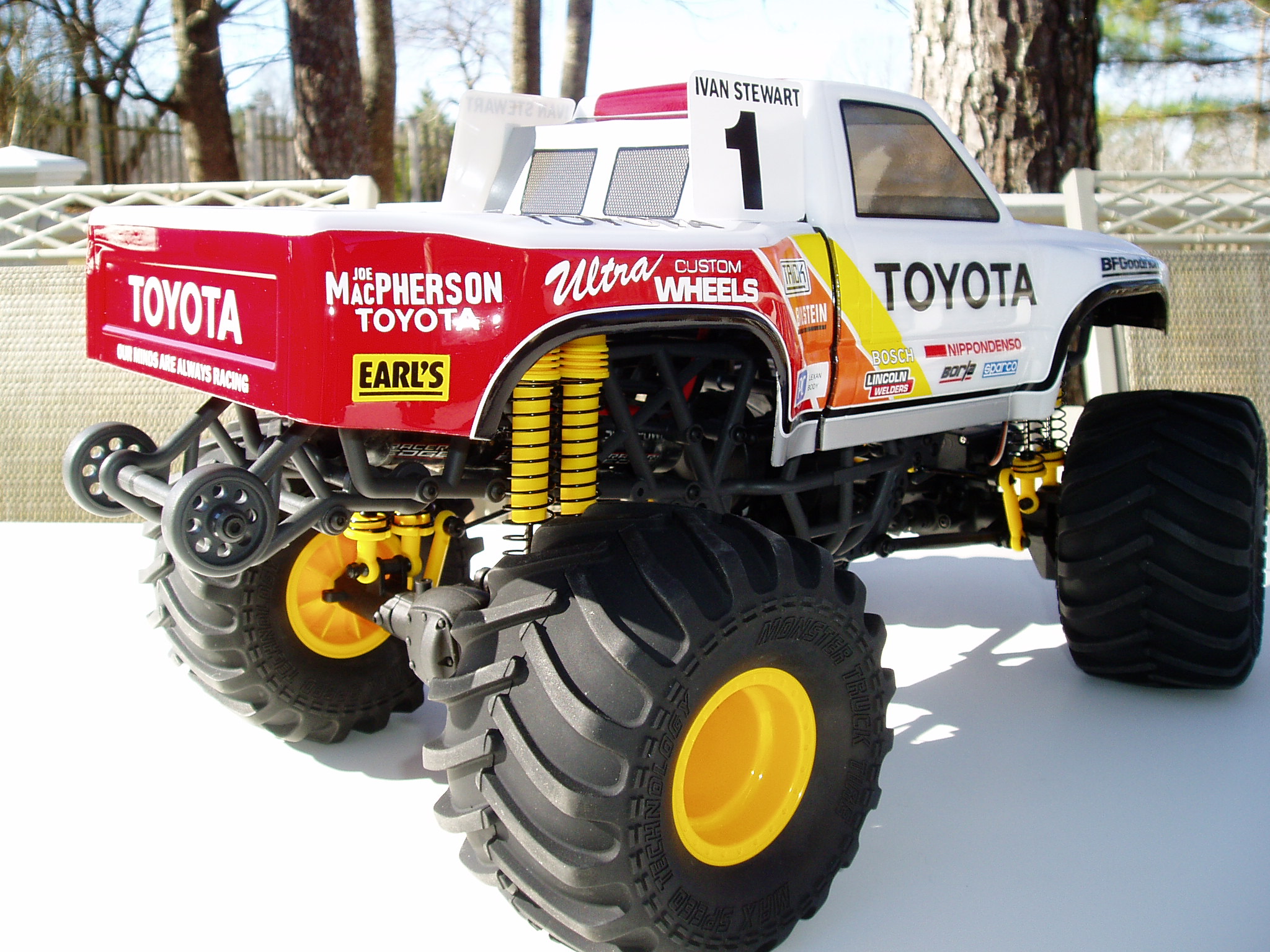

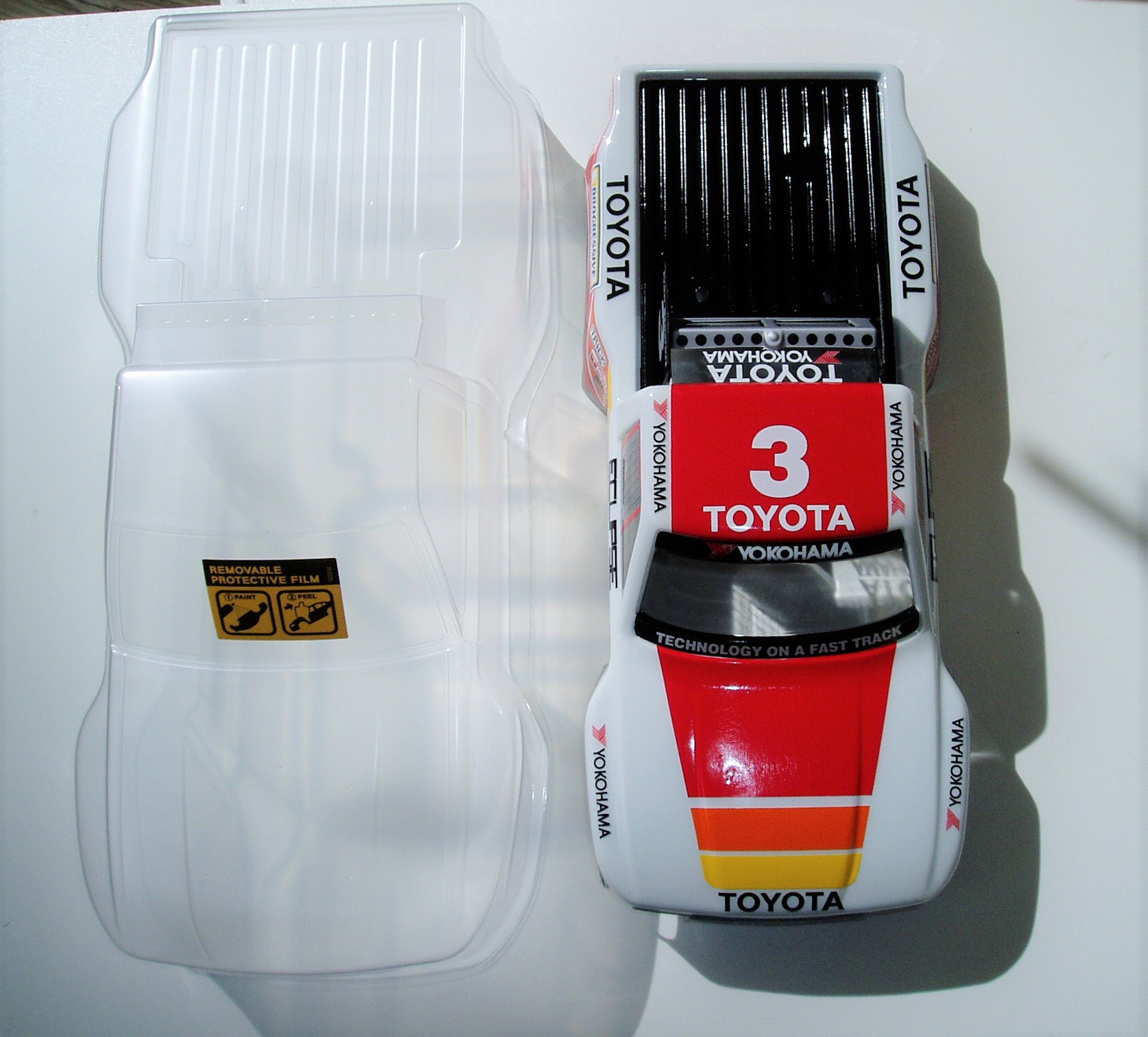

MST’s Toyota body is a bit larger than Tamiya’s – perfect! The design and proportions are identical to the Tamiya body.
Here are the body dimensions:
MST: 17-¼” x 8” x 4-15/16”
Tamiya (TBG): 16-1/16” x 6-9/16” x 4-5/16”
I first tried to order just the body set, but they’re out of stock everywhere so I went ahead and got the complete MTX-1 kit. Again, I didn’t set out to build a monster truck but I can use this body for a more scale accurate 2wd chassis more in keeping with the off-road racer theme.
Build photos are next…

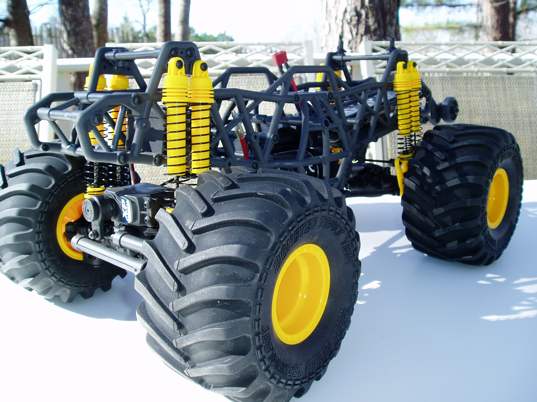

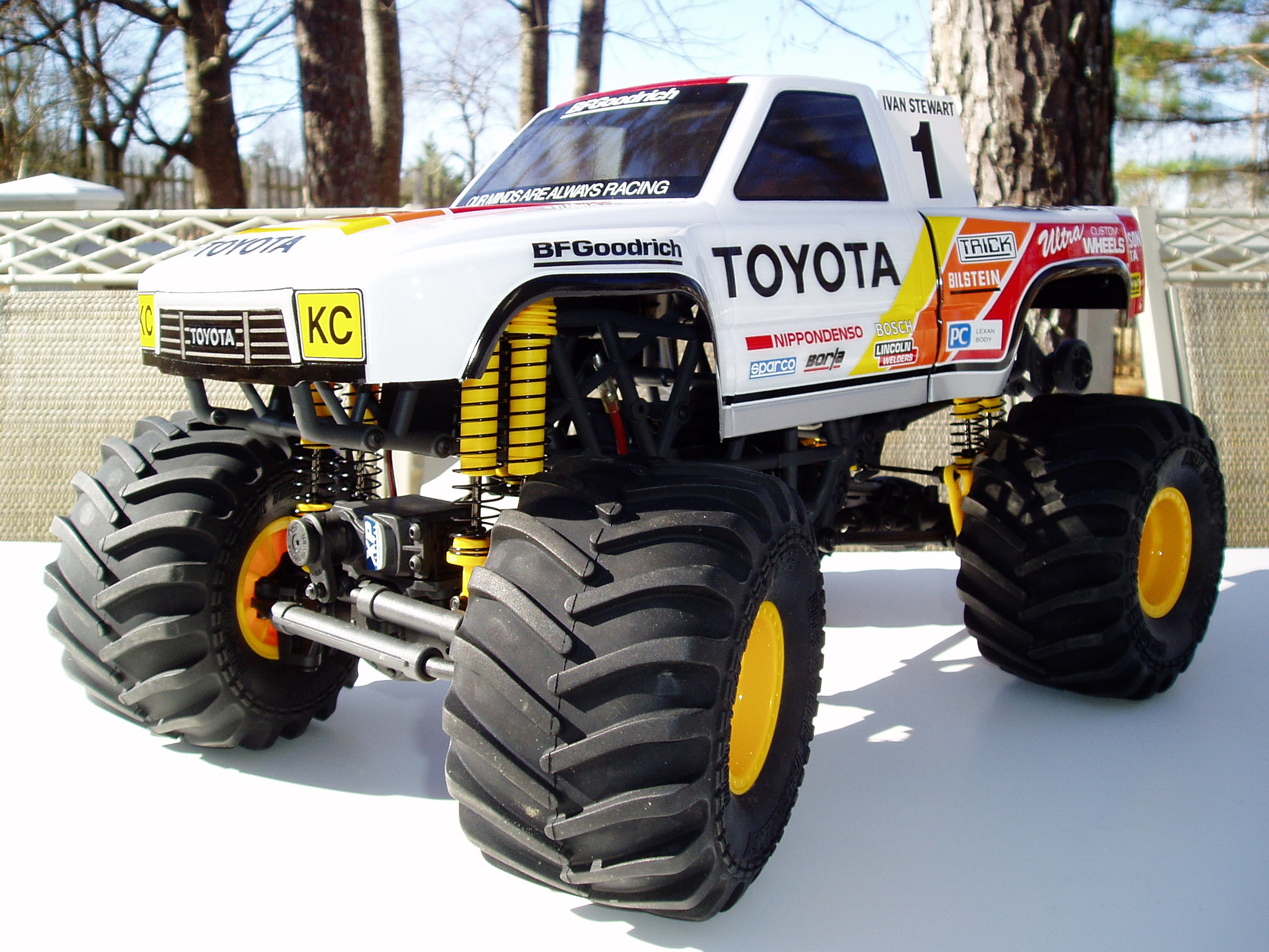

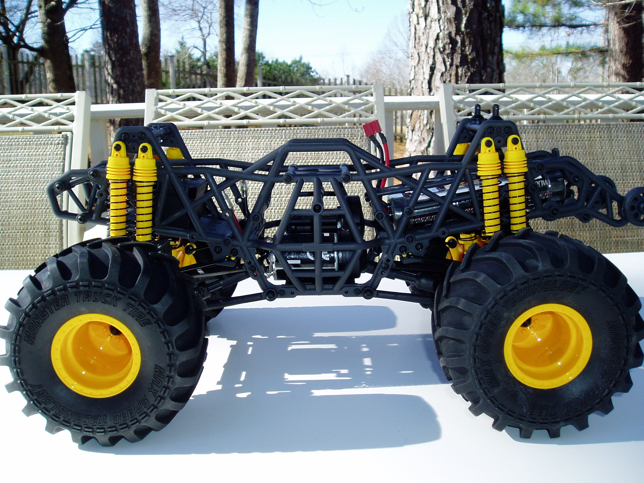

When you get into the build, it’s actually quite impressive. Everything is well organized and the quality of the parts is outstanding. In fact, having built a fair number of kits lately from a variety of different manufacturers, I’d still rank Kyosho number one for parts quality, fit, finish, etc. but I’d place this kit from MST a close second. It really is that good. The plastics feel right and are molded super accurately. The axle gears and other metal parts are also made to a very high standard. The only real design flaw I found was with the position of the motor screws – access to one of the screws is blocked by the spur gear. Perhaps the suspension links are a bit thin as well. Another problem for me is that the gears are M0.6 so my 32dp and 48dp pinions won’t fit the spur.
I’m also not a fan of the yellow shocks but their nylon material should accept dye. The wheelie bar assembly is removable.

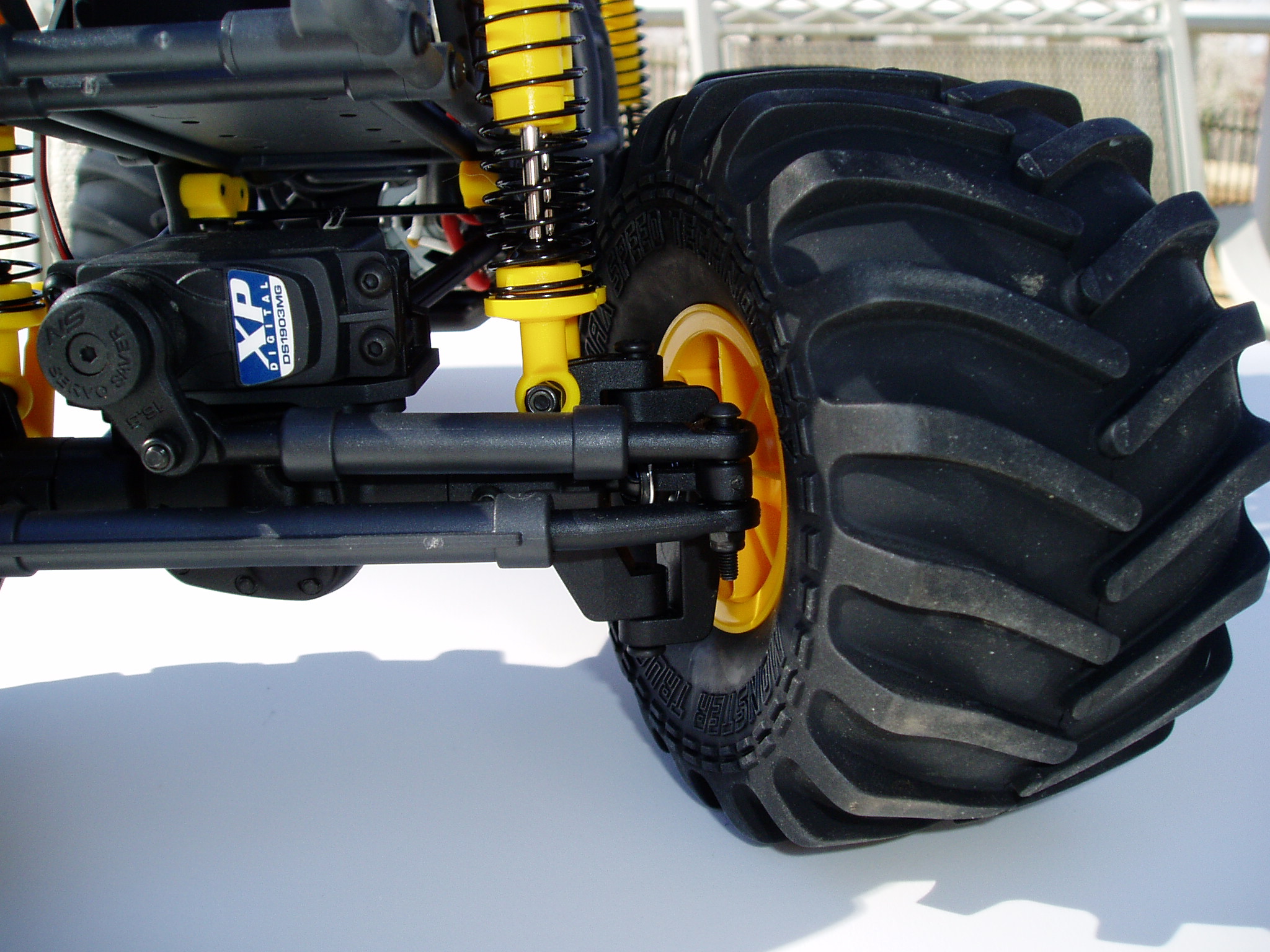

Notice how the C-hub hinge points are stacked so that neither pivot screw is in tension. I’ve never seen this before but it should make for a very strong front axle.

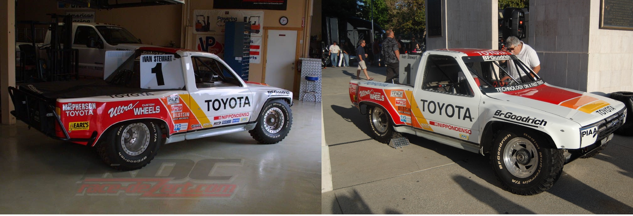

Here’s the exact livery I was going for...
… and this is what is supplied with the kit:

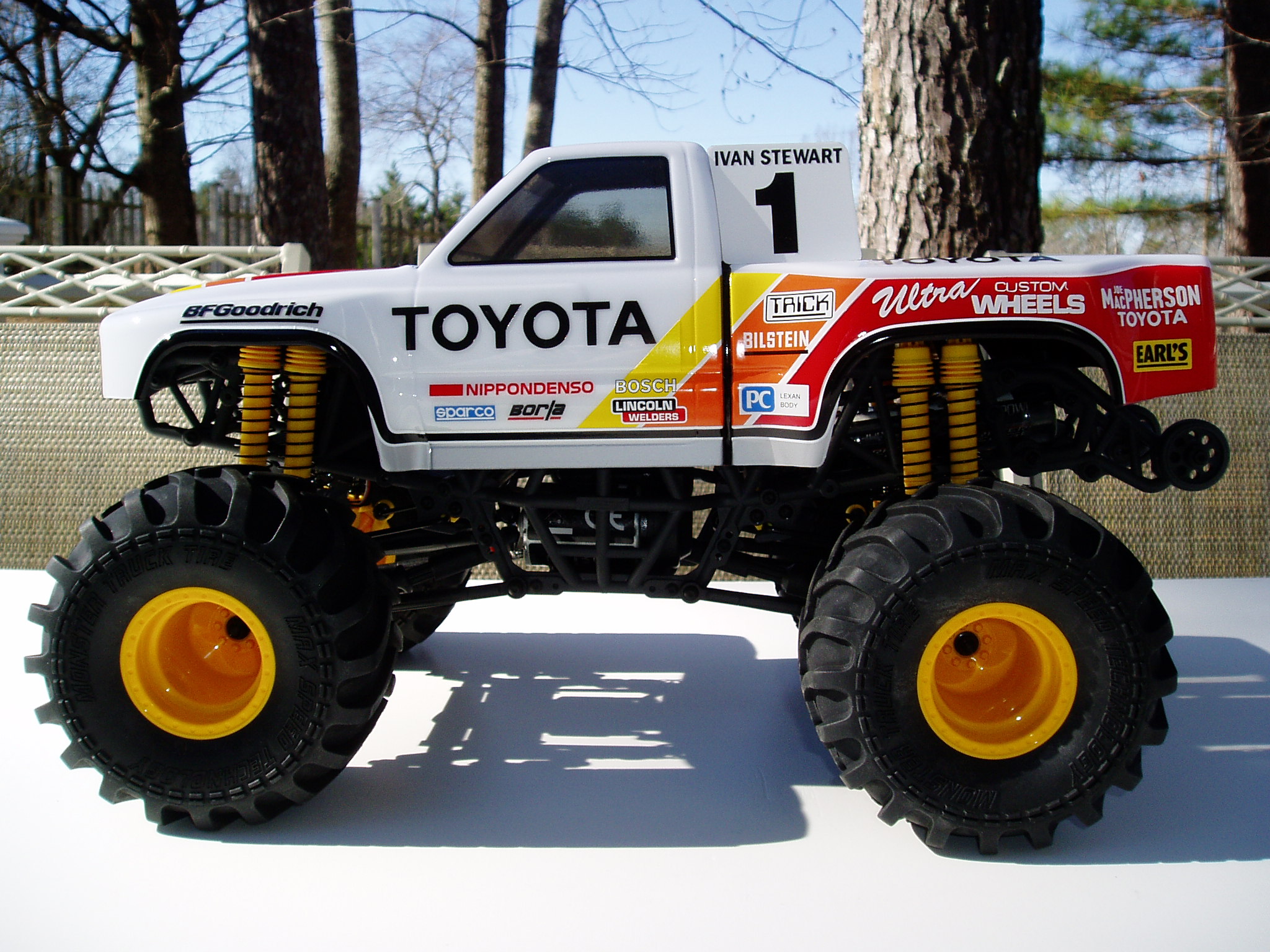

This is an unlicensed body so I’ve replaced the TH-1 and rc-mst.com stickers, making the Toyota, Ultra Custom Wheels and Joe MacPherson logos using a vinyl cutter. This meant that the red on the rear fenders and tail gate area had to be painted and the color match with the red stickers isn’t perfect.
Including the Joe MacPherson logos, there are a total of 10 Toyota logos on this truck. Obviously, Toyota wants everyone to remember who made it.
The goal here was to build an Ivan Stewart replica not a monster truck so, for the more scale accurate 2wd chassis, maybe I’ll re-lengthen that RC10 chassis and add suitable wheels and tires or I could build something from scratch.

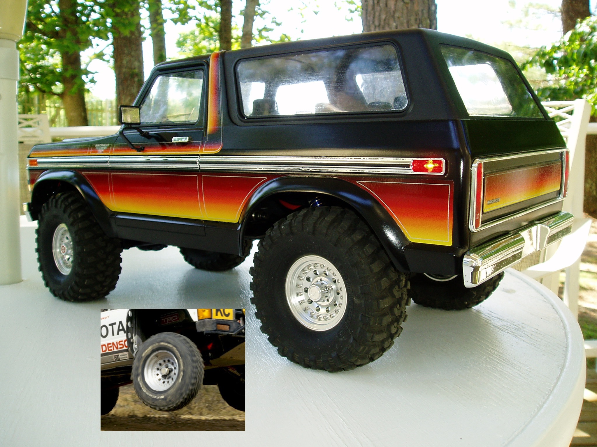

Actually, I think I’ve already found the correct wheels. I have these aluminum bead-locks on the Bronco and they look like a good match to the wheels on Ivan’s desert truck. They’re not terribly expensive so I’ll go ahead and order another set.
As for the MTX-1 chassis, I could paint-up a Ford pickup body to make a Big Foot model – I believe MCI has the decal set. I’ll probably want to change wheel color to white however.
Anyway, I’ll post photos of the finished Toyota with its little brother later. Meanwhile, here’s what I have so far.

A couple things to watch: the driveshafts are very loose and flop around and the suspension links are a bit small and perhaps could fail if the truck is pushed hard - especially in extremely cold temps. Both items are easily upgraded if necessary so I don't see them as obstacles.

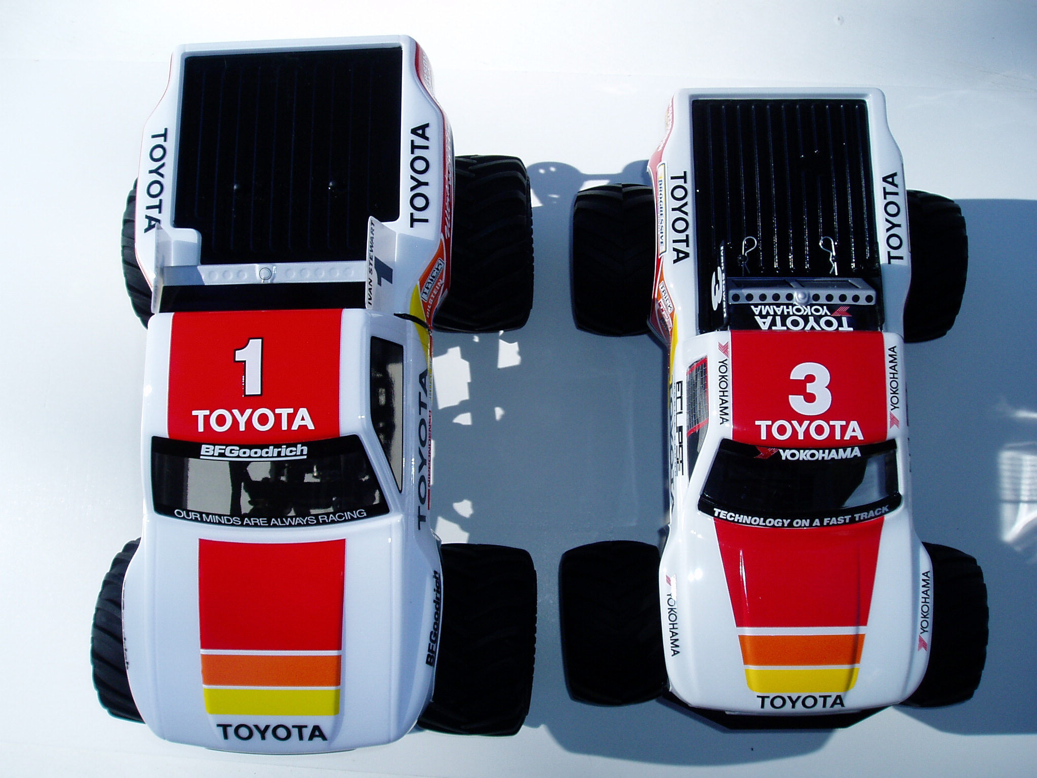

TBG lists length as 415mm and width 165mm so my measurements are a slightly off (408mm x 166.7mm).EvolutionRevolution wrote: ↑Wed Jan 05, 2022 3:57 pmI'm comparing this to the Prerunner (TA02 version) in my Tamiya catalogue, and the dimensions are off - the TBG version is smaller than what is listed in the catalogue (and I'm pretty sure the catalogue is correct). So it looks like TBG accidentally shrunk the body...or the TBG version is a copy of the Monster Racer version and that one is undersized.
It is a very small body, that's for certain - I was stunned when I first pulled it from the box. Apparently, it's not uncommon for TBG bodies to be undersize - this has been mentioned numerous times on this message board.
Your comment prompted some research. TBG lists Prerunner and Monster Racer as same bodies so I had assumed the Tamiya originals were also same. However, I just had a look at the manuals and Tamiya identifies Prerunner body as 1825113 and MR as 1825064 so they are not the same. Looking at the illustrations in the manuals, they appear identical.
Anyway, I have a chassis that will fit the TBG body and I think maybe it will look okay.

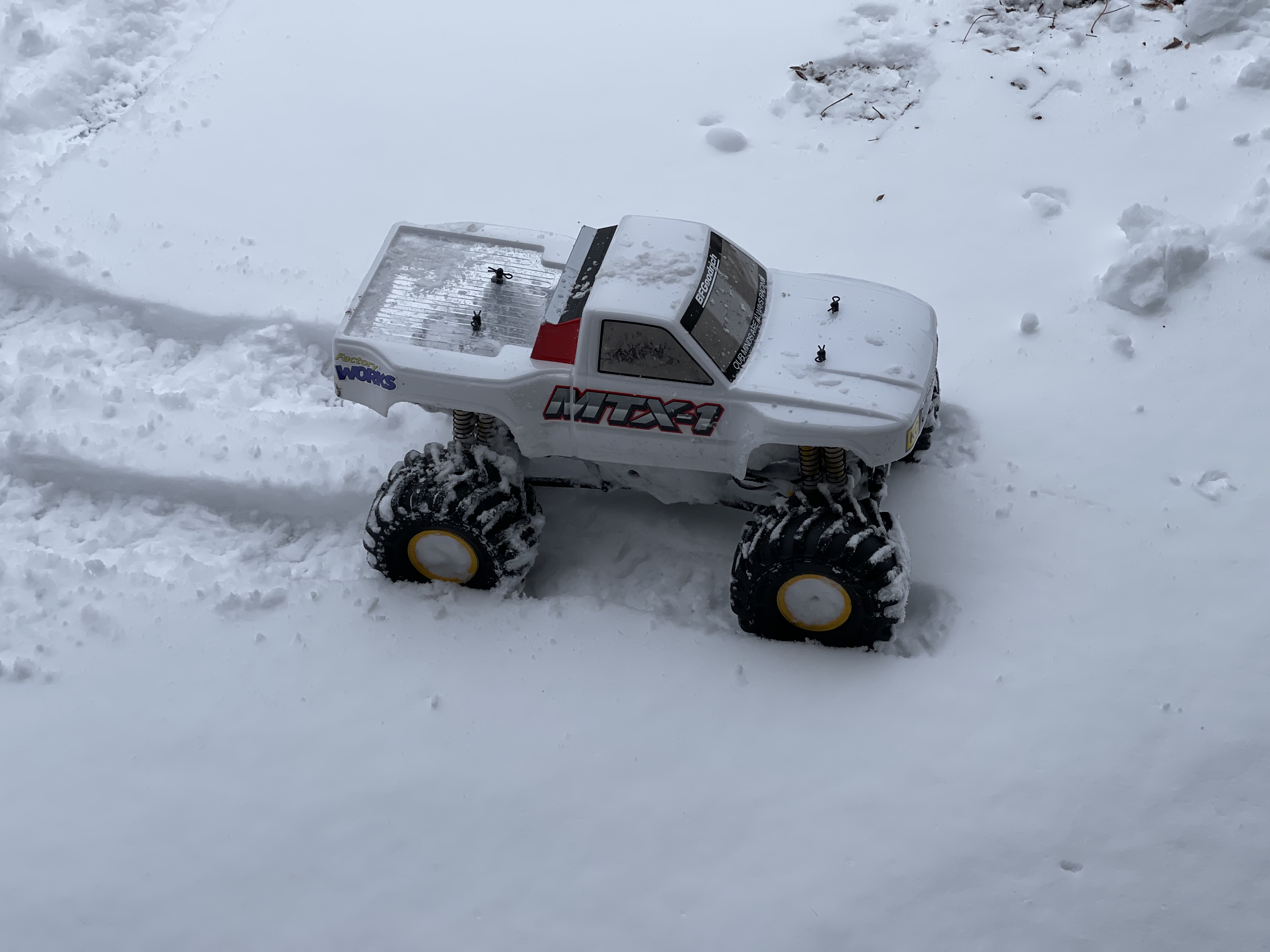

Well poo. Was playing in the snow- she is a wheelie monster. Lot of fun, lot of tumbles too. Unfortunately it’s front wheel drive now as it spat out the rear driveshaft and it’s nowhere to be found. So now we start to modify.
I’m fairly certain the HPI Flux 5900kv is a bit spicy for it, but hey it’s what I had laying around

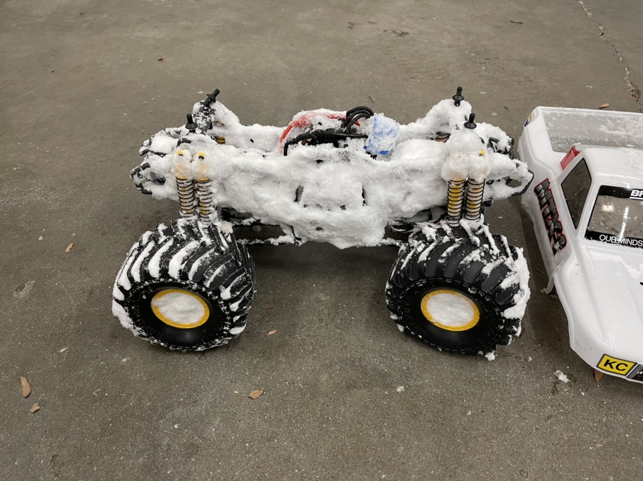

Got to play in the snow today, need to install a little more tame motor. Can’t keep the wheels down. Still, it was a blast. These IKEA boot trays for $4 work well for defrosting

What did you find to replace that broken drive shaft?
- Posts: 12336
- Has thanked: 1129 times
- Been thanked: 3917 times
Re: Ivan Stewart Toyota replica
I robbed a joint from one of my traxxas rigs. Held up great on the snow but I have a feeling I’m going to need to upgrade if I keep running a hot motor
