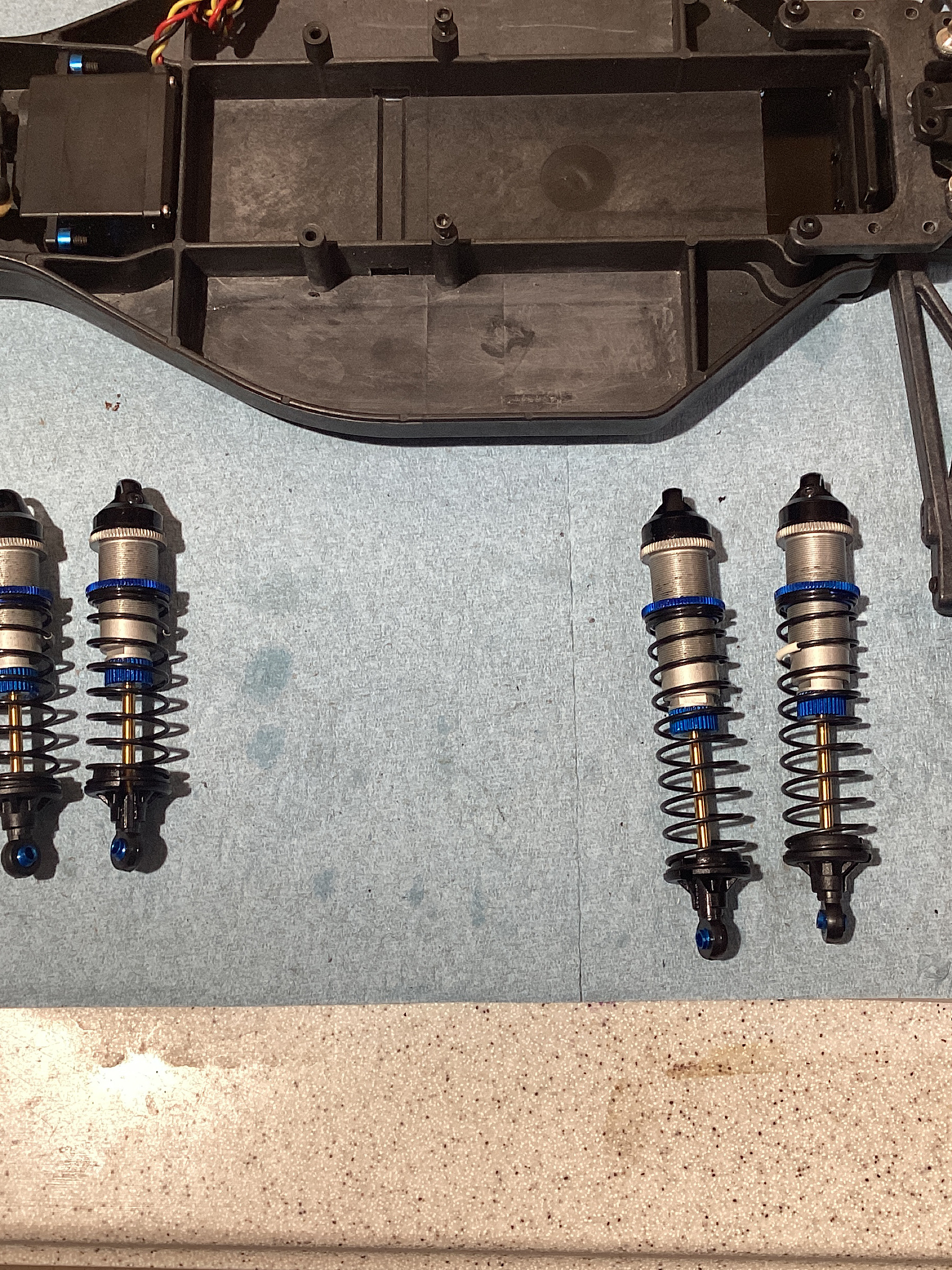

These came. Think these will look good on the truck. Are these considered v2 shocks? Are the rebuild kits/ seals the same?
Posts: 3539
Has thanked: 269 times
Been thanked: 2094 times
Re: T4 shock question
The big bores are still V2 design. The smaller o rings are the same but the ones on the cap are bigger.
