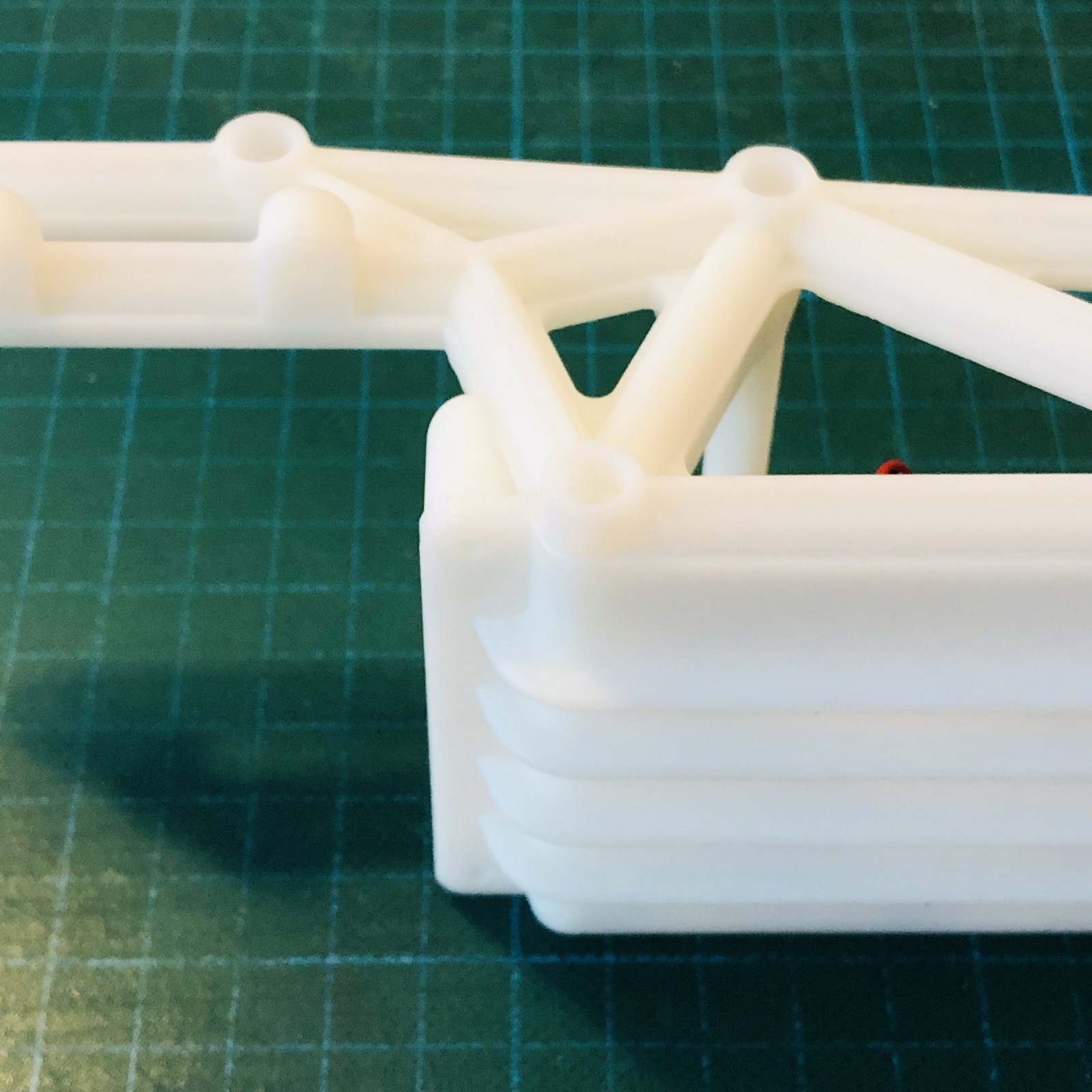

Re: Spaceframe Chassis for Hotshot
I also modeled the Hotshot2 Underguard and had to modify a bit my Bottomplate design to allow the HS2 underguard to fit perfectly.
I also modified my Bottomplate design from 5 ribs to 4 ribs to keep a continuous (visual) flow between the parts.

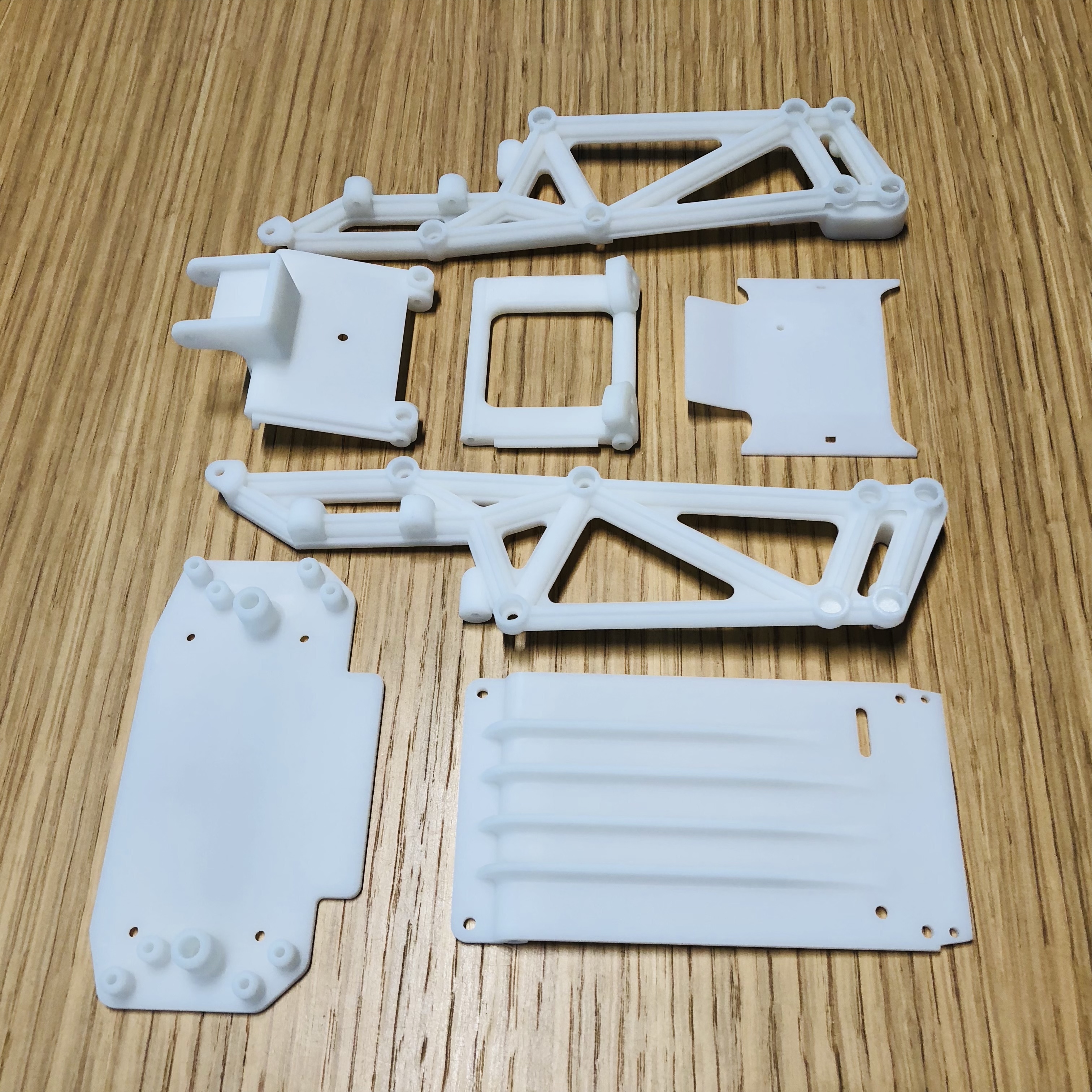

And here are the parts I printed.
Here the parts are white because they're printed in SLA resin. The final product will be MJF PA12 black dyed nylon for the best shock resistance.

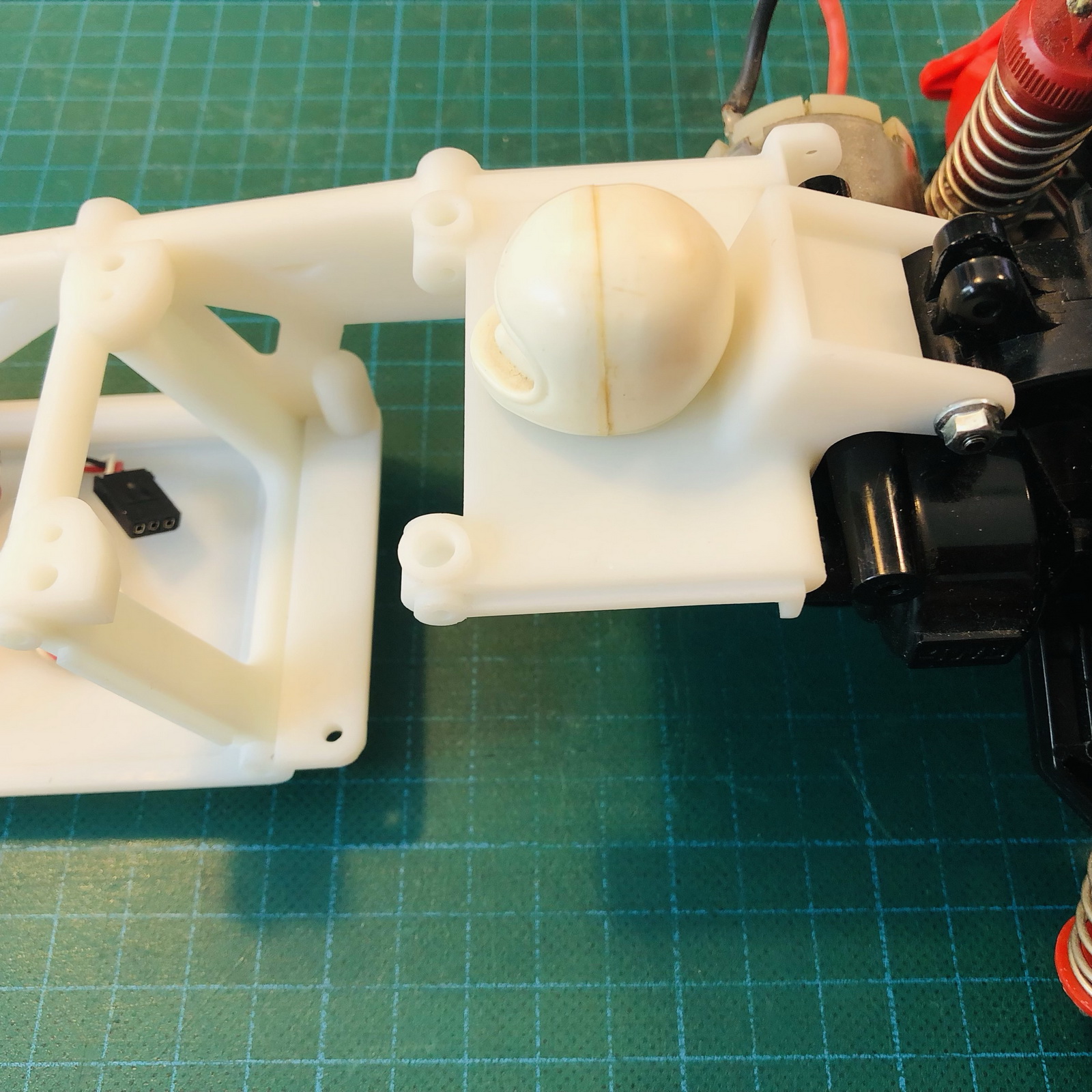

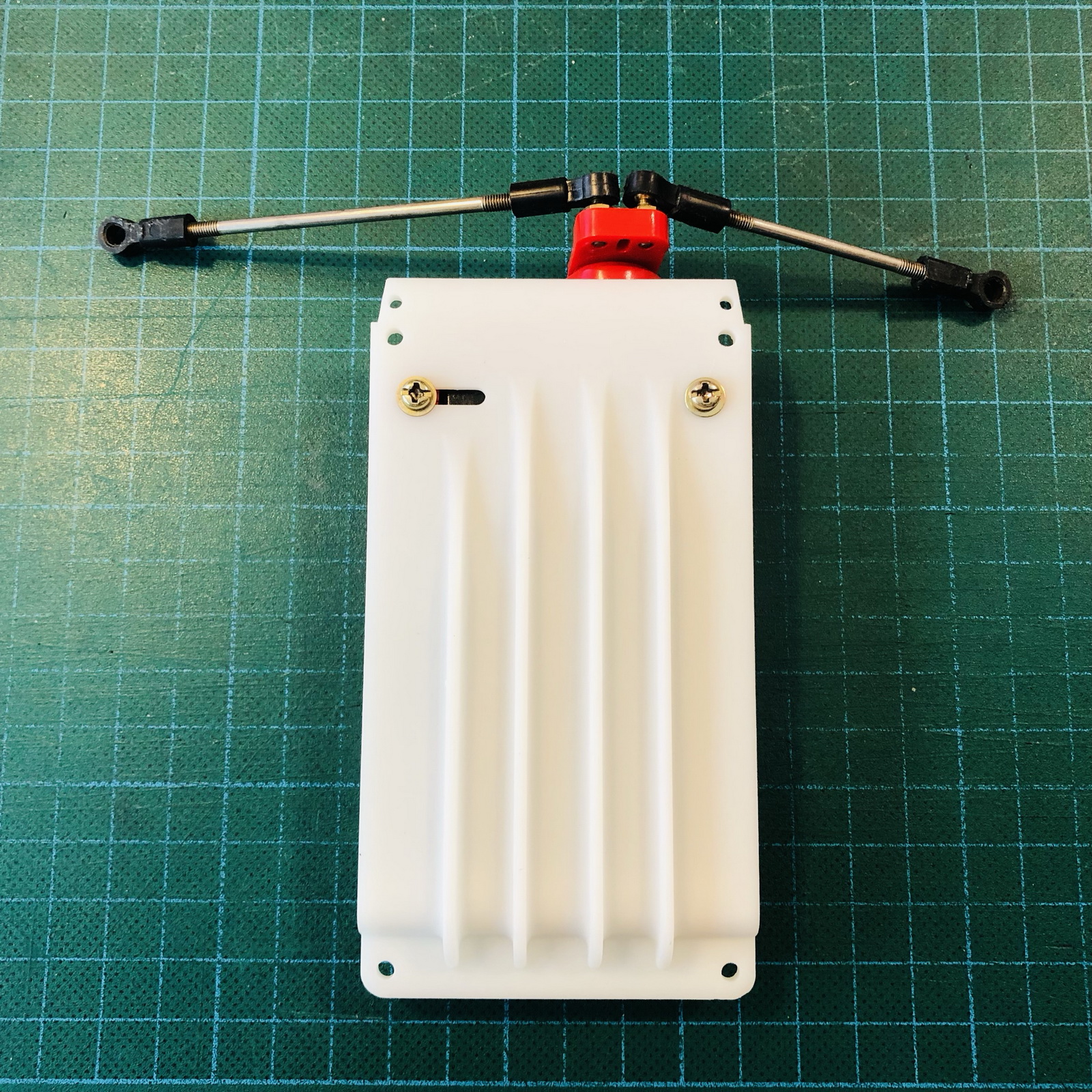

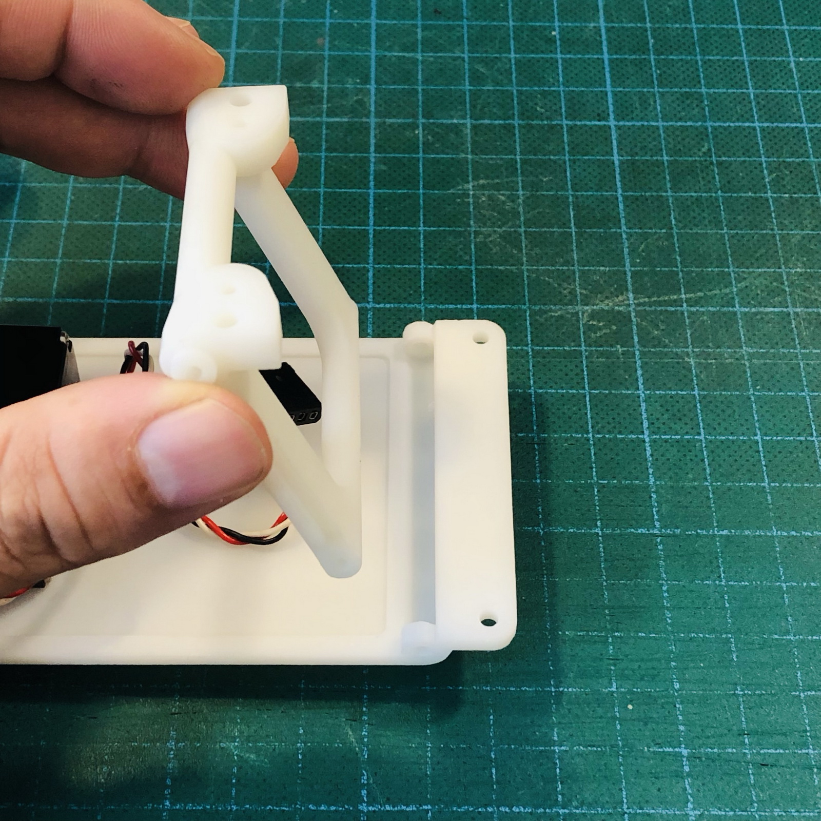

Let's begin the building process...
I start by attaching the Steering servo on the Bottomplate

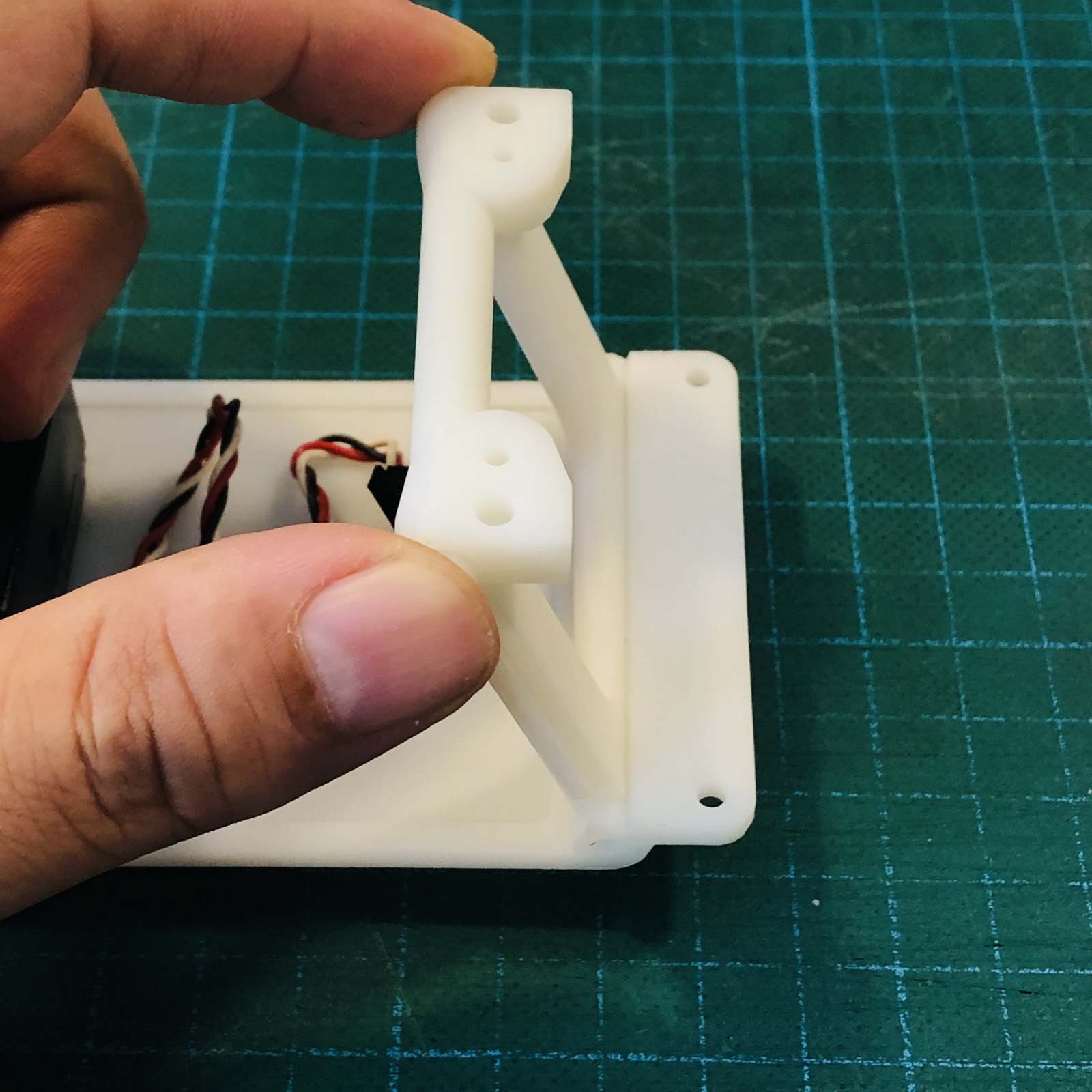

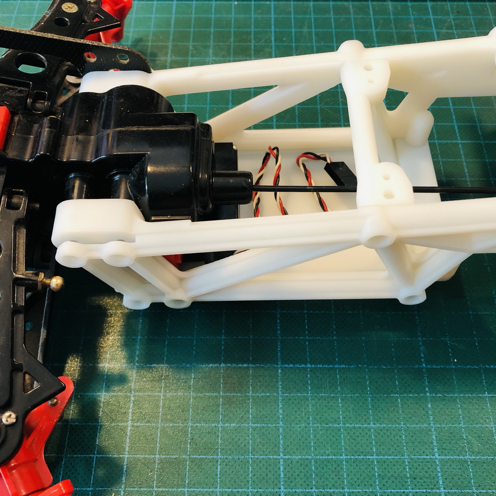

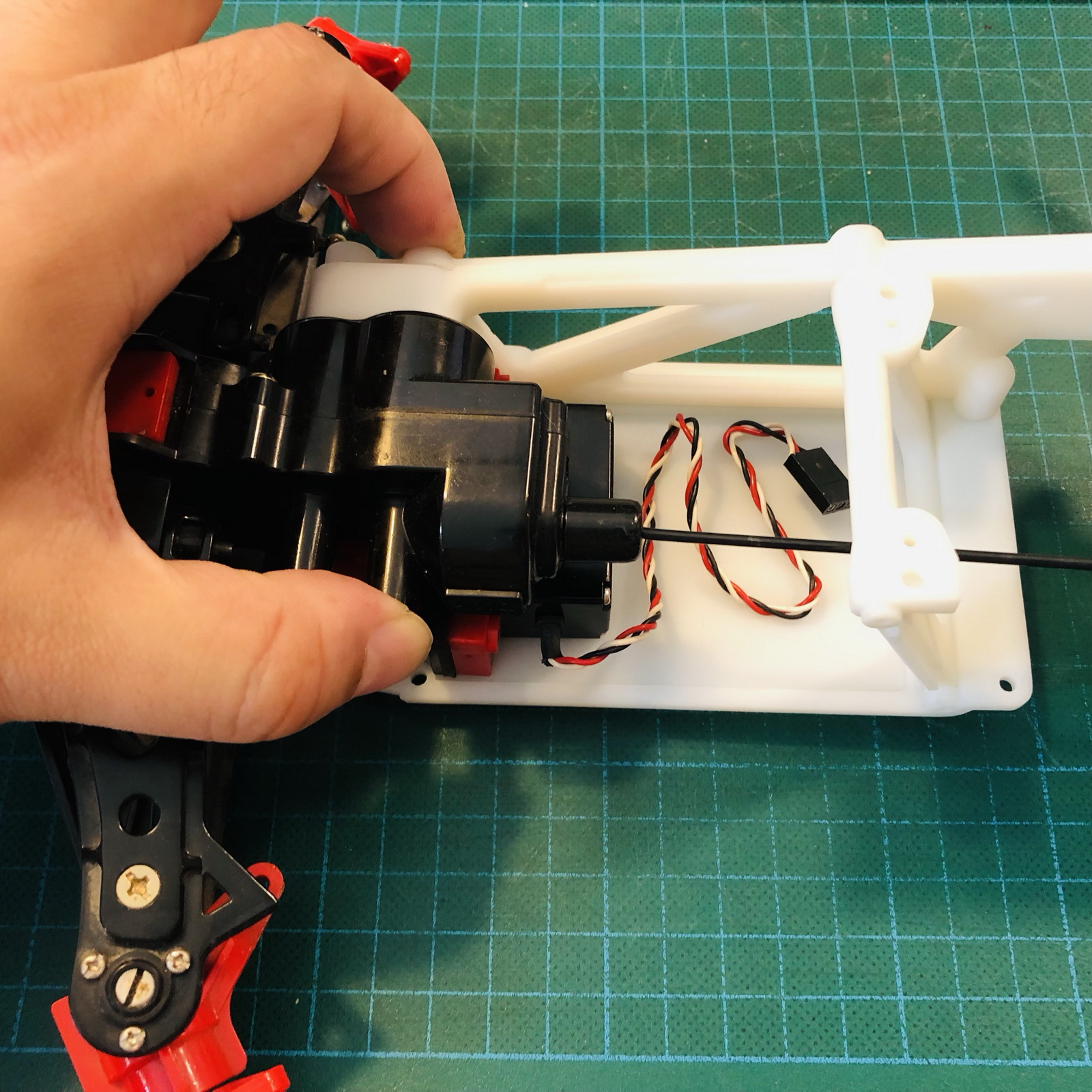

We must align the bottom and upper holes between the frame (R), the Bottomplate and Centerframe

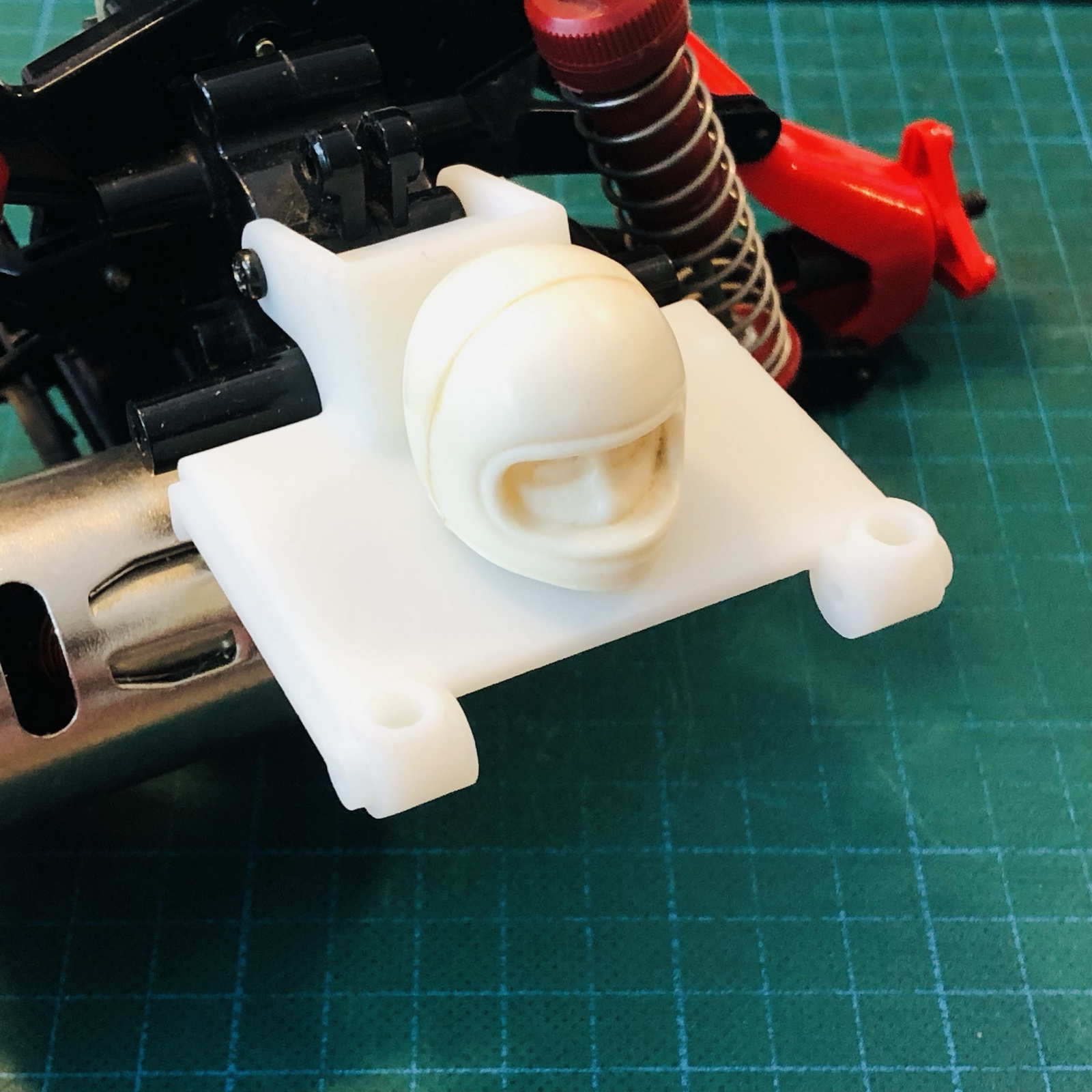

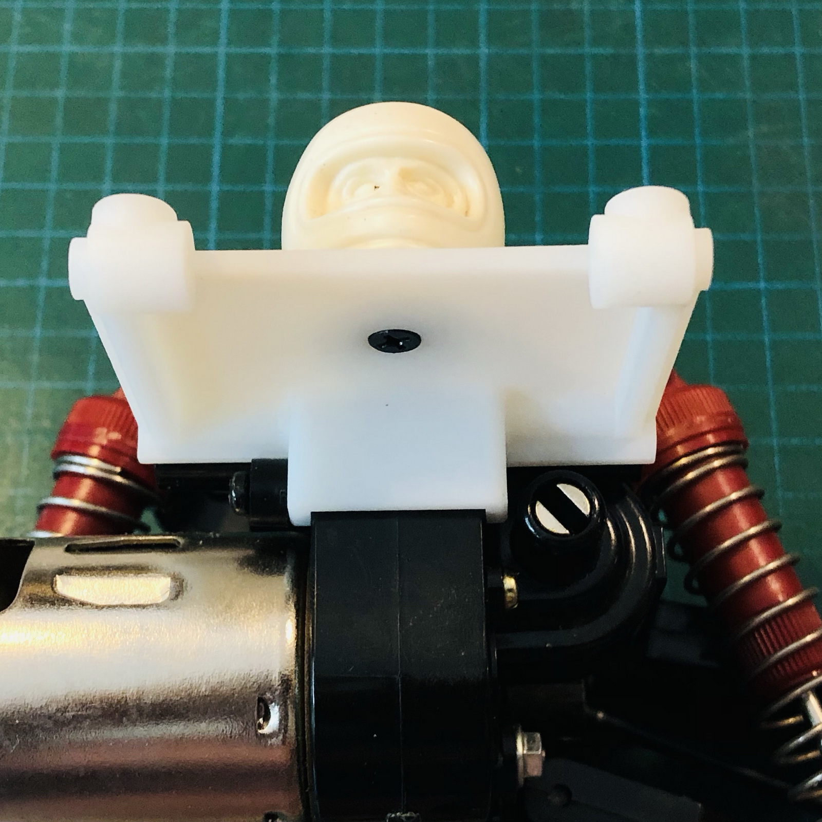

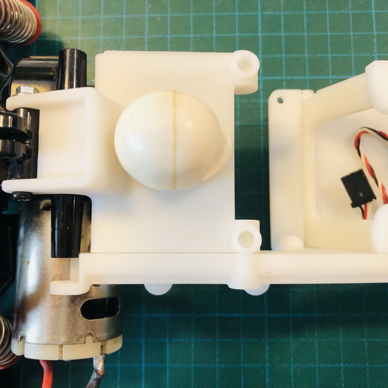

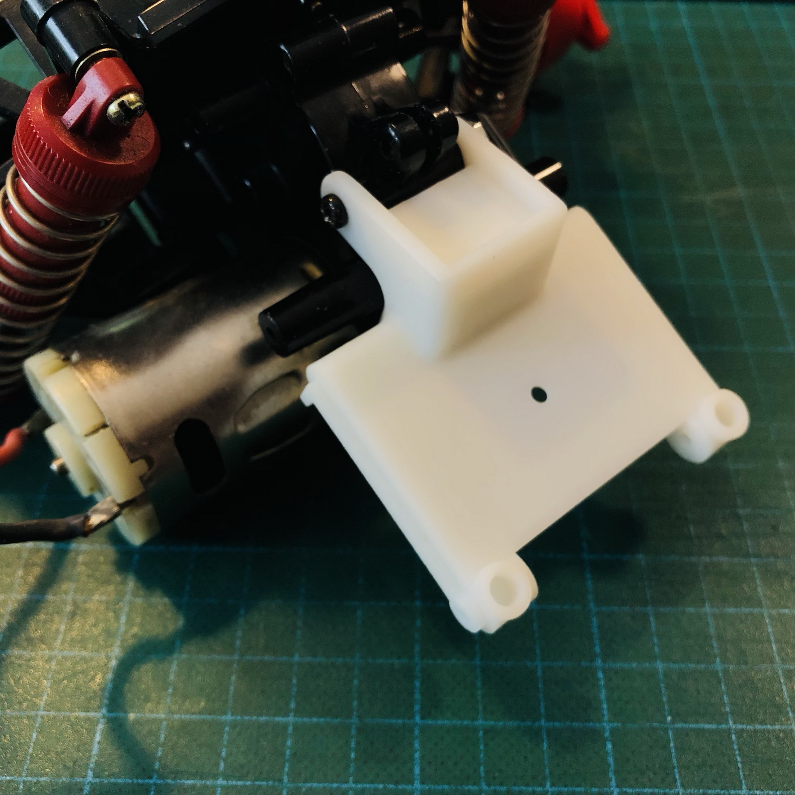

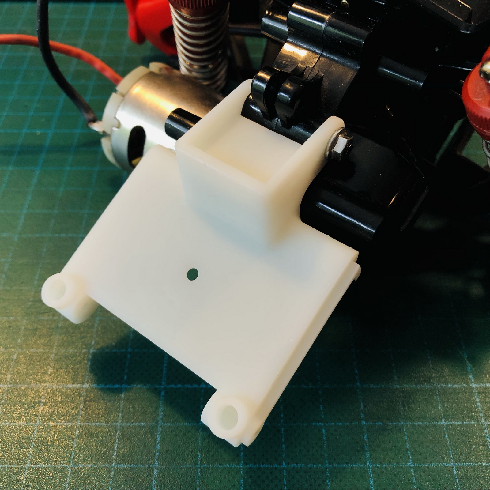

Next is the Driverplate. I attach it to the rear gearbox with 2 M3x30 screws.

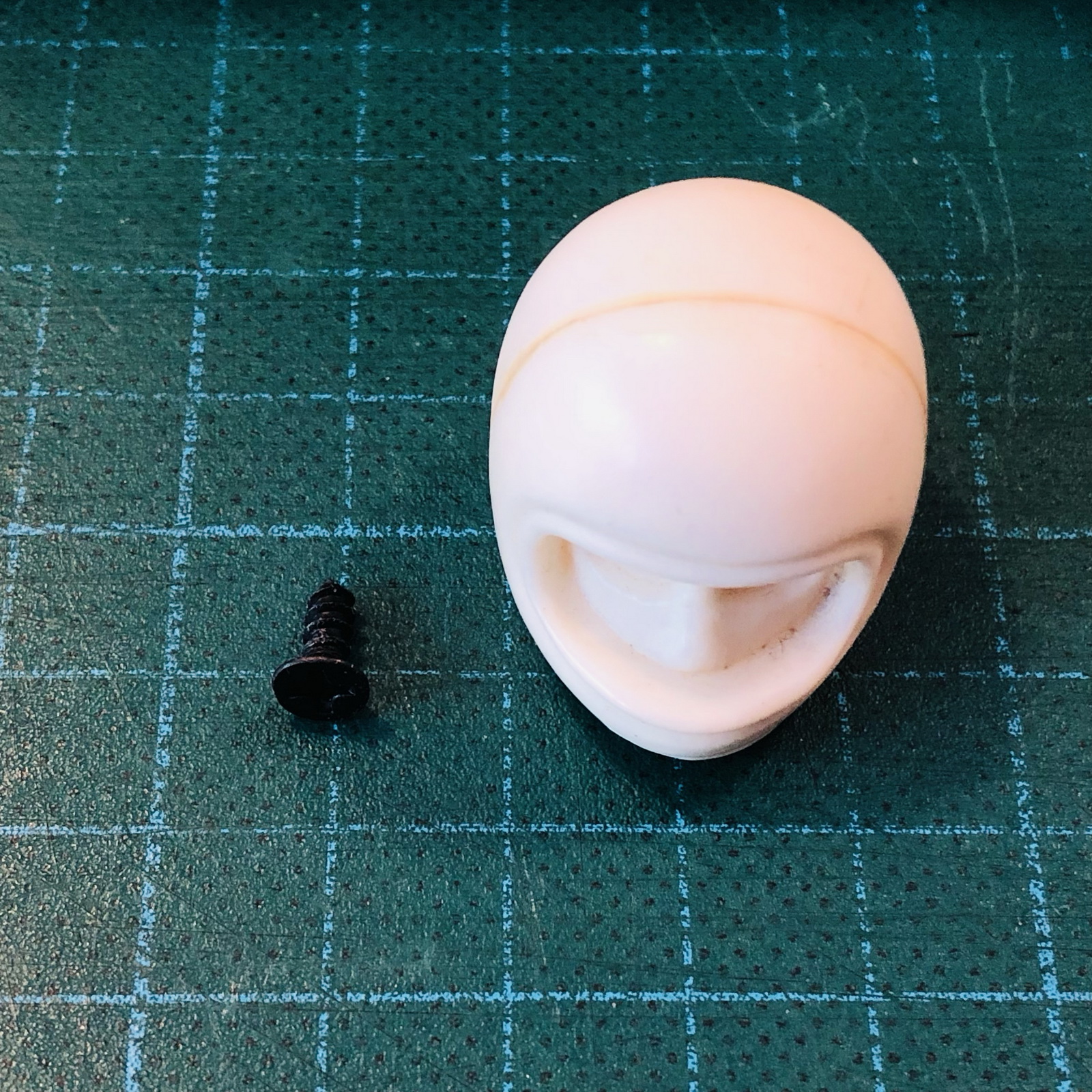

I almost forgot to attach the driver head. M3x8 Flathead tapping screw to the rescue
Here I can confirm that the lower M3x30 screw doesn't touch the propeller joint.
It is written in the OG Hotshot manual but the lower M3x30 screw is too long and touch the propeller joint IF you forget to slide the 5mm spacer onto the screw.
If it is the case, adjust the screw length (add collar, spacer, or simply use a shorter screw).
