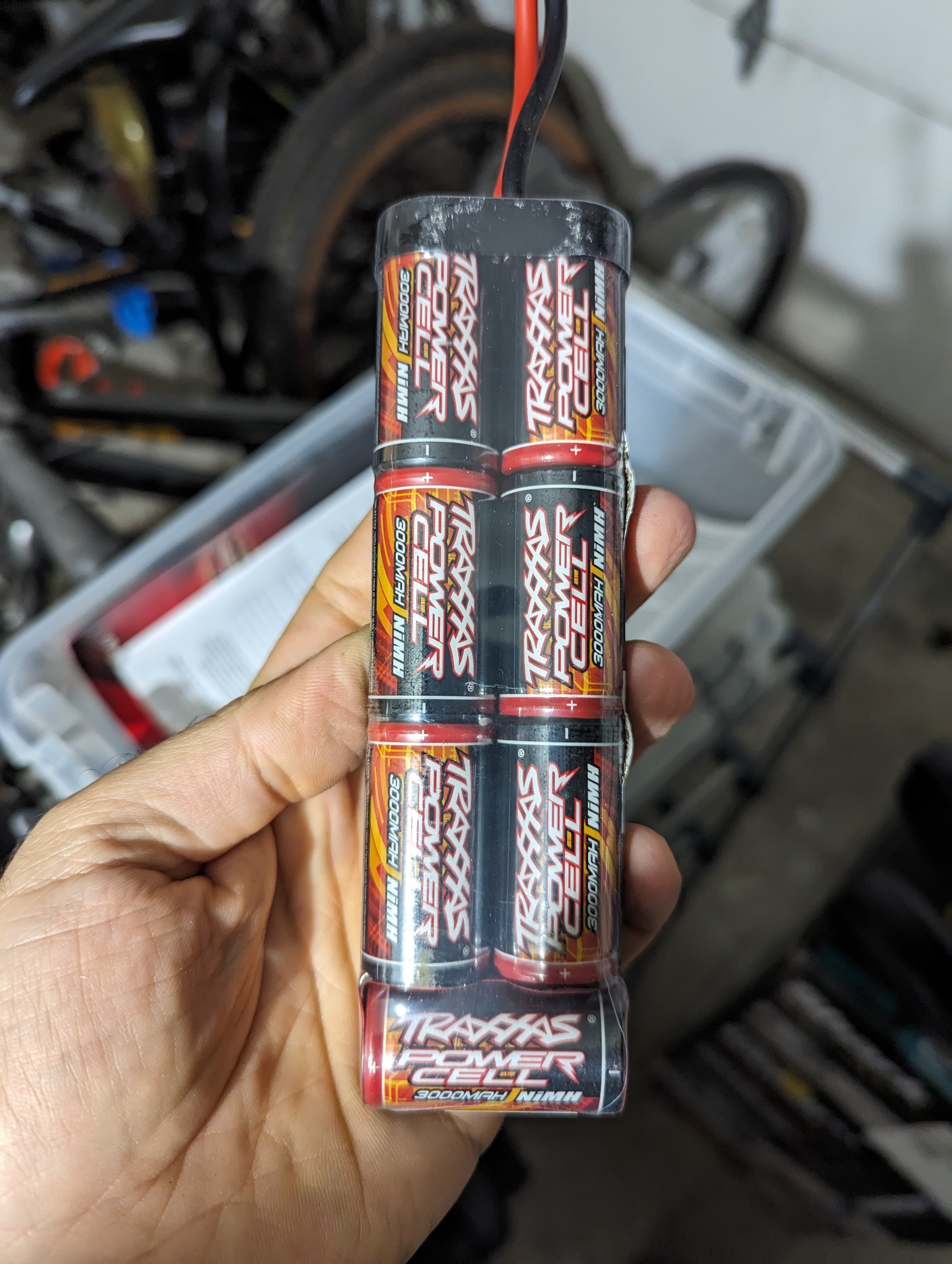

Speaking of batteries, I have a few of these lying around that I no longer use since I've moved my Traxxas cars over to LiPo. Would I be able to use these in the RC10? Maybe just grab a converter for the connector? I don't really have a use for them otherwise so it would be nice to repurpose.

No, 7 cell stick packs are too long.

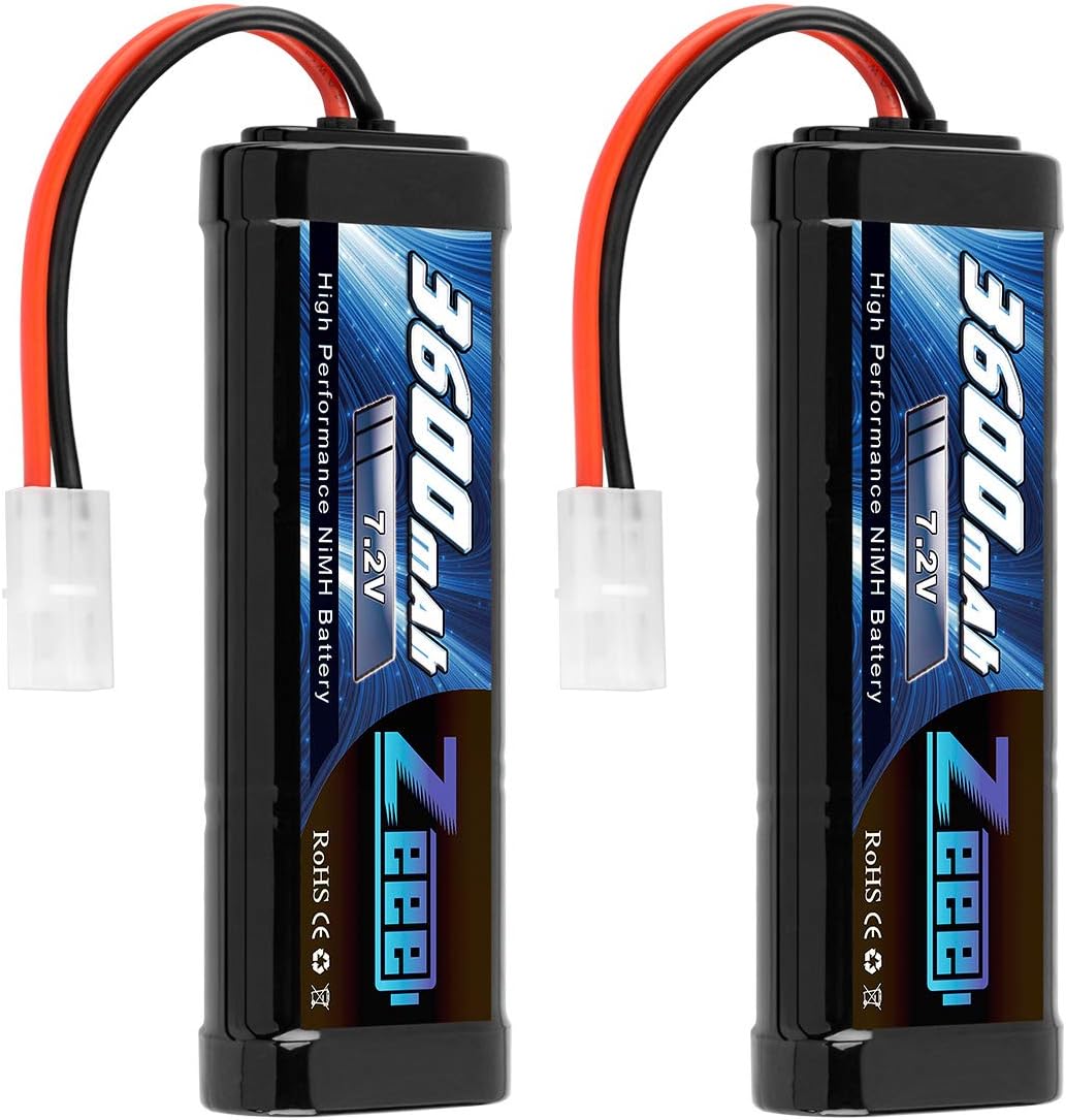

Was thinking about grabbing 2 of these for this car... Any issue here? they are 6 cell. I use Zeee Lipos and they have been pretty reliable for me without breaking the bank. Dimensions are 5.33 x 1.79 x .89in

Those 3600mah batteries will run way longer than that motor can take (overheating). Just keep that in mind. Otherwise nothing wrong with those batteries. You could run a 2s lipo if you time limit yourself to no more than 5 min with cooldown afterward. You could plug in a voltage monitor alarm to the battery to make sure you don't bring it down too low.
