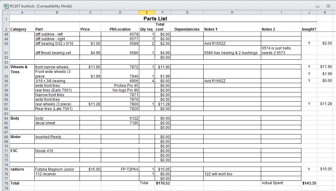

Another idea is to maintain a spreadsheet for your build. I started a spreadsheet when I started to embark on a massive drivetrain upgrade for my Camaro, and have since repurposed that spreadsheet for all of my other non-automotive builds, including my RC projects. It's great because you can break the whole vehicle down into sections (shocks/springs, steering, chassis, transmisson/slipper, etc) and within that you can list every component. Once you've got the parts list, you can add columns such as the part description, part number, price, quantity required, and some notes. I also have a "dependencies" column that I can use to identify when one part choice will interact with another part choice. I haven't run into too many areas with RC where that's been an issue, but if you do a WOIN build opposed to a strict restoration, you'll start to run into those issues.
Overall, it's a great way to keep track of your overall build, what parts you need, and how much you're spending.
I attempted to add my RC10T build sheet, but the forum software doesn't seem to want to allow it.

@Jim85IROC That's awesome, man. Thanks. I like the idea of breaking it down in to major sections. One of my builds is an RC10T and it's missing a bunch of parts. Have you tried to upload your spreadsheet to Google Docs? Here's instructions. The other day I was trying to think of a way to import the parts list from RC10.com to rows. Google docs supports scraping like.

Yeah, actually I have an old version of my Camaro build spreadsheet on Google Docs, but I can't get to Google Docs at work to upload my 10T spreadsheet. If I ever get time to boot my home computer, I'll upload a copy & link to it.szac wrote:Thanks everyone. Appreciate the feedback.

I took a screen capture of part of the spreadsheet. It doesn't show most of the sections, but it shows the headers, and it shows the bottom where I totalled up the projected & actual costs.
Re: Looking for restoration process tips
That's great, man. Thanks for sharing. I'm creating my own version for my builds.
