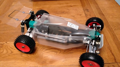

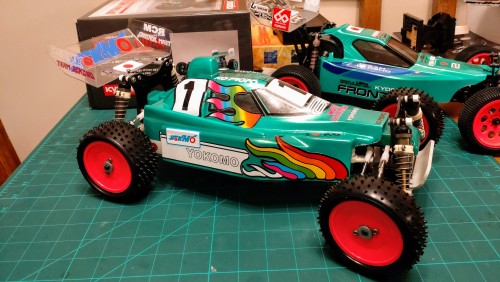

Completed car with body from Penguin, the wing is also Penguin one. I'm unsure about the wing buttons they are a similar colour grey to Yokomo 870c shocks. The wing wire came with I think a Buds wing from back in the day. The tyres are not correct for an exact replica but they are vintage Yokomo Hotlaps, the wheels are JC racing.

Yokomo ZC-422 for both, I had to use spacers to push the shaft inwards on the front to get them to sit correctly in the diff. I think for a runner it would be better to use the ZC-423 later YZ-10 ones as they are slightly longer or you could just run original front wishbones and not the rear ones on the front. If I decide to run her I'll pick some JC Racing or FAN RC ones up or do the arm swap, the cost would be about the same.
