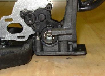

Looks good so far. Did you test fit your steering servo before installing the front suspension? Chances are you'll have to do a little 'dremeling' to get it to fit right. If so, it is much easier to do so with the front end removed. I did mine with a hand file to have a little more control and have a better looking finished product.
Any thoughts on the open bottom tranny? I was surprised to see an open case at the bottom. Seems silly to 'seal' the case halves with grease as instructed in the manual. Dirt will take the path of least resistance - An open gap versus two case halves clamped together seems like an easier way inside.

I know what you meen about the tranny, but I'll be running the car indoors for the time being, so not too dirty. I have set my tranny as low as possible anyway, so there is no gap, but I'm sure dirt will still find a way in :(

Weave wrote:Looks good so far. Did you test fit your steering servo before installing the front suspension? Chances are you'll have to do a little 'dremeling' to get it to fit right. If so, it is much easier to do so with the front end removed. I did mine with a hand file to have a little more control and have a better looking finished product.
Weave
It's possible to make small lexan inserts when you make some room for then at the tranny base. That solves most of the problems. It also fits if you do not make room, but tranny will be warped and not run smootly and the seal will still be bad.
Weave
Just an idea:
you could get those sheets of felt with one sticky side. Cut it carefully so it won't interfere with the diff gear. It will raise the gearbox a bit though and I'm not sure if that's ok.
Anothter way , but a bit more cumbersome for maintenance: seal it of with silicon* after mounting.
(*:You know the type they use to seal windows)
