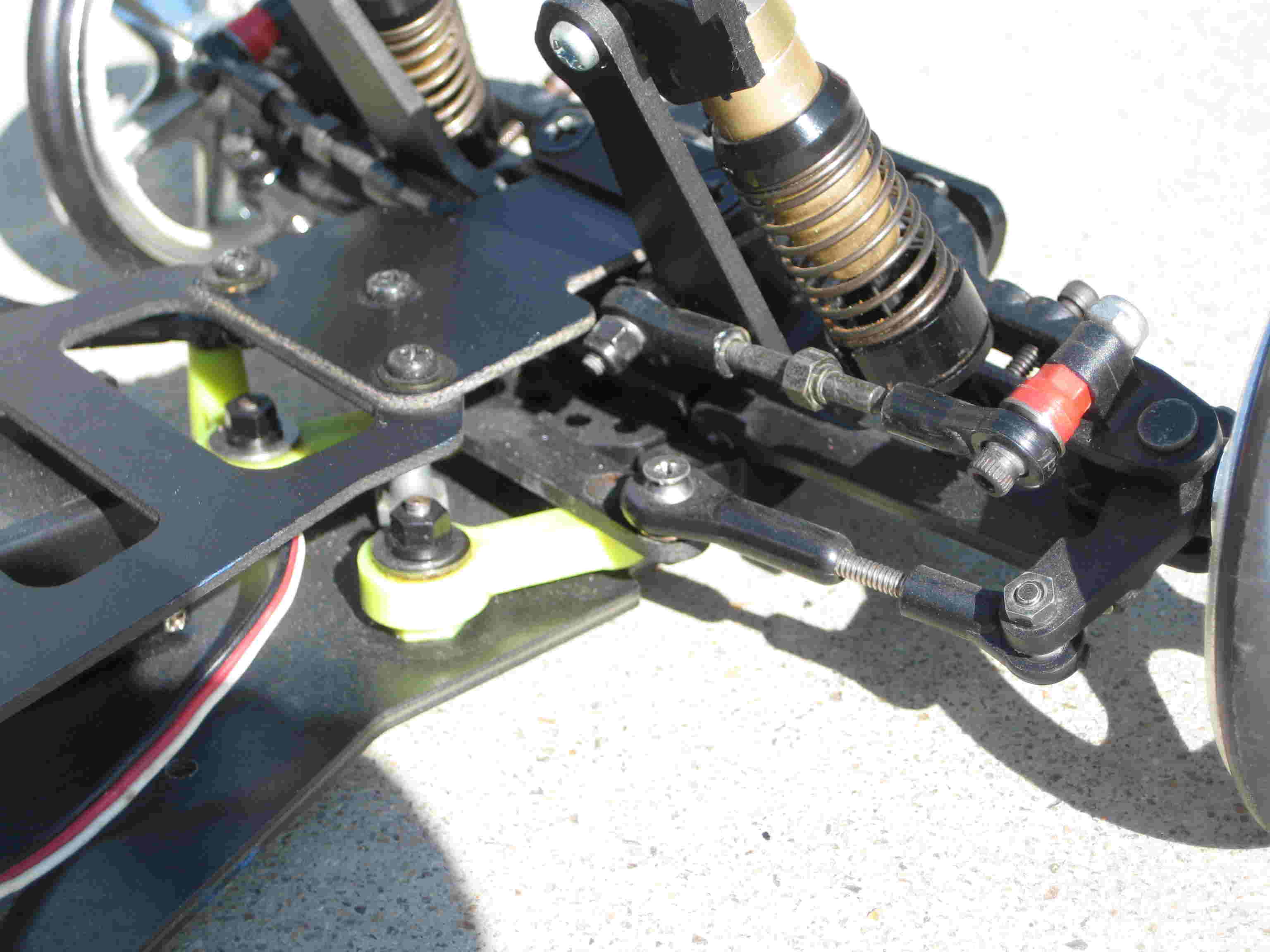

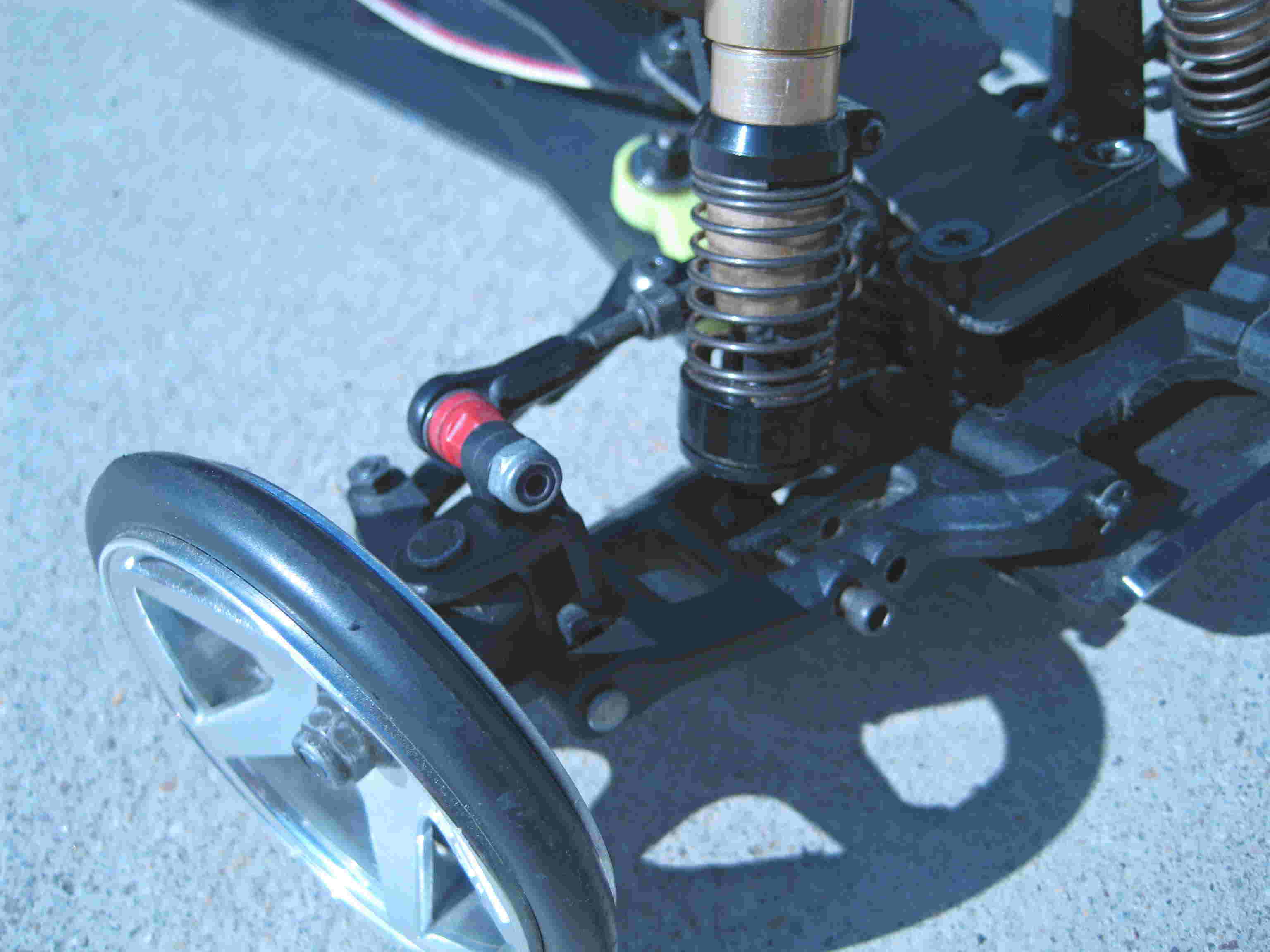

Here's a couple more pictures of the chassis & modified Ultima front arms used.
Remember, this was an incomplete car & parts when I aquired it..so all the Triumph parts used are still intact.
The Andy's & stock Ultima arms were spare parts. The (extra) A&L steering rack for the Ultima fit perfect.
As far as this Triumph goes..., I guess you can teach an old dog new tricks.
Hey, at least I don't have to search for those oddball front shocks anymore..

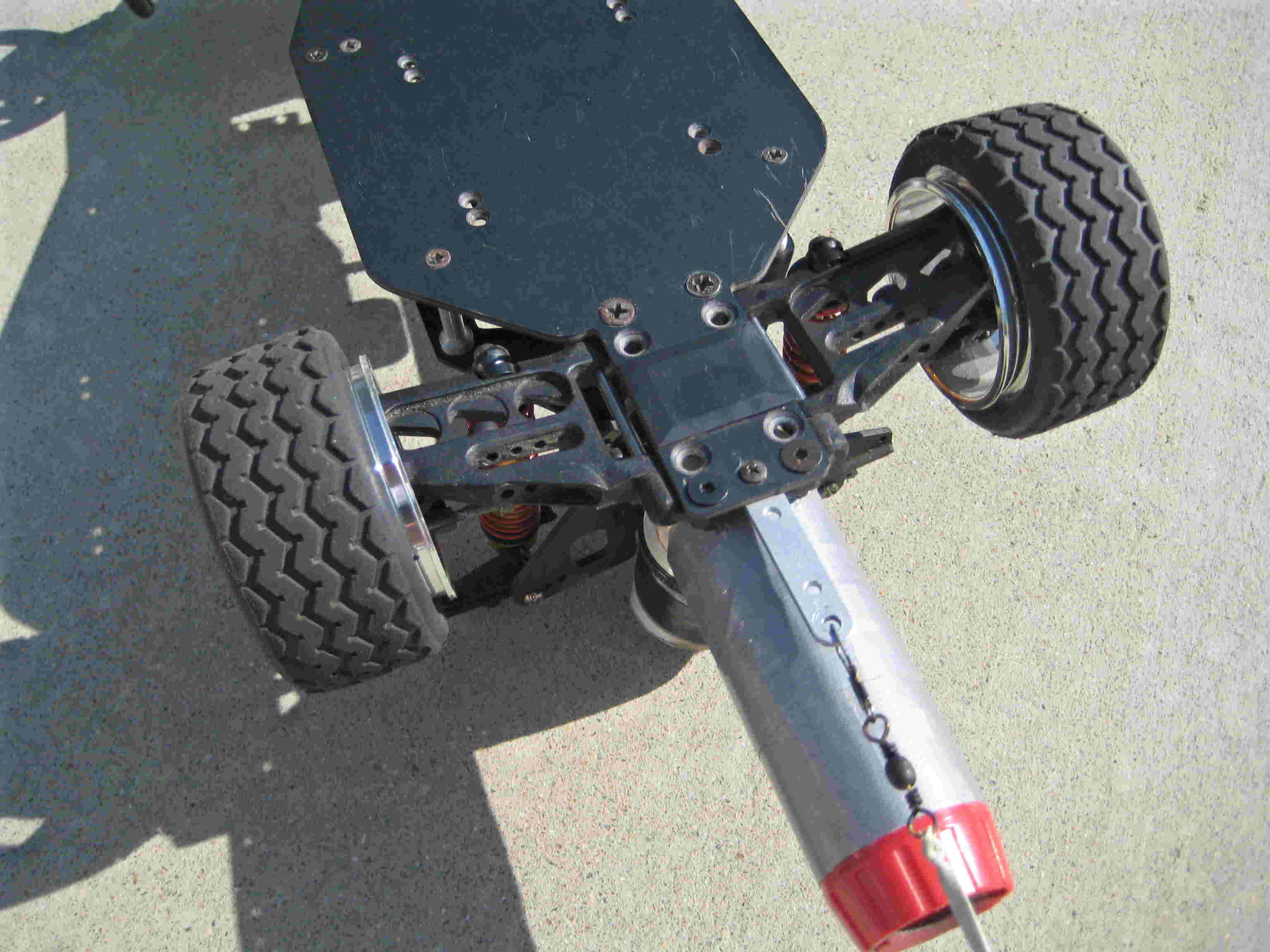

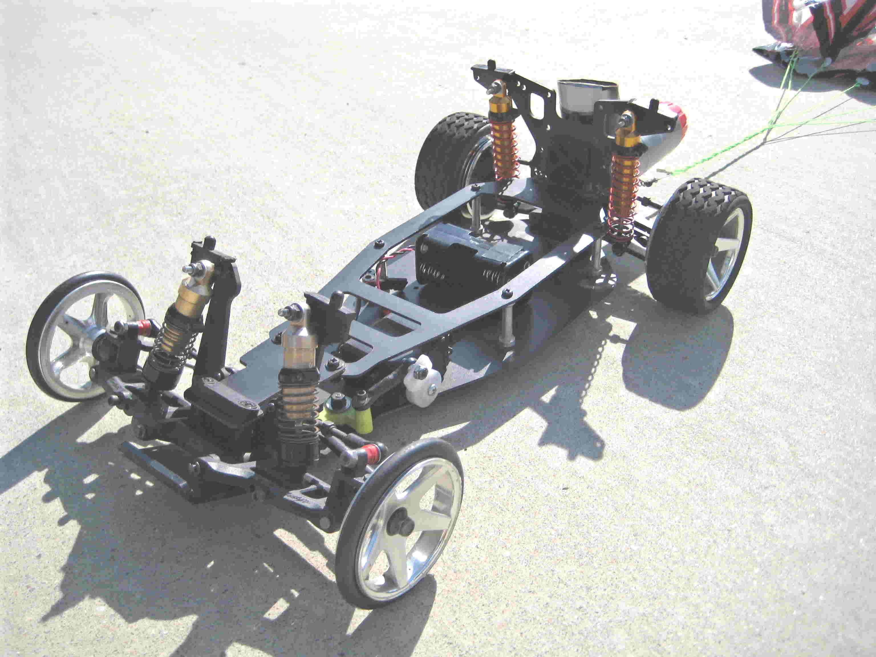

Did a bit of re-engineering since last post:
Re configured rear suspension (shorter & lighter shocks), front suspension tweaks, and completely re-did motor mount.
Car now sits about 1/8-1/4" of the ground.
Engine now sits about a half inch higher in the chassis and looks much better coming out the rear bumper. (no more huge gap) I don't think it will have any effect on the center of gravity, since it might way about 2.5 ounces fully loaded..
Removed AA battery pack & will be hitting the local Radio Shack for something way smaller & lighter.
Working towards leaner, cleaner, & meaner!
Action shots coming soon!

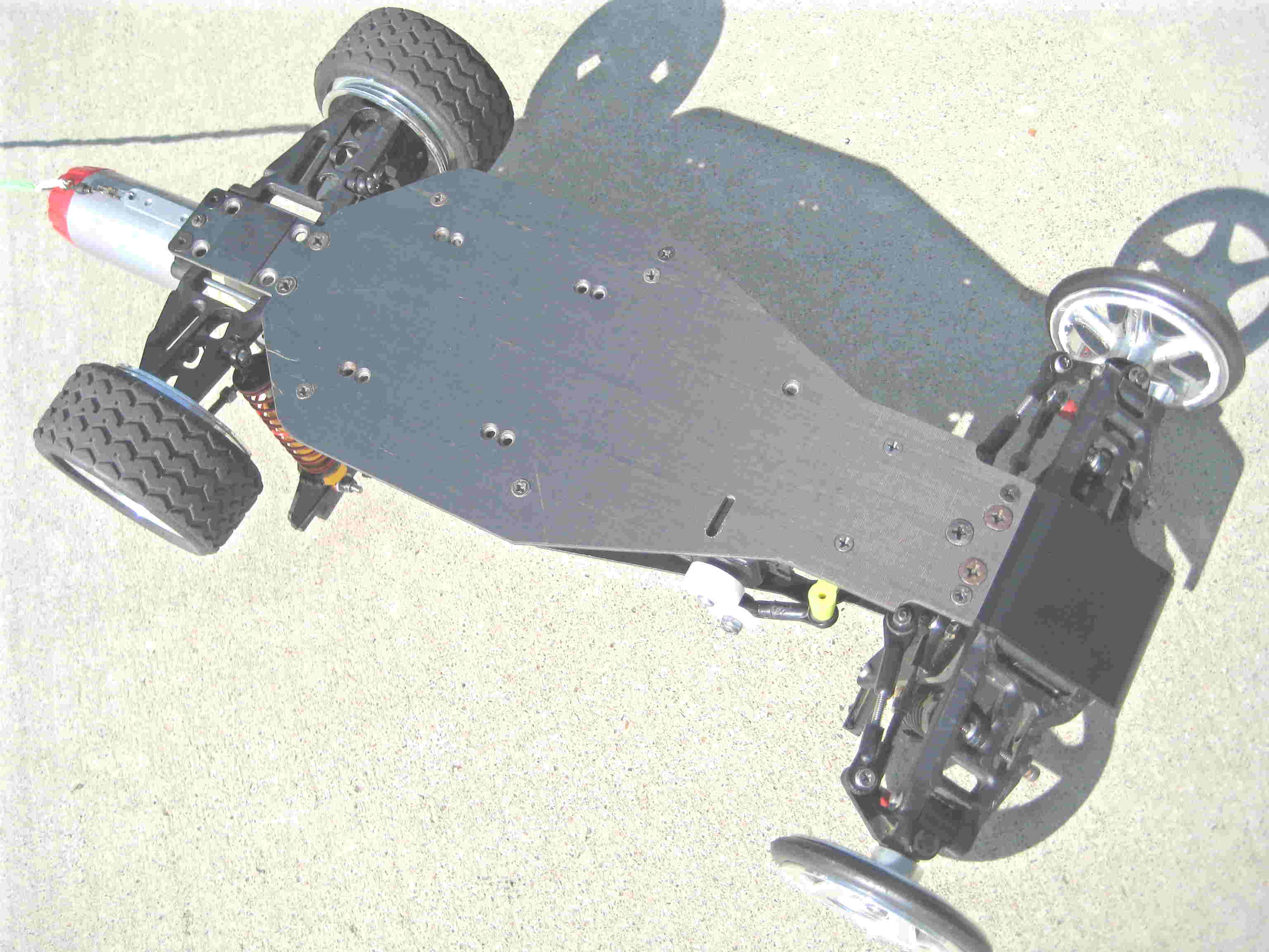

Project has been on back burner for awhile, working on a few additional tweaks...
Still trying to find a smart-ass looking cartoon dog for the side graphics idea...hence the "Red Rockit" idea...(and yes I know how to spell "rocket")
I think Autographics used to make a decal with a cartoon dog hanging it's head out a car window, but I can't seem to find it anywhere.
Does anyone have a photo or scan of it?
Additional shots:
Additional shots:

I'm not sure , but don't the triumph arms have the toe-in built in? I'm worried the ultima front arms give you 0° toe-in and you've taken away the straight-line stability with this change...
Re: Kyosho Triumph Project - Rocket Powered.....
Nice build! Definitely in need of a night video though...should look great!
- Diggley
- Posts: 1166
- Location: is everything...
- Been thanked: 8 times
No problems yet.Mr. ED wrote:I'm not sure , but don't the triumph arms have the toe-in built in? I'm worried the ultima front arms give you 0° toe-in and you've taken away the straight-line stability with this change...
I couldn't use the Triumph arms, they were way too wide.
The Andy's (Ultima) arms work perfect, besides I can adjust the tow in w/no problem. I'm pretty sure I've got about 20-25 degrees of caster in the front, so it doesn't wander a bit. The modified rear (FT Ultima) arms worked out perfect. I don't think rear tow in is a factor, since the rear isn't fighting for traction.
