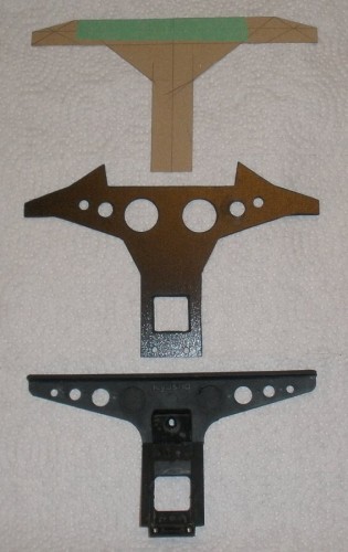

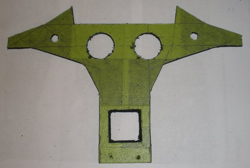

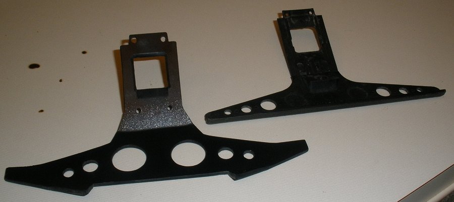

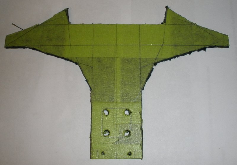

Original bumper design
I finally got around to fabricating a bumper for this car. It just didn't seem right to simply slap on the stock Optima bumper, because it's so far from stock. Barney deserves something original and unique. I wanted a bumper with a little "attitude", something that was better suited to this beast. I liked how my design worked for CYANide, but needed something more robust. I based the Barney bumper design off of my CYANide template (top of last pic) but bought some 3mm thick Kydex, which is thicker than the stock Optima bumper.
I'm almost finished...I just have to drill a couple more holes ahead of the square opening, add a few notches at the bottom to clear those 2 bottom frame rail screws, heat-gun it to give it an upward angle, and lastly, heat the "teeth" and bend them upwards.

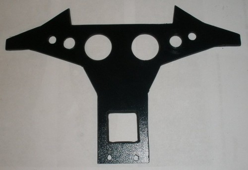

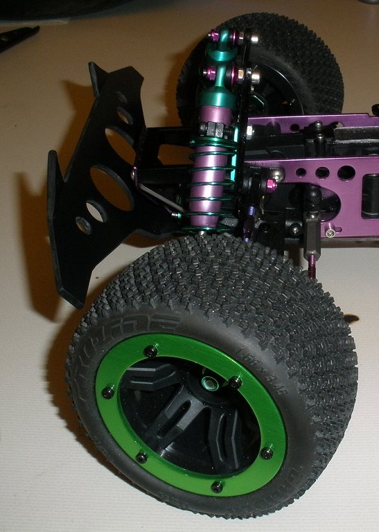

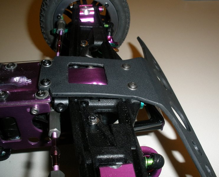

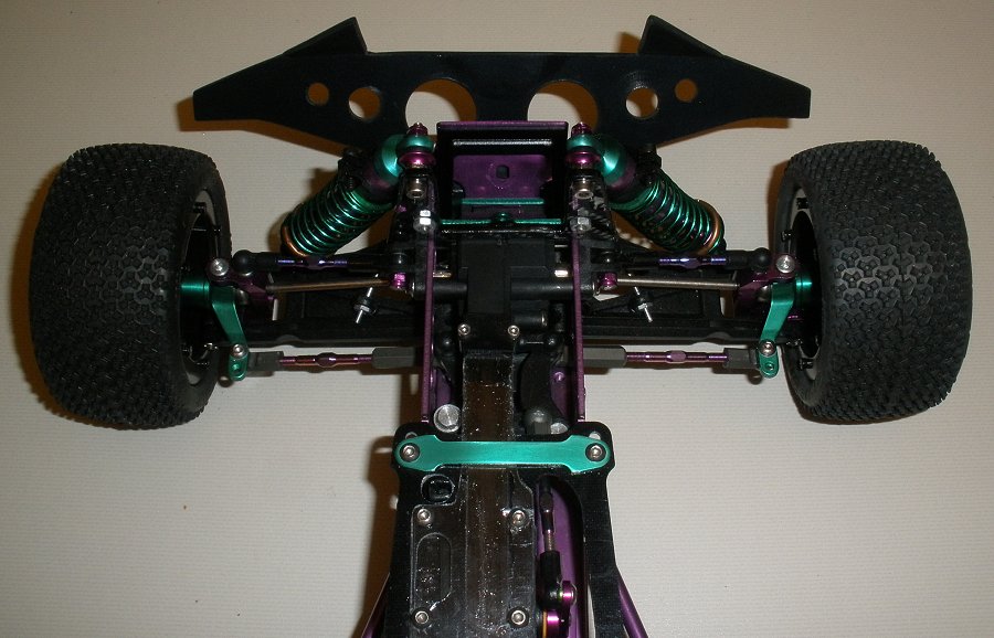

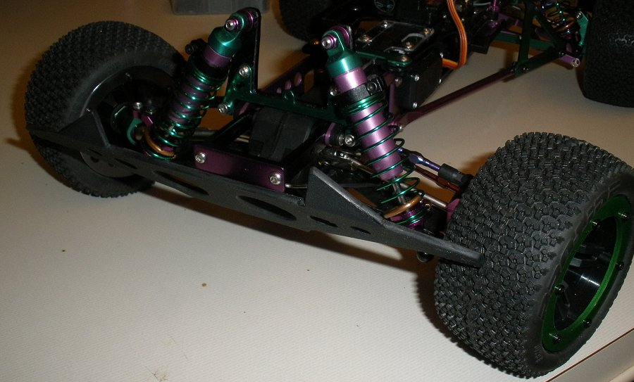

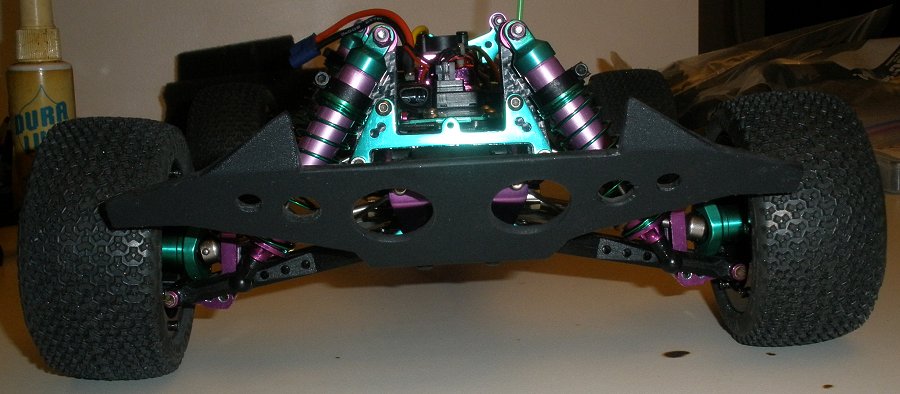

Bumper finished
I finished the bumper tonight. I even filed a shallow angle on the inside leading edge of the square hole so the bumper will fit nice and flush on top of the front diff bulge, just like the stock bumper does. I drilled a pair of holes so in addition to the usual rear-ward mounting holes on the frame rails, it mounts to the front 2 holes of the chin undertray. This is how the JG Mfg. aftermarket bumpers are mounted. (The JG bumper, however, has a more simple, rudimentary design; it's just a straight, flat piece of Kydex forced to bend in a curve around the diff bulge, and looks like crap when you see it from the bottom.)
I didn't want to use the Optima's usual honkin' big center bolt to mount it right against the front of the chin piece because that just ends up bending it all to hell in a front end collision.
After bending it in the usual place and bending up the "teeth", I made sure the larger 2.2" tires wouldn't make contact with full steering, and all looks good. The reason I even included those teeth was so that I could bend them at an angle such that the bumper would deflect from rocks & big bumps, just like the stock Optima bumper has that bent-up leading lip.
After all was said & done, it's significantly more sturdy and more rigid than the stock bumper, but it has to be because this car is quite a bit heavier than an Optima. And now, Barney actually has teeth.

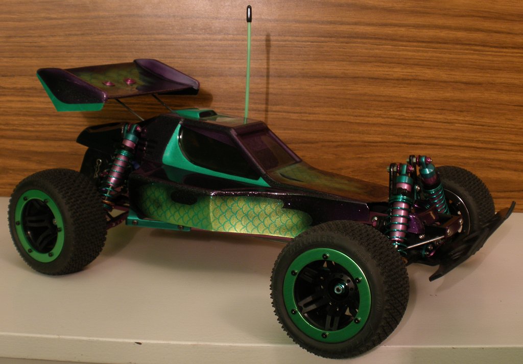

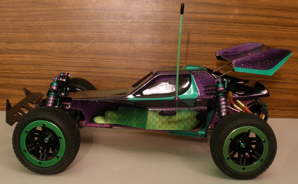

Almost done
I'm near the end of the road with this project. The body's painted and protected (hopefully enough) with 3 or 4 coats of Duplicolor Crystal Clear and even some Shoe Goo in some of the Optima's weaker body areas, like the front body mount, sides, and the area surrounding the rear shocks/tower. I have a few minor tweaks before I turn him loose, I think the wing needs a slight bit more angle. I'm aiming for the green lines edging the wing to be more or less horizontal.
