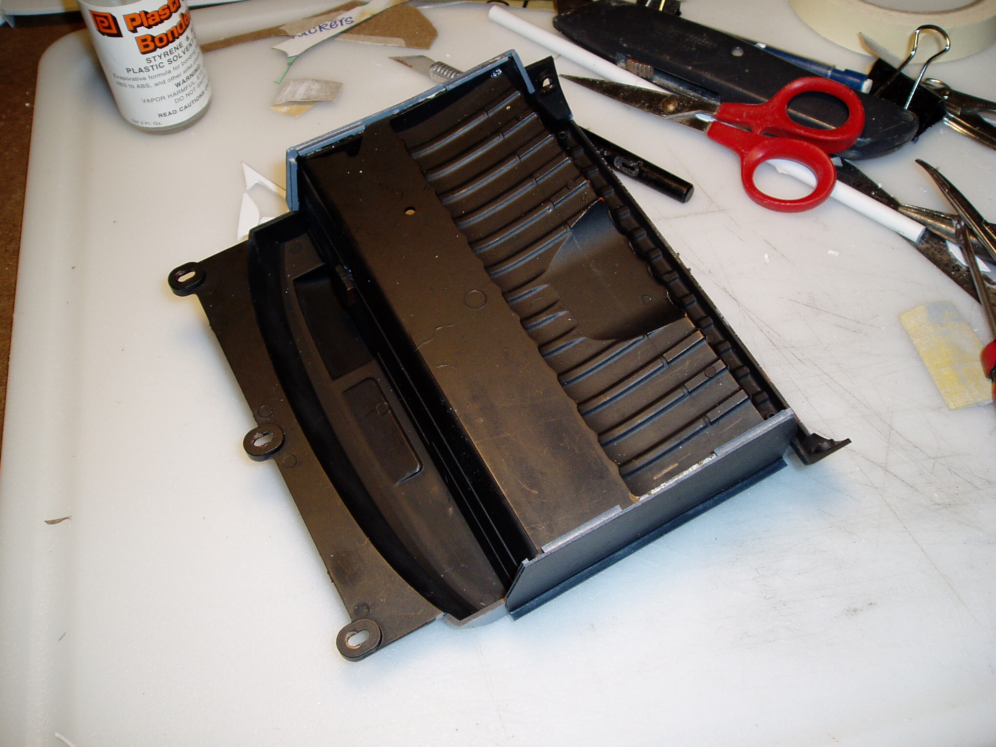

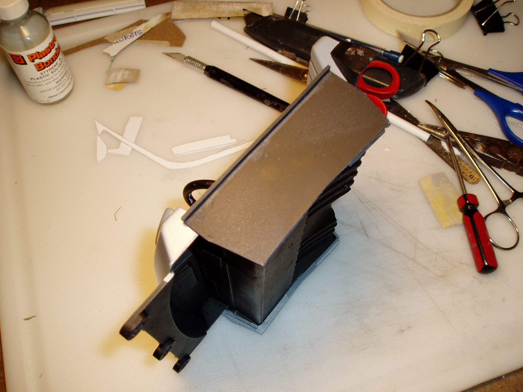

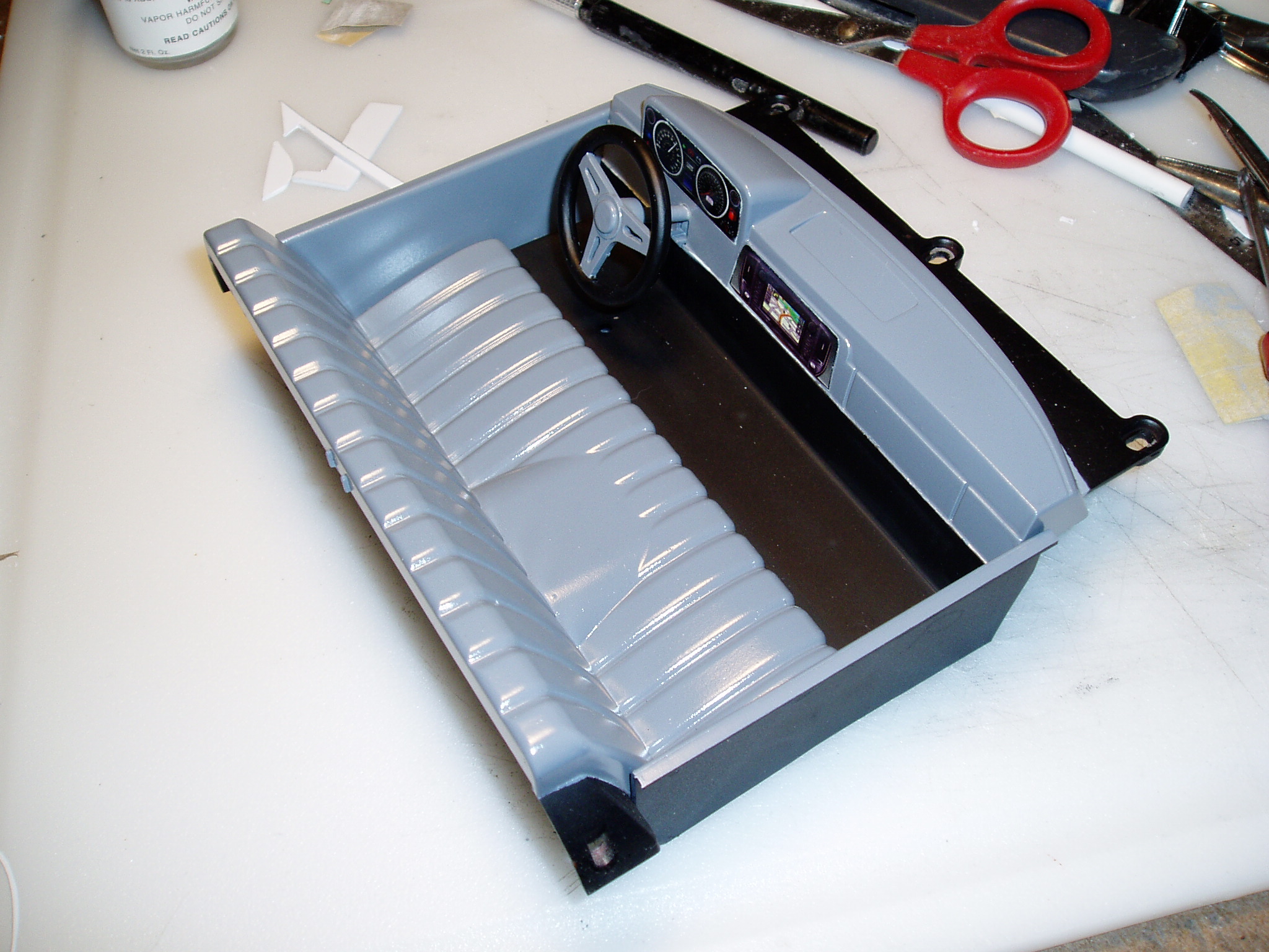

I just made a set from .060" styrene sheet stock. Not much detail (actually no detail) but they do the job and they're really hard to see when the body is assembled anyway. I got the truck cause it was cheap so I don't want to dump a ton of money into it.

Nothing fancy. Wish I'd used regular gray primer rather than gloss gray Testors paint - too shiny. Gotta love the "infotainment" unit in the center of the dash. haha..
