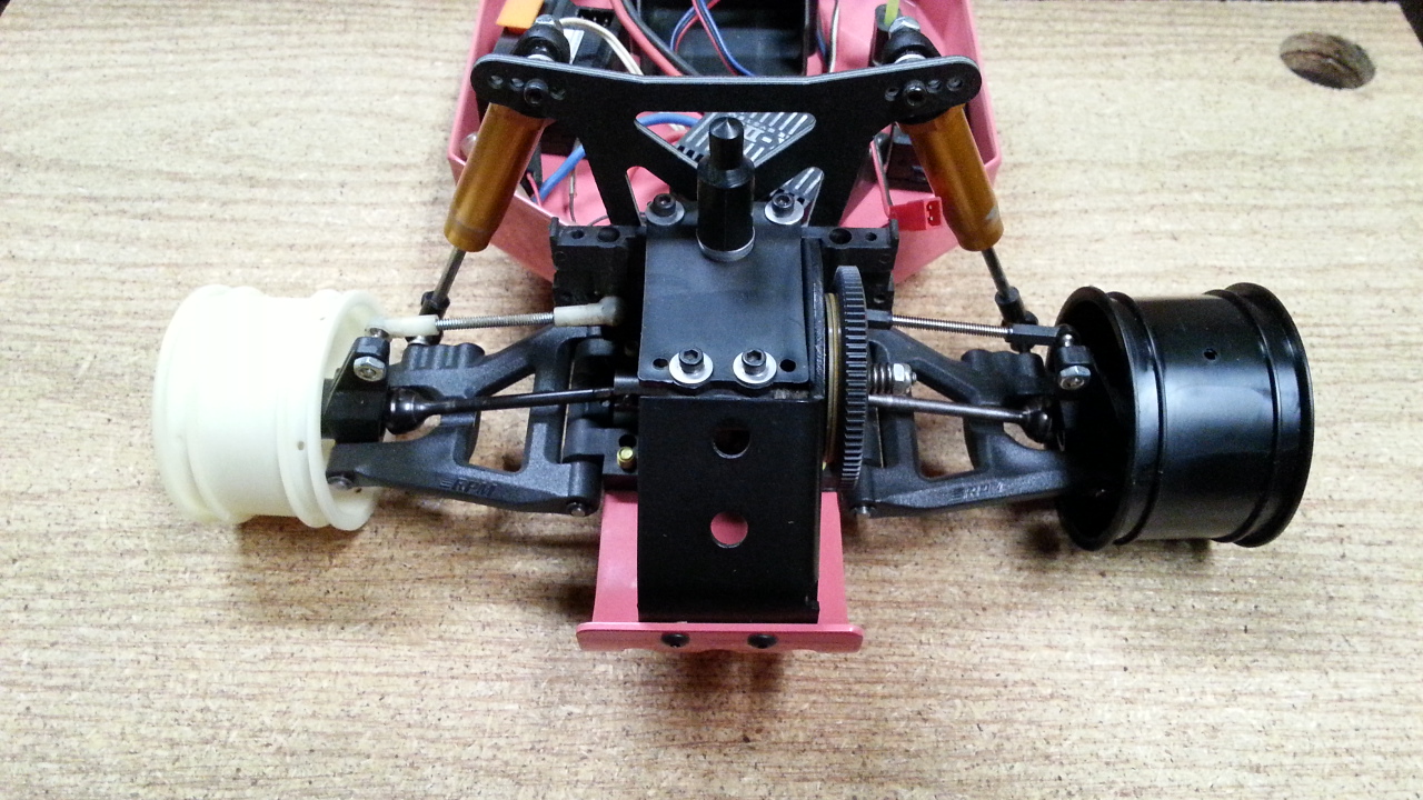

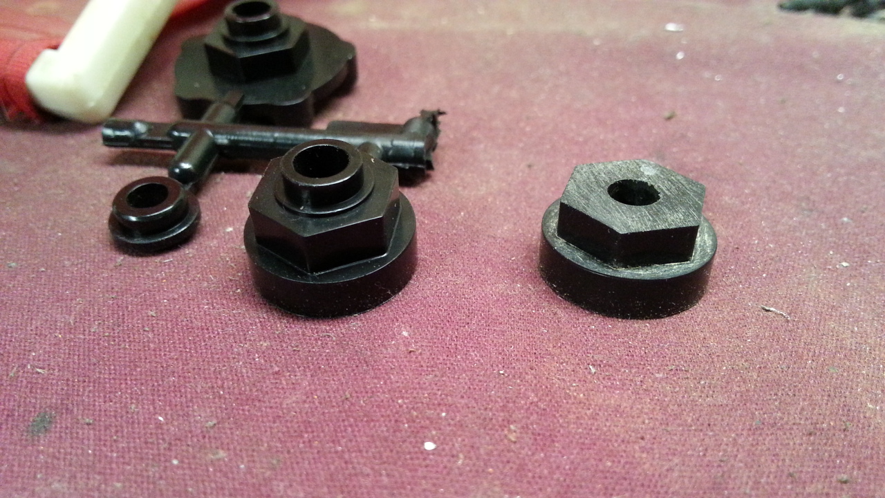

I stopped in at hobbytown today for a certain part and of course they didn't have it. But they did happen to have some of the jconcept 1/16 e-revo rims and I've wanted a pair of them for awhile now to mess sround with. So here's the direction I went:
Modified hpi super star adapters for losi.

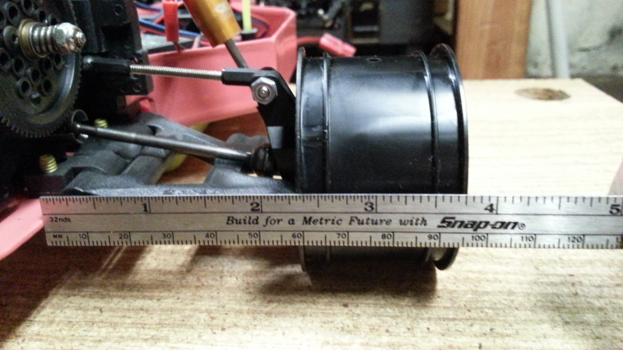

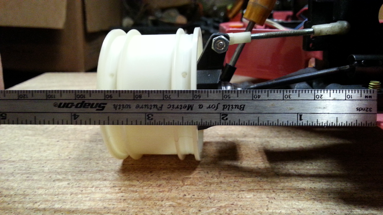

I then installed a b3 cvd on the right side with stock carriers and flanged 3/16" bearings. 1/4" on the left with a tq style 2" rim.
Pretty close going by the center of the wheel.
recent thread from sean doing pretty much the same thing with jammin rims and differnt adapter:
http://www.rc10talk.com/viewtopic.php?f=40&t=30218

With that setup pn your b1.5, you could do JConcepts rulux dyed black up front - that'd be pretty trick right? You get the cool looks of the rulux, without having to go all OIN...(seeing as though that's getting pretty tired now

looks like a pretty wide wheel. do you have to trim the inner bead off or will a standard buggy tire fit on there?

I believe those wheels are designed for buggy tires.

ok, i haven't looked into it much.... if at all. i'm sure there are different thicknesses of the 12mm hexes for 3/16" axles. anyone feel like compiling a small list of mfg. and the thickness of their hexes?

maybe ill figure it out, i was running 1/16 e revo wheels for a short while. The biggest issue was the rims. I was trying to offset them as much as possible in the rear which ended with the nut barely fitting inside the rim and tightening would scrap against the rims. also, with the fronts, it seems like they dont fit 5mm as I had to grind the inside slightly to get them on the axle. The offset they have makes it difficult to avoid hitting the hub carrier. I had b4 parts on the front during that test.
I'm gonna order one but If my measurements are right. a 3/16 x 1/2" bearing will fit in the 12mm hex tightly. I had a 5mm x 12mm in a test setup but it had some wobble to it. I need to measure out a bearing size for the outside of the wheel. Also a note. This was for the front wheels.
