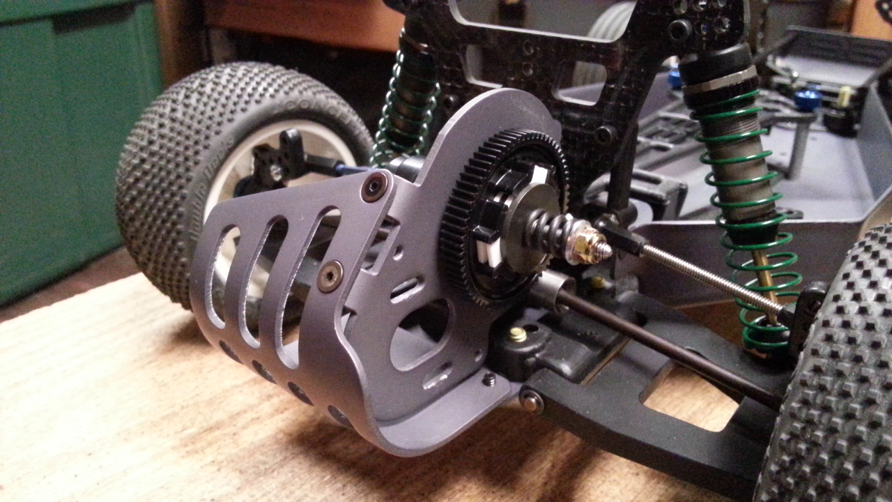

Nice builds scr8p! I like the detail on the rear tower for the runner to fit bodies properly. Any ideas for mounting a wing with tubes or are the "masami" style shock tower wing mounts the way to go? I think Associated still should have made this car and saved the composite B2 as the first B3 design. Probably still would have won the '95 world's LOL! :roll:
Posts: 16816
Re: RC10 B1.5
carloco8 wrote:Nice builds scr8p! I like the detail on the rear tower for the runner to fit bodies properly. Any ideas for mounting a wing with tubes or are the "masami" style shock tower wing mounts the way to go?
Unfortunately it doesn't seem that I opened the tower up enough at the top, so I'm still gonna have to atleast notch the body in that area. Or maybe heat the lexan up and push it out of the way at those 2 spots. As for the wing mounts, most likely i'll go with a pair of bud's or yoke wing mounts. The openings in the tower are gonna keep me from usin the b4 mounts.... I think.
The b4 topshaft showed up today so I got the trans buttoned up and the avid triad slipper clutch installed. For future reference, these don't drop right on like the standard b4 stuff does. You gotta make it work. I over engineered the living crap out of it, but I was bored. :lol:

This is cool. Should have an awesome feel with that tranny and the tub.
The Losi 22 wing mounts (for the mid motor setup) might fit if you spread them out wider on the cheeks of the mouse face, and maybe use those existing bolt holes even...that is if you don't have a one Losi part per build rule in place here.

Y'ernat Al wrote:The Losi 22 wing mounts (for the mid motor setup) might fit
thanks for the heads up on those. while i was on google looking for an image of them, i came across xx4 or xxx4 wing mounts that may work as well. i'll grab a pair of each and see how it goes.

Looking really good here! That spur looks too small though for a good mesh with the motor pinion, unless you use a really big one. It also look like it's really close to the motor plate. One of the nicest WOIN builds so far!

I think a lot of that is the pic, but it is close. I want to put a standard b4 slipper on it for comparison, just because I did have to "make" the avid slipper work. It was designed for the b4 trans/topshaft, but not a b4 topshaft in a t2 case. :wink:
The avid slipper comes as a stock or mod kit. Each one comes with 2 spurs. Being as though I doubt I would run more than a 17.5 I went with the stock kit (72 & 76 spur). I asked a knowledgeable member about a starting point for gearing. For non boosted 17.5 he suggested a 69 spur with I believe a 36 pinion (remember this is a 2.60 trans). With a 36 on it, the motor will be dead center in the slot on the motor plate.

on my B4, with the Avid set up (love it by the way), 17.5 non boosted, 33/72 - seems to work well for me.

I'm gonna say the huge size of the track I'd be running on probably influenced the gearing suggestion. Idk, brushless gearing is all greek to me. :lol:
