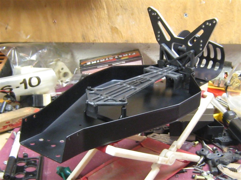

i have wanted to do a build like this for a couple years now. thanks to al, jay, and paul for hooking me up with the nip stuff i needed to get it going. so here's the beginning of my t2 buggy, which i'm calling a B1.5.

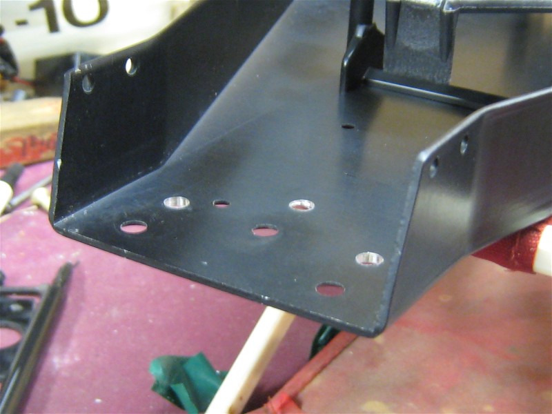

a couple of other guys have done this already......... carloco8's build comes to mind. but, i didn't want mine to have the long wheelbase. so, i got the new holes drilled in the chassis to move the nose plate back to buggy length. unfortunatly, my 100 degree countersink bit took a crap so i wasn't able to finish it up (and still haven't gotten a new bit ). i also need to cut the first 7/16" or so off the front, and relocated the servo mount holes. i'll also be designing a new rear shock tower, similar to a standard rc10 buggy rear tower or the worlds tower, made to fit on the t2 bulkhead. i'm still unsure about what front end i want to use on this. i was thinking just a buggy nose plate w/ the standard associated part to finish it off. i'd like to make it look like something that could have come out the same time the t2 did. but, i also wouldn't mind building up something like the "what was old is still old, but new" cars. 10t nose plate, worlds tower, dynotech arms, b44 cvd, b4 rims, etc. i guess i'll just see how it all plays out.
i put some of the car together, mainly so i could see how the battery sat, and if i'd need to move the battery box back, since the servo was going to be moved back. but, it should be able to stay where it's at. the hold down will need to be modified a bit, though. it definately won't be able to run 7 cells anymore, but i doubt a battery will ever go in this car once it's done anyway.
here it is so far. not much to look at yet, but.......

Hey Jason, that isn't a B1.5, its an AE kit #8999--put a truck front K/U on it with some B2 arms!

Iv looked at that chassis and thought about doing a similar build. this should be cool set up as buggy. I like the idea

The way the sides kick up make that one of the coolist looking chassis Assoc came out with R you going to make some custom towers front and back, And what vintage of body r u going to use?

Somebody must be feeling better, he is on a building spree.
Just so you know, even though you said you don't like copies, I'll likely copy everything you do. Differenc would be long wheelbase.

well......... more like a picture taking spree.mrlexan wrote:Somebody must be feeling better, he is on a building spree.
it's been sitting like this for a month or so now. i just figured i'd get some build pics up.

From the creative mind comes a creative product! It's definitely one car to be set apart from the others
Looking forward to the finished ride scr8p

i'm just making a new rear one to fit the bulkhead. i was thinking about picking up a carbon fiber front tower from our member atlas next time he lists some on ebay. that way i can use the .89 threaded shocks up front.Soncho Ponza wrote:The way the sides kick up make that one of the coolist looking chassis Assoc came out with R you going to make some custom towers front and back, And what vintage of body r u going to use?
as for a body....... i don't know yet. i was thinking either a viper, or i'll get one of the turbo mirage bodies from jay for it. with how quick my builds get done, it'll be awhile before it needs a lid on it.
also, once i'm done getting it all fit together, it's getting torn down and everything is getting sent out to be re-anodized a different color. tub, nose plate, motor plate, motor guard, nose brace tubes, shock bodies and caps, etc. i might have my dad's neighbor do some "worlds type" milling on the tub, too. we'll see.........
