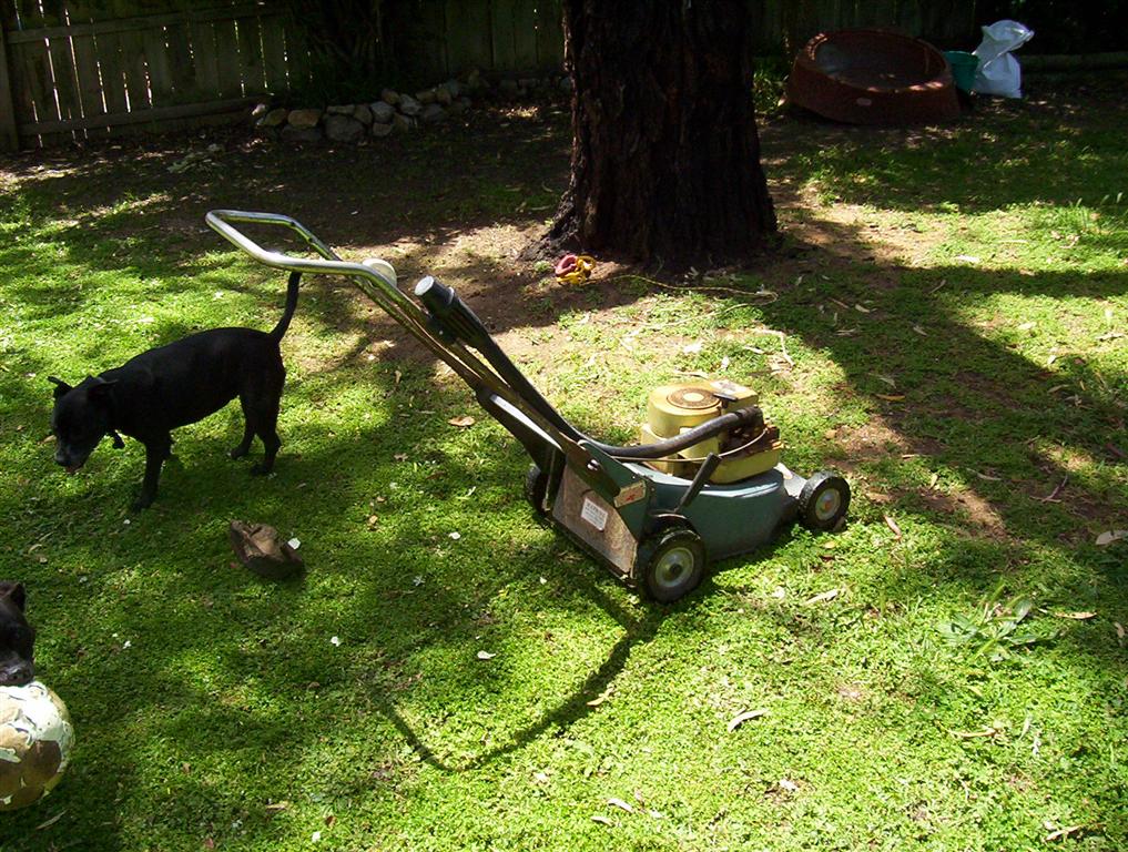

- Posts: 1254
- Has thanked: 727 times
- Been thanked: 26 times
Re: Getting the big Fairlane back on the road.... It drives
Hi Guys,
I always put myself out there, waiting for others that know more to teach me.
Here is a mower I picked up off the side of the road,
It is around 35 years old.
You will notice the lawn is half cut, I used the mower to cut the back lawn today.
Took less than half an hour to get running.
Compression. check.
Spark. NO.
Change plug,
Spark check.
Add fuel.
Pull cord,
Don't know how long it has not been running,
Pulled cord about 6 - 10 times,
If it didn't start work on carby.
O.K started, now running leave running for 3 minutes.
O.k don't need to touch carby.
Now starts first pull.
Compression. check.
Spark. NO.
Change plug,
Spark check.
Add fuel.
Pull cord,
- Posts: 1254
Hi Guys,
I let the mower cool down for half an hour.
Now won't start.
Probably a dry diaphragm in the carby, so it won't pump the fuel up.
Next step,
I have a known good carby,
Will use this one for next test.
Now won't start.
Next step,
