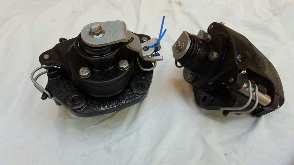

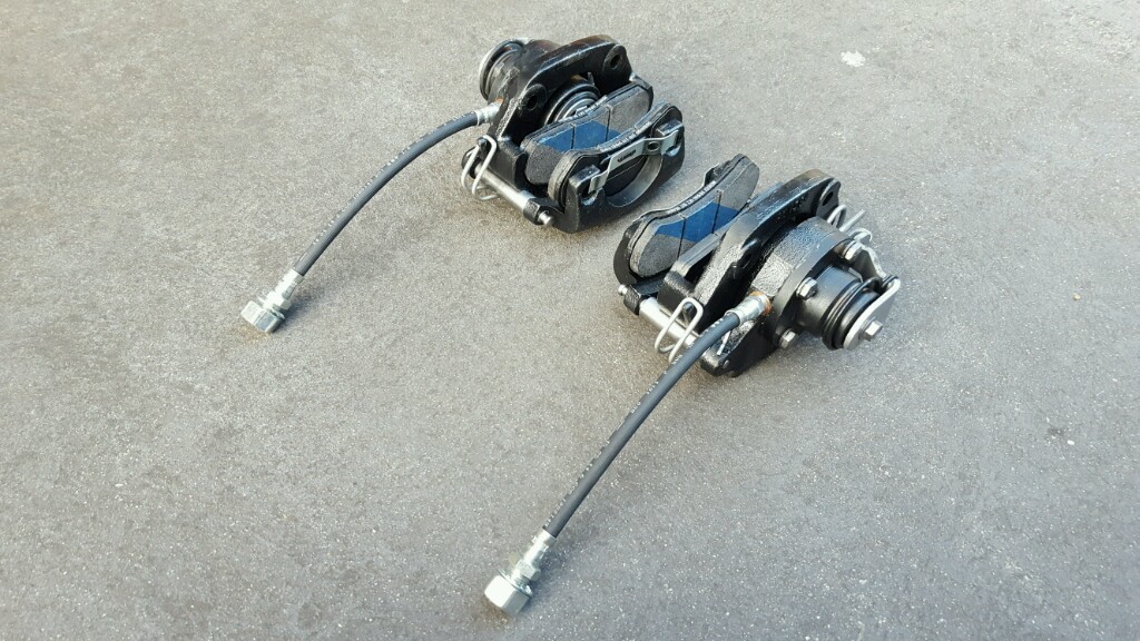

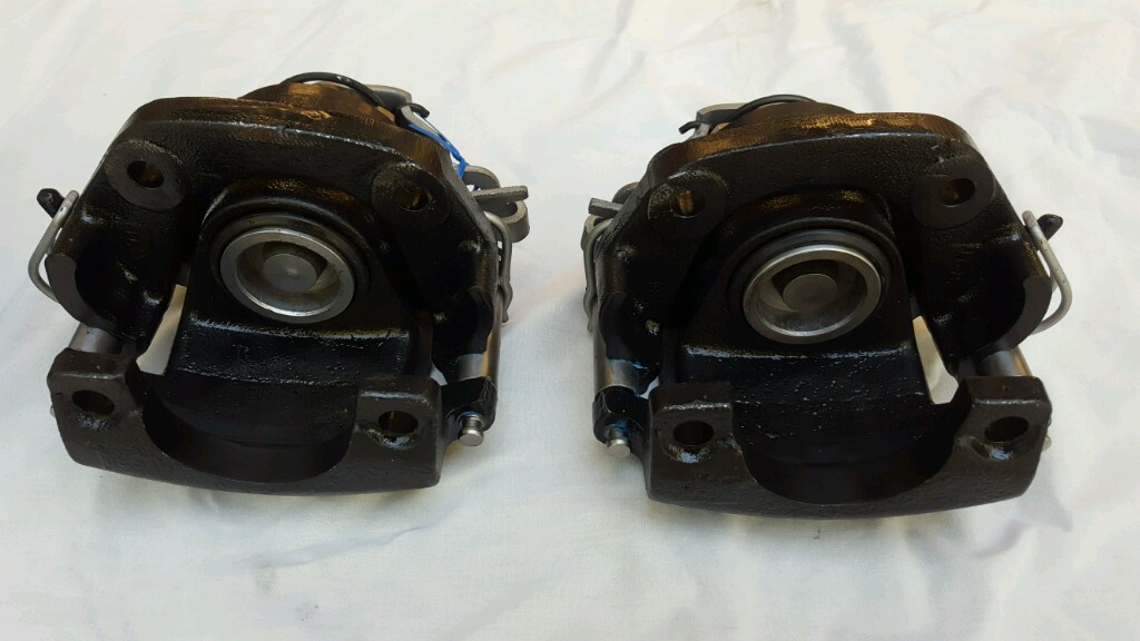

Got the rear calipers back which look pretty good. Now that their done this should go a bit quicker from now on. When I picked them up the guy said they are just about the most expensive caliper they do
At least they should be good for a long time now, they bore out and sleeve the calipers with a stainless sleeve.

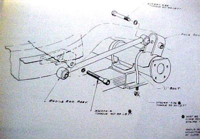

I was hoping to get the stainless lines bent up at the same time but I need the tramp rod brackets to see where and how I want to run the lines. Having a look at the factory lines on a bunch of different cars they are all over the place with no real care taken.

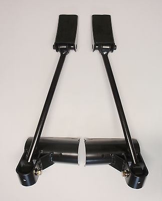

Can't say I've ever heard of a tramp rod before. While it doesn't look like it would be that hard to install it looks like it has some welding involved. I remember you saying at one time that's something you've yet to work with. Have you tried good ole traction bars before. I haven't I just know they are simple to install.

Re: Getting the big Fairlane back on the road.... It drives !!!!
I can't stand slapper bars, lol. And Cal-Tracs are too noticable.
I suppose tramp rod is the Australian slang term as Fords technical terminology is "Rear Radius Rod". Basically they just prevent wheel hop by not allowing the spring to wrap up and unload.
They are super easy to install. The only welding required is the front rod hanger, the rear bracket just clamps to the axle with special U bolts.
I will probably have to make up a custom set of longer rods though as the Fairlanes are a longer wheel base than what they were designed for. This is actually a better option as it allows for more adjustability and the use of heim joints.
This is the set I'm ordering Monday (minus the rods)

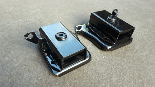

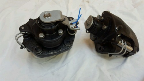

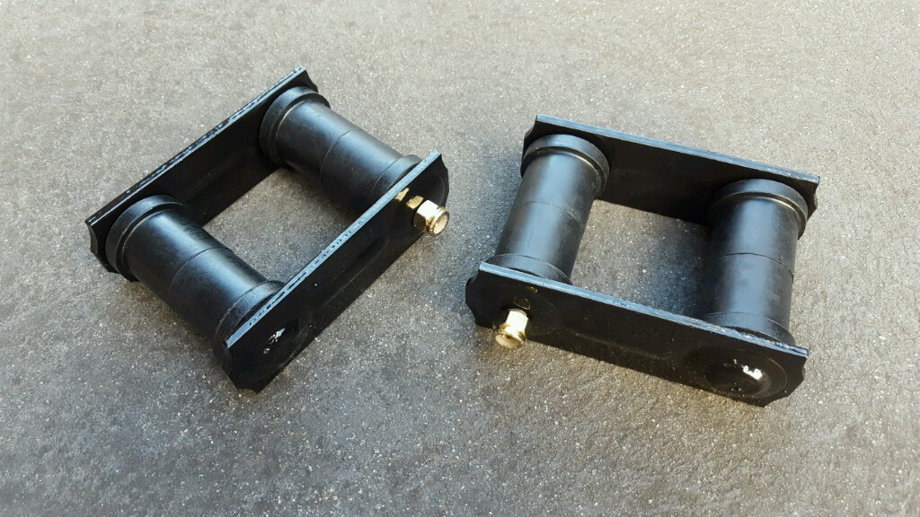

I finished off my shackles, finished off the rear spring saddles, got the calipers ready to mount. Tramp brackets should be here next week so I can bend up some brake lines.
Then all that's left is to rebuild the rear springs and viola !!

Ahh I see now. I didn't look at the picture closely enough to see that sandwich plate that the u bolts hold.
As for them being the correct length. Wheelbase should have no affect. If you can find out the spring length on the car they were intended for compared to yours would be the better way to tell if they would work.

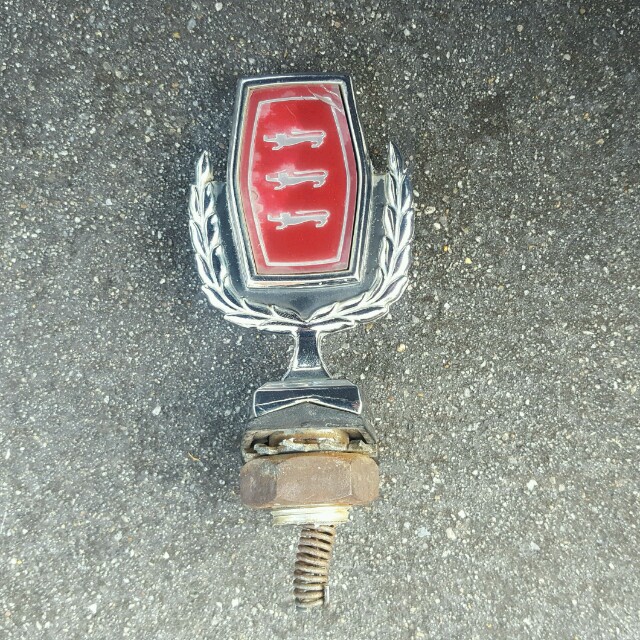

Not as if I don't have enough projects to keep me busy at the moment but I stumbled across a hood ornament locally and cheap. It's not in the best of shape but the plating is perfect.
It will make a good test to try and convert to magnetic instead of ruining a nice and expensive example. Then I can put it on and take it off as I desire.
