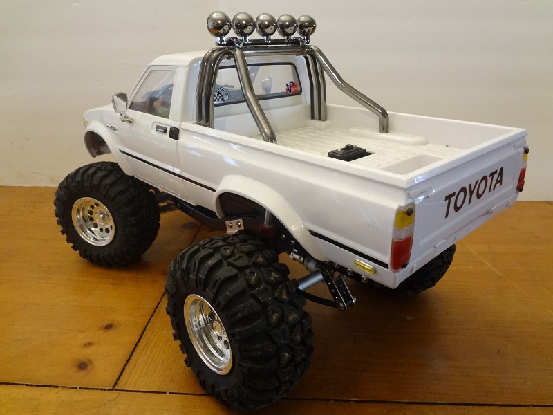

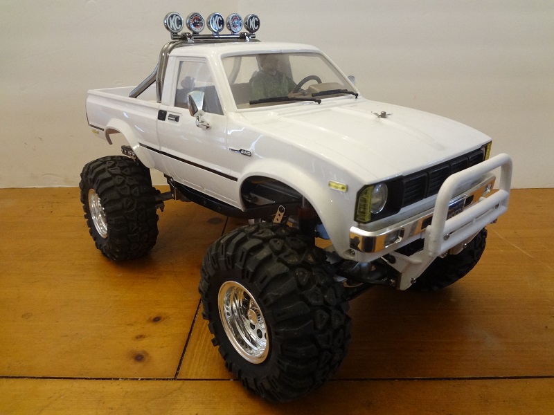

I've been caught up in racing for the last few months and haven't posted much lately, especially on this thread. I have been playing with the truck when I have time. Nothing serious---mostly mild backyard bashing and crawling. There is an upcoming crawler event near me around June that is only for "hard body" trucks and I want to enter with my HG P407. I would like to rekindle the fire of this thread and share some input of the experiences, mods, breakages, etc with everyone who has purchased and been running this truck. Since my last post, I haven't done too much to mine. I added wheel spacers to the front to widen the front track to match the rear (big thanks to Dadio!). Got a decent interior with driver. Modded the stock front bumper (thanks again to Dadio). I'm happy with the performance of the Integy motor and the Hot Racing shocks. The tires are good for all around use and are a huge improvement over stock, but I will be looking at options for mounting some real crawler tires. The esc I'm currently using cannot supply enough power for the protek steering servo I'm using and also does not have a drag brake, so I will be changing that out in the near future. I have noticed a lot of play in the bearings of the input shaft of the front axle. I've heard of bearings failing here, but not sure. I will be addressing that soon. By the time I attend the crawling event, I want to have the best version of this truck I can get and see how it fairs in an event like this.
