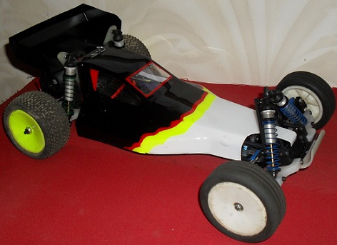

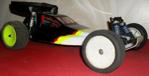

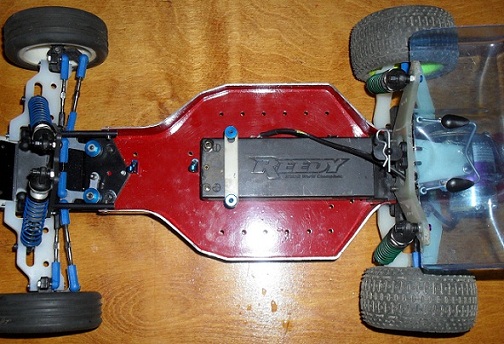

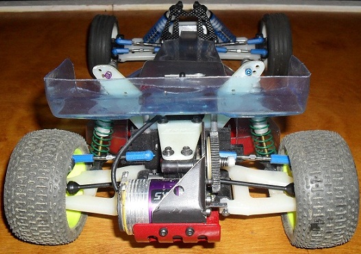

After several months of scrounging parts, my car is done.
Chassis
Truck nose plate
Nose brace tubes
Team car chassis
Associated bearing steering bellcranks
Novak Havoc 10.5 turn brushless motor
Aluminum battery hold down/esc mount
Front
Dynotech front suspension arms
Proline B4 front wheel
RPM "Worlds" front shock tower
RC10T front bulkhead
Associated GT front bumper
RC10 caster block 30 degree
RC10GT extended inline axles
Lunsford Ti turnbuckles
RC10 1.02" shocks, 30wt, green springs
Rear
Dynotech rear suspension arms
Proline B4 rear wheel
Rear B44 CVAs
RC10 0 degree arm mounts
RPM RC10GT rear hubs
RC10T rear shock tower. Modified shock mount location inboard
RC10 1.32" shocks, 30wt, green springs
Modified RC10 Bulkhead
B4 wheel spacers
Custom works .125 wheel spacers
B4 Slipper Clutch
Siebenelch inspired Protech Body
Chassis
Truck nose plate
Nose brace tubes
Team car chassis
Front
Rear
Rear B44 CVAs
B4 wheel spacers
B4 Slipper Clutch

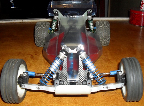

Where did you get the black worlds front tower? Fiber-lyte? Is it graphite?

What ever happend to that dude anyway?Mikeyboy wrote:Siebenelch inspired Protech Body
"Relax. Alright? My Old Man is a television repairman....... Got this ultimate set of tools... I can fix it!!" - Spicoli
Re: ** What's Old is New Tech Thread **
cyclepsych0 wrote:What ever happend to that dude anyway?Mikeyboy wrote:Siebenelch inspired Protech Body
He's busy with Team Durango

My cousin had this on his 10T from back in the day. I told him that I needed it and we swapped. Its just a white piece that was scuffed and painted black.

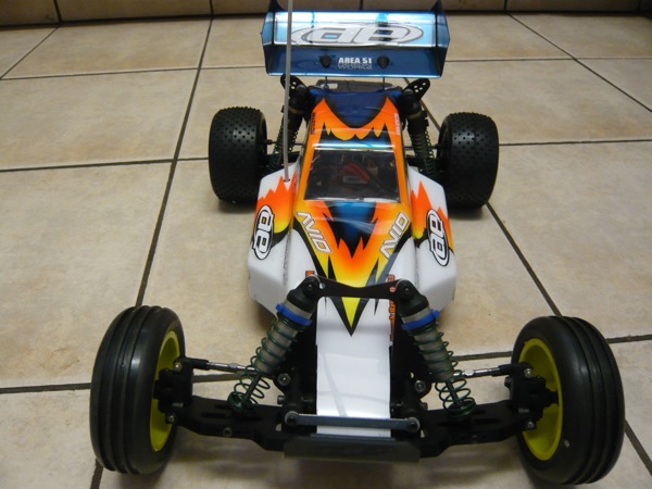

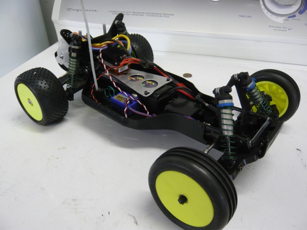

how wide are these cars front & rear with the dynotech/klien arms & truck front bulkhead/nose plate?
i am building some cars and i'm wondering about the widths depending on what rear hubs/spacers & what front castor/knuckle/axle & what wheels are used.
what i have so far on mine is:
FRONT
klein arms/truck bulkhead/truck nose plate
customworks castor blocks
rc10 inline knuckle/aluminum axle/b4 wheels
9 1/2" wide (might be 9 9/16")
REAR
klein arms/rc10t arm mounts/rc10t hubs
b4 cvd bone/ b3 cvd axle/ no spacers/b4 wheels
9 1/2" wide (might be 9 7/16")
i am considering b4 rear hubs to get the b4 bones out of the deep end of the diff halves and more towards the outside of them, and GT wide front axles/b4 castor blocks to even up the front with the rears added width. i am just not happy with how deep the b4 bones are sitting in the diff halves and need some pointers.
FRONT
REAR
i almost forgot to mention how beautiful these cars are!
very nice work!
very nice work!

Sitting level, mine is 9 3/4" in the rear(outside edge of tire).
Its measures 9 5/8" in the front(outside edge of tire). My car does have the extra custom works spacers in the rear.
thank you.
rc10 website has the rc10b4 at 10" wide.
the track i'm gonna be taking this car to is pretty rough and only has 4wd & 2wd truck classes so i'm gonna try to widen my car out some more.
maybe the gt wide front axles & b4 rear hubs will do it?
or get me closer anyway.

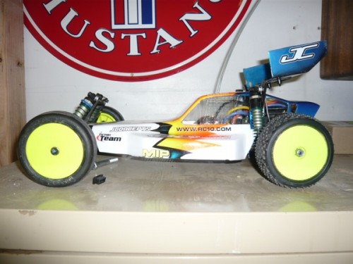

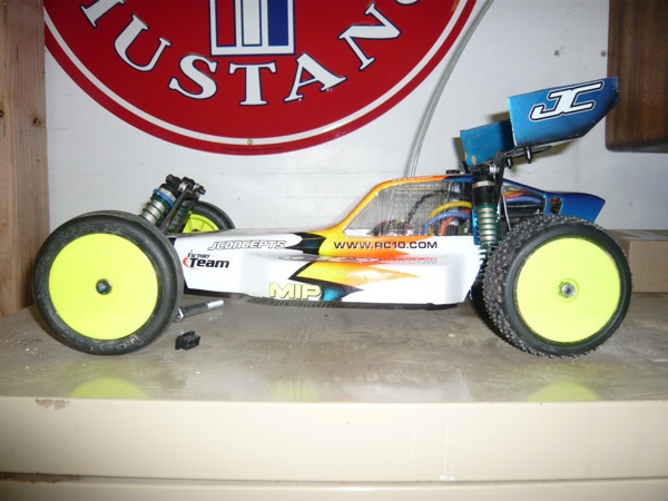

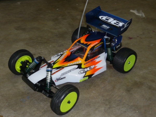

Here's my RC10:
Chassis parts
Truck nose plate
Nose brace tubes
Truck chassi -- powdercoated
RPM Tranny brace
Bearing Steering
Viper body
JC High Flow wing
Front
Dynotech Klein front suspension arms
B4 front wheel
RC10T2 Graphite front shock tower
RPM front bumper
RC10 caster block 25 degree
Inline steering blocks
RC10 1.02" shocks
Rear
Rear B3 MIP CVD
RC10 hinge blocks 1.5 degree
RC10 1.32" shocks
Transmission
2.25:1 Stealth tranny
RPM gear cover
Electronics
Reedy 5000mah 35c pack
Novak 17.5
Novak GTB ESC
Hitec servo
DSM Spektrum receiver
AMB transponder
Chassis parts
Truck nose plate
Nose brace tubes
RPM Tranny brace
Bearing Steering
Viper body
JC High Flow wing
Front
B4 front wheel
RPM front bumper
RC10 1.02" shocks
Rear
Rear B3 MIP CVD
RC10 1.32" shocks
Transmission
RPM gear cover
Electronics
Novak 17.5
Novak GTB ESC
Hitec servo
AMB transponder

2701Klein Front Replacement A-Arm X2(Dynotech) $18.00
2700Klein Rear Replacement A-Arm X2 (Dynotech) $18.00
ASC1779 Associated Servo Mounts (eHobbies) $12.99
Fibre-Lyte RC10-01 (RPM) Shock Tower Carbon Fiber $16.85
Fibre-Lyte RC10-05 Transmission Brace(Fibre-Lyte) $5.53
Fibre-Lyte RC10-11 Battery Strap (Fibre-Lyte) $10.73
RC10GT Steering Bellcrank Blue $21.90
ASC9577 B4 FT Inline Steering Blocks Black $4.65
JConcepts 3306 Rulux Wheels (Rear) White $13.00
JConcepts 3305 Rulux Wheels (Front) White $11.00
RPM 70272 RC10GT Rear Carriers w/o bearings $5.88
ASC7013 RC10GT Nose Tubes Blue $4.13
RC10GT Nose Plate $17.88
RC10 Stealth Transmission w/MIP Lightdrives $59.50
ASC7208 Front Bulkhead Brace RC10GT $1.20
RC10 Wheel Nuts Blue Bean Knockoffs X2 $3.00
RPM RC10 Mini Bumper $2.99
Kyosho Lazer ZX 5 Aluminum Threaded Shock Dampers $24.99
*I ended up only using the rear tower (RC10 03) from this purchase and will save the front one for the next build.*
The Kyosho shocks were an almost exact fit, with only the rears needing any adjustment.
Turnbuckles: It would have been easier to get them seperately:
ASC1405 x2
ASC1414 x1
Would have cost the same amount as the set of 6, and been the correct sizes.
