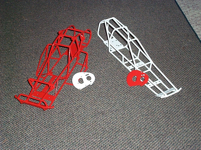

powdercoat is done. gettin' shipped back to me next week.
