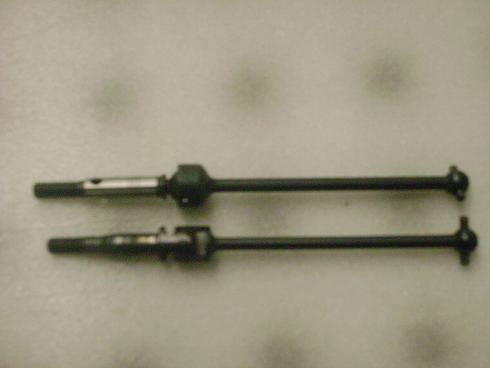

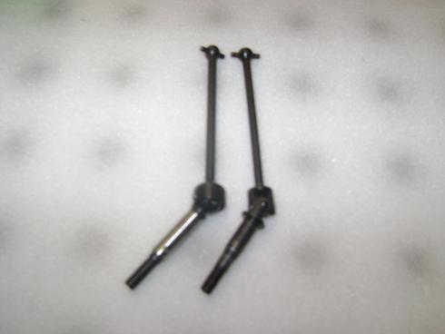

If you want to use the original universals up front, Kyosho USA still has 87 sets of the # W-5061 Universals $30.00 USD. These also fit the entire Optima / Optima Mid series of 4wd's ( Javelin etc.... ), and also fit the Ultima series of cars as well. The rear universals for the Lazer ZX / ZXR W-5063 have just recently been discontinued with no stock available.

I still have the original universals, I just wanted to convert the ZX from the friction/hex system that it has, to a modernized drive pin/hex system, so that I can use modern wheels without affecting the front width...
I'll keep my original bits just in case...

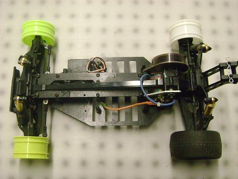

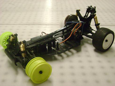

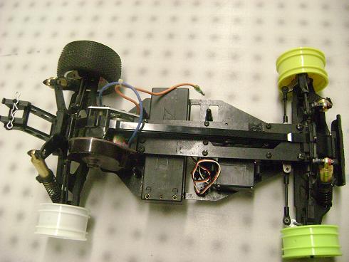

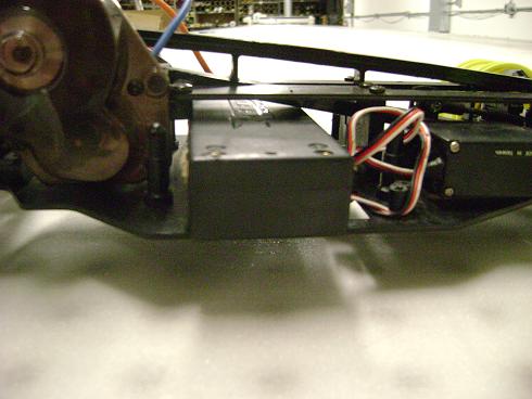

Here are some long overdue pictures of my Lazer ZX. So far, the only thing I've done to it, besides taking the Old ESC out, is add a set of ZX-5 SP 60.5mm swing shafts, Kyosho clamping hexes and Kyosho Mesh Front wheels.
Still deciding whether to dye the rear wheels black or leave them white.
The other pictures show how well a modern Reedy 5000mah Lipo fits underneath the belt guard. I have a set of saddle pack lipos, but I just wanted to show that stick packs fit the ZX very well.
I'm still trying to find out how to replace the old Kyosho Spur gear, with a modern 48p Spur.... any Ideas, suggestions are more than welcome....

- Posts: 616
- Joined: Mon Sep 22, 2008 5:09 am
- Location: Sweden
- Been thanked: 10 times
Re: Kyosho Lazer ZX -- 2010 VONATs Entry....
Back in the days when the first Lazer zx came out the car was designed with optima style wheels in mind and those wheels have the same offset front/rear.
But modern wheels W-5026/5027, 2,2 zxr, zxr MKII, zxr-r and zxs evo wheels have an different of set in the front then in the rear to move the kingpin further in the wheel.
So the solution was an front hub with an extra hole on the inside to widen the car but to do that you will need an longer Front shaft W-5063
And yes they use the same wheels on the Lazer ZX5 cars and as seen in picture you can get those beutiful mesh wheels that was used on the TR15 i know since i use them W-6061/6063.
Regarding The Rear hubs thare are different hubs that fit the car SP 107 ( make sure that you put un 3 mm shim on top ) for example do fit and the SP 107 H ( same just in carbon material ) And SP 107V and SP 107V2 providing different toe in.
You can also fit the 3racing rear hubs for the zx5 they fit i have done that.
For those who need/want W-5063 i can provide some since i have 5 nip sets in the tool box
Otherwise as written before its possible to fit new style LA232 and 231 swings shafts and LAW30 blue clamp on wheel hexes.
On my car i use MIP swing shaft for the PROX they are a bit longer then W-5063 but works fine and they use hexes with pin but i have fitted the LAW30 clamp on.
mvh isobarik
Hey Isobarik,
What about the Spur gear?? what are my options??
I want to run a modern 48p Spur. The one on the ZX is the 48p but the 0.6 module?? I won't be able to use the regular 48p pinions, right??
But when its an 0.6 module its an 0.6 module not an 48ptecnica2001 wrote:Hey Isobarik,
Yeah i know what you mean, Cheap but hard way is to try to find the 48p version of th same spur the TM-7 they dont cost much but are very hard to find.
There is an guy that are making these but they are not finished yet.
The easy but expensiv way is to get the LAW12 and an LA118 its an entirely new slipper assembly and an special slipper plate ( dont know the exactly name for it ) And order a bunch of 100 tooth machined spurgear from RW racing in uk ( this is what i have done ) price on LAW12 and LA118 togheter are roughly 140$ include shipment to us.
The embarising way is to get down on youre knees and beg me to send you an TM-7 but then you will be my bitch for life ....
mvh Isobarik

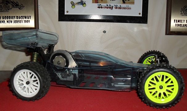

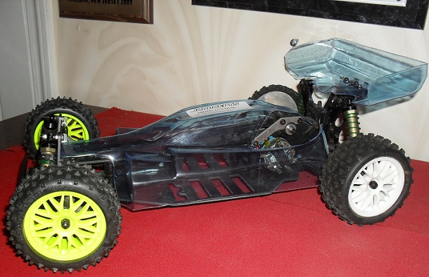

Mounted a JC body and wing on the ZX and it looks pretty good, I'll probably run it like this at the VONATs, the tires will be replaced by more appropriate tires when the time comes.
