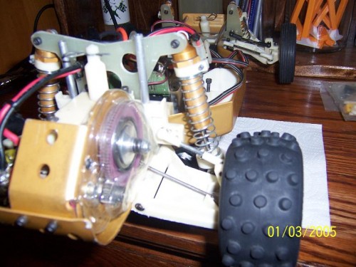

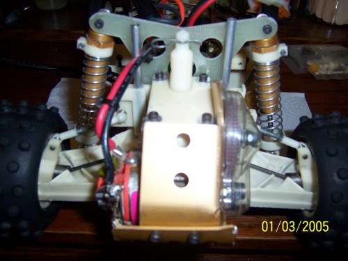

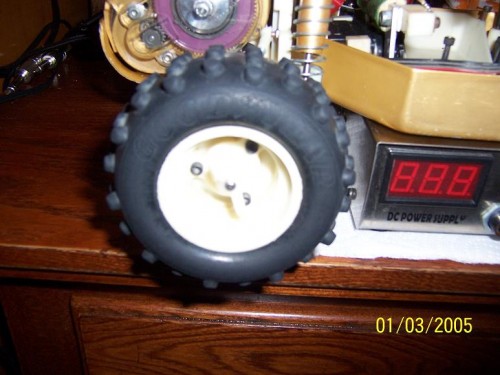

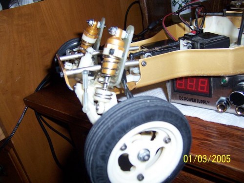

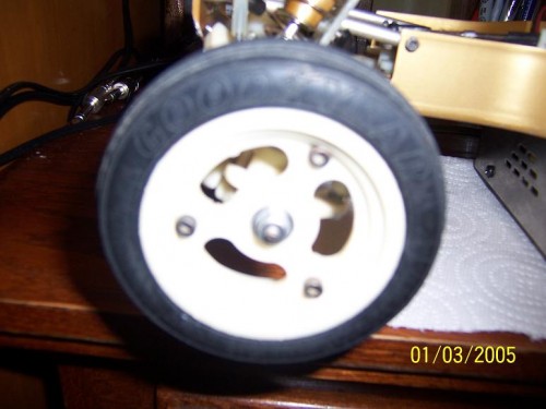

Re: My Vintage RC10 Buggy a hole lotta pics
Post by drillNink »

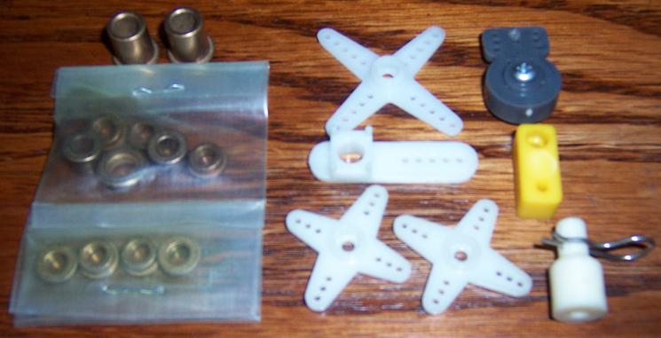

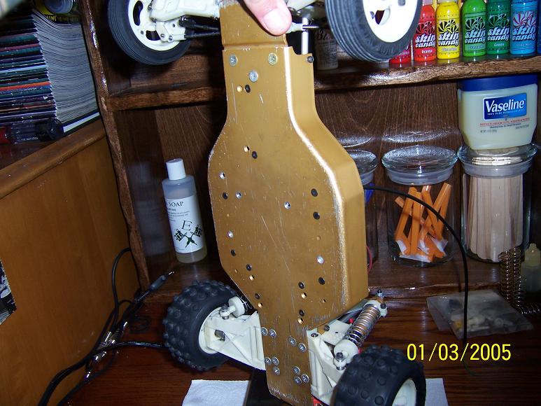

i have sum spare parts some i kno what they are sum not...here they are...
i have the gold and silver...idk what better but for sum reason the car had gold up front n silver in the rear so i kept it that way

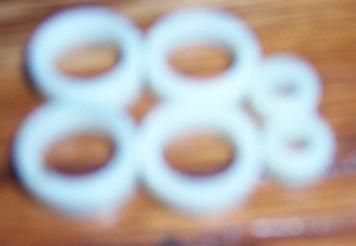

i think these are my plastic bearings maybe????
Plastic bearings.JPG (57.52 KiB) Viewed 718 times
steering parts i think???

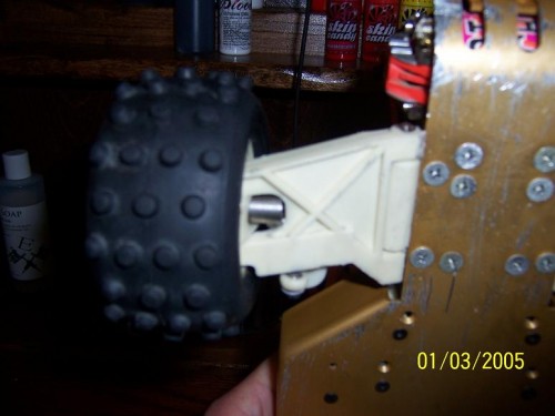

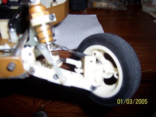

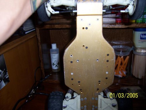

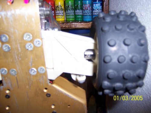

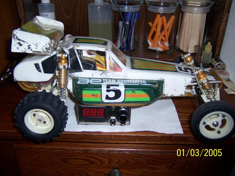

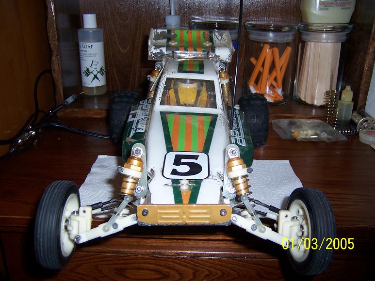

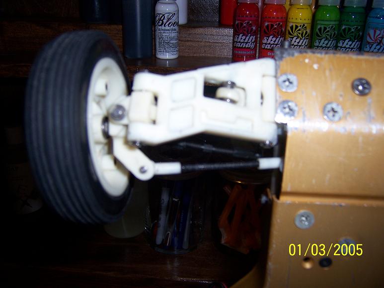

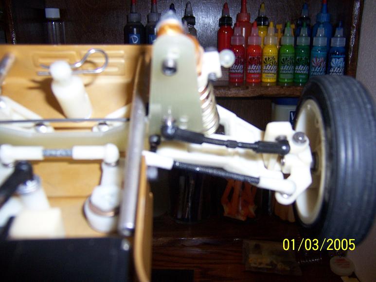

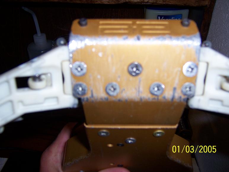

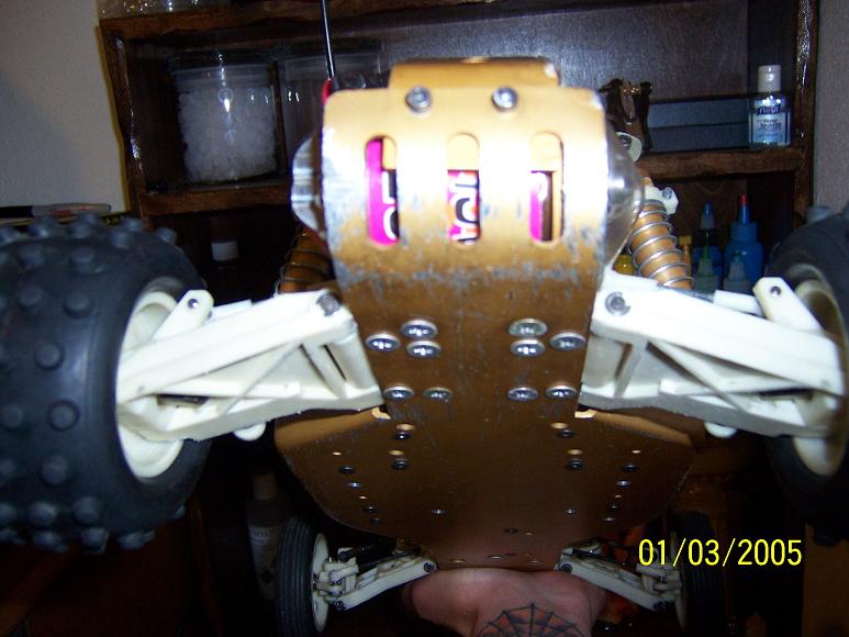

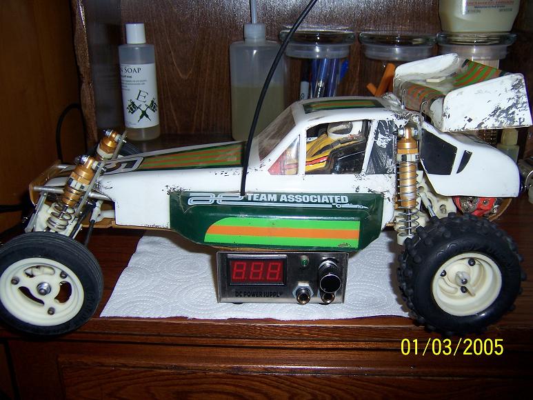

fastang
Posts: 751

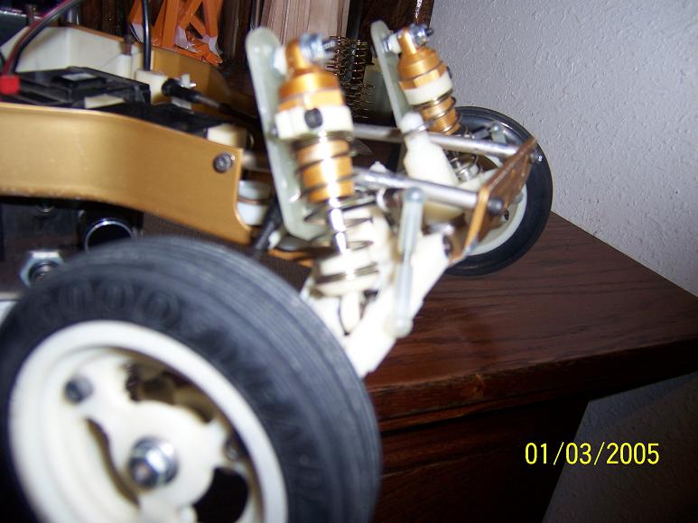

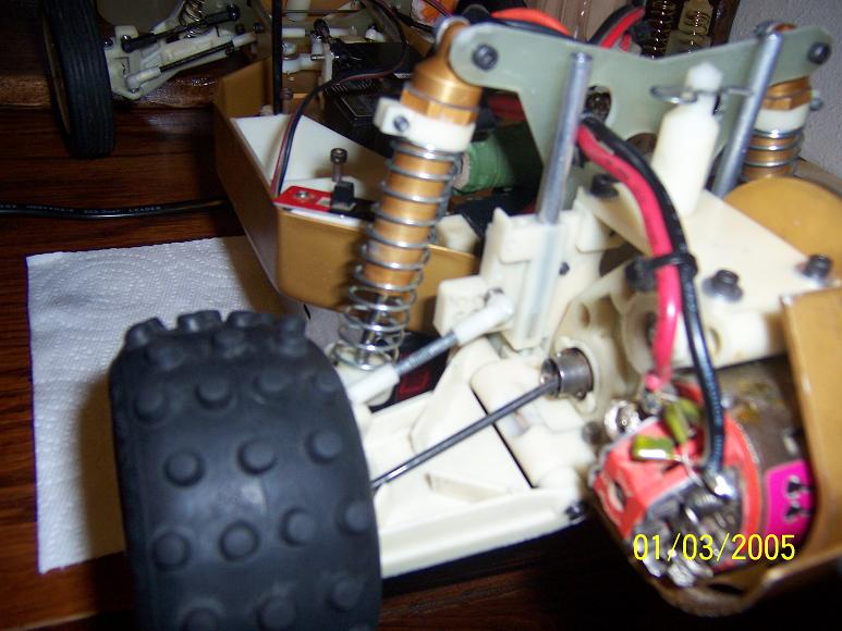

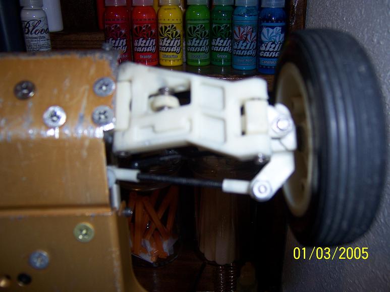

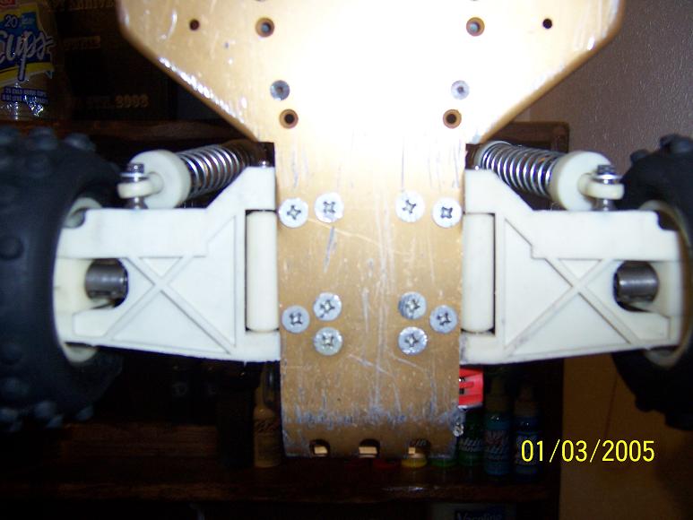

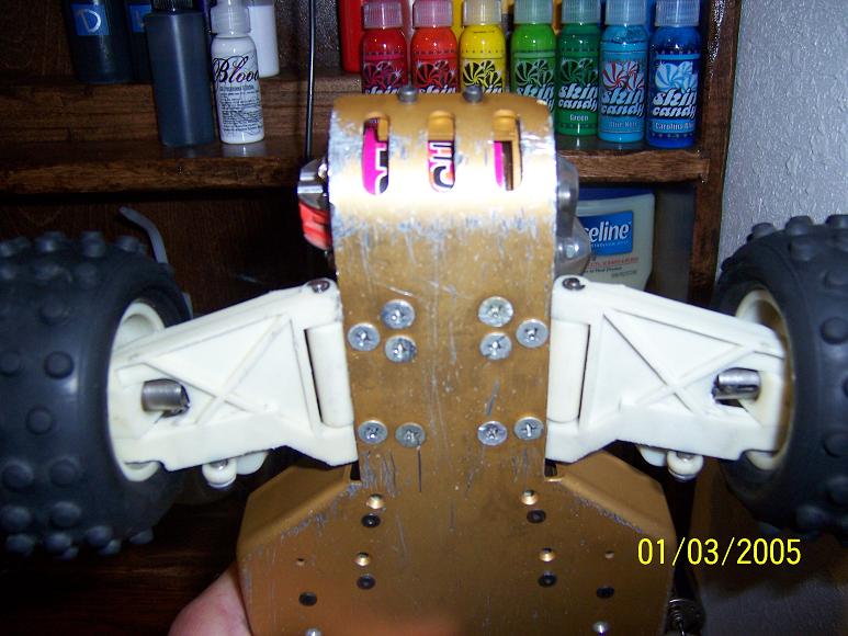

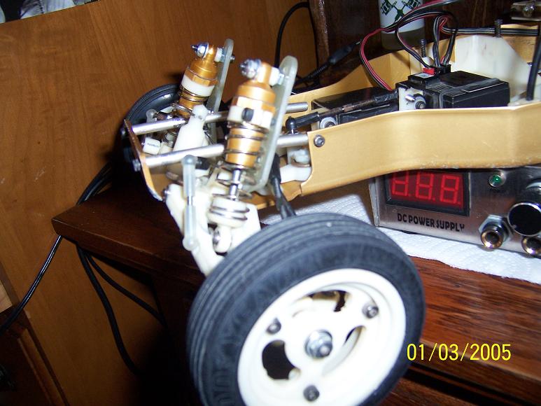

Post by fastang »

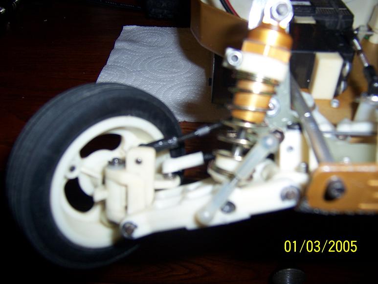

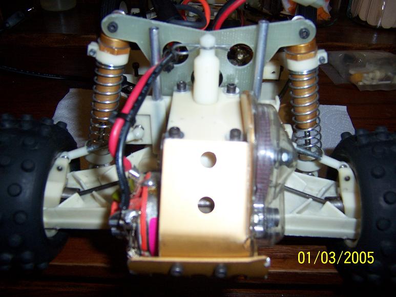

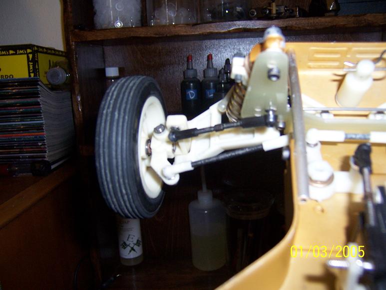

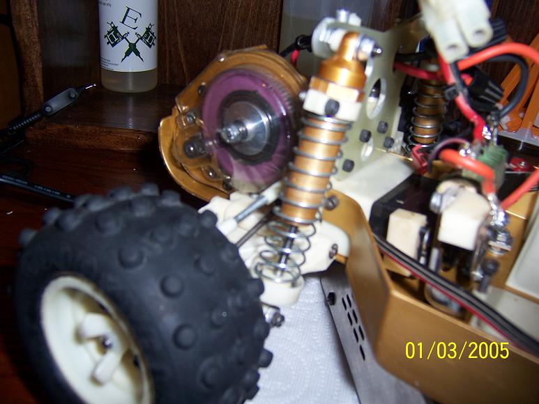

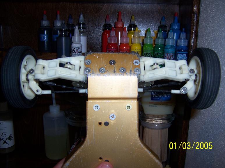

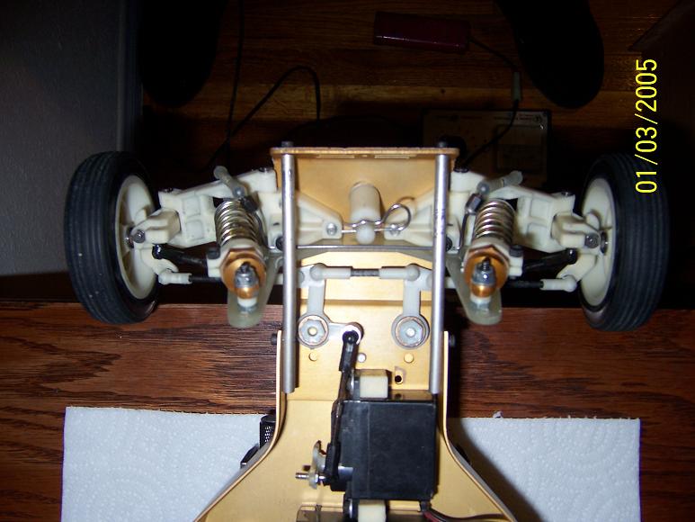

Looks good with some nice patina! Only thing I see incorrect is it has the wrong turnbuckles on it. It would of had just straight 4-40 threaded rod for the tierods. Something you might want to change if you want it period correct. You can usually find it in any hobby shop. If you do change them out be sure not to damage the ball cups, READ(no plier marks!). Those little suckers are worth a mint when you can find them.
I take that back! it has the wrong front arms on it too! Should have the short arms. Did you ever look if there is a stamp under where the tranny goes?

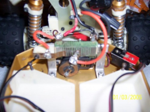

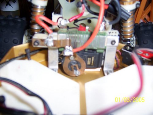

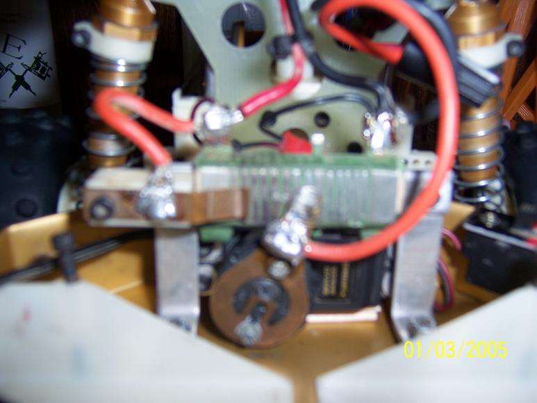

speed control advice please...it only goes when i pull reverse
with age comes a cage

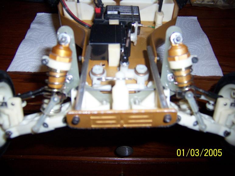

fastang
Posts: 751
Post by fastang »
Upon further review its got some wrong steering gear too. Its almost like it had a complete later model front end bolted to the older chassis. Except it has the correct shock tower :? Weird!
drillNink
Posts: 197
Joined: Wed Mar 31, 2010 5:53 pm
Location: SoCal
Post by drillNink »
yes i did the is no stamp at all

Ruffy
Posts: 879
Location: Orlando, Florida
Been thanked: 66 times
Post by Ruffy »
Flip the "servo reverse" switch on your radio for the throttle servo. See if that helps.
You got an early RC10 there with some more current items like the front arms, and other parts.
Congrats.
drillNink
Posts: 197
Location: SoCal
Post by drillNink »
yes when i flip the servo switch it doesnt wrk at all
Ruffy
Posts: 879
Post by Ruffy »
Make sure you push the switch all the way over. If it is somewhere in between, sometimes they just don't work.
What radio are you using?
You know that speed controller is the Cadillac version one as well.
