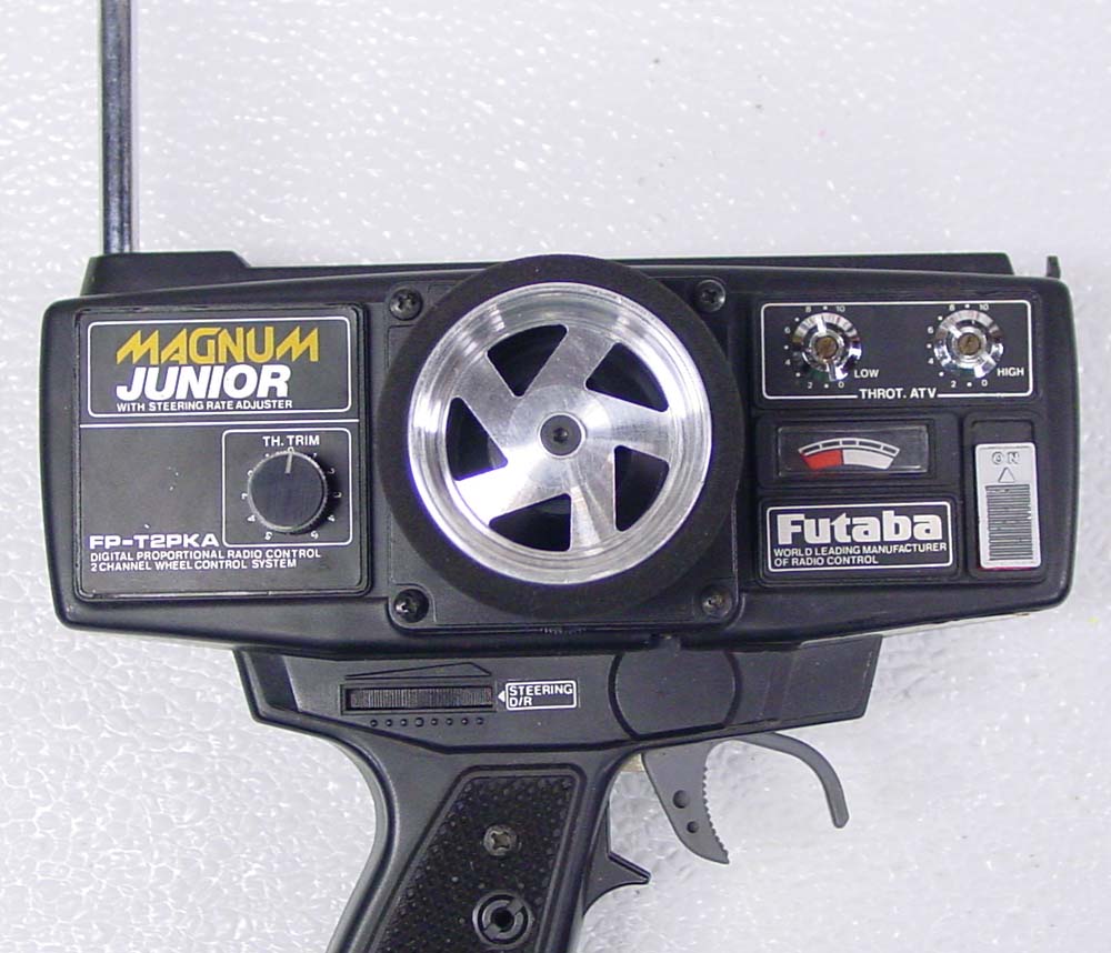

Got a matching sees steering wheel
If I can find a cheap parma flexi antenna and a kimbrough grip, I'll have the TX all hopped-up too.

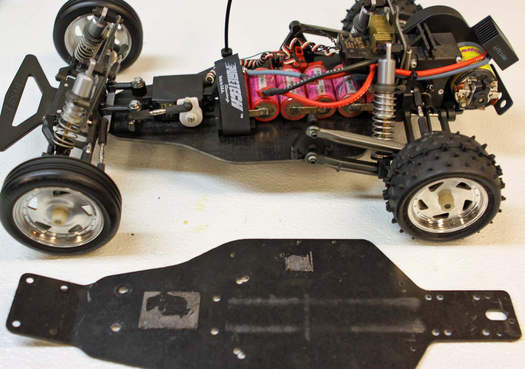

Wow, This car has been sitting on the shelf for 3 years now.
Time to make some changes. in the interval I have gotten a pair of new chassis plates, so I will replace the scratched and drilled one that has been used so far.

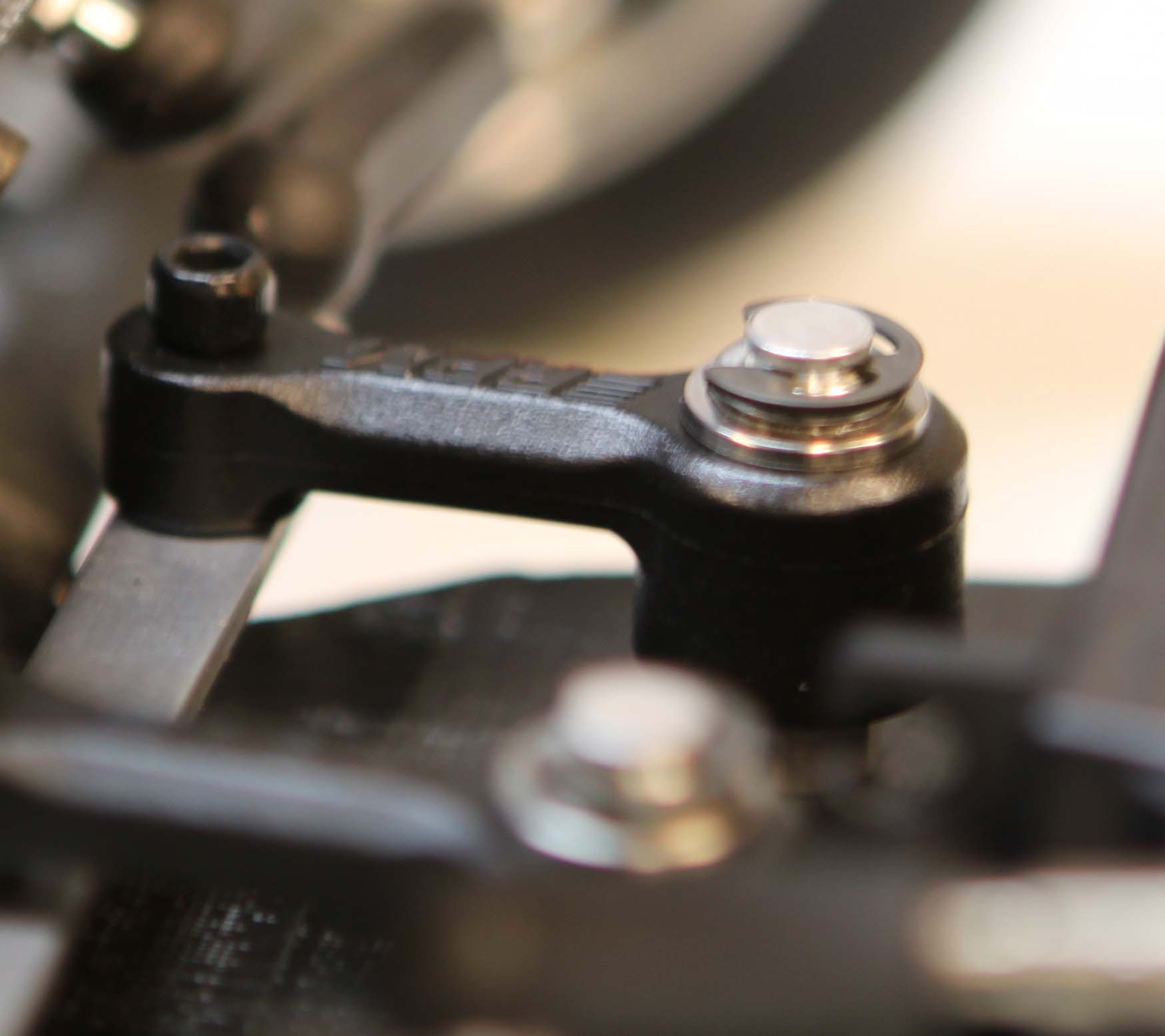

2 of the RPM parts, the steering bellcranks and battery box require drilling.
I do not want to drill a new plate so I've changed it up a bit. The bellcranks themselves were drilled out from 1/4" to 5/16". This allowed me to use the stock losi steering posts and some 3/16x5/16 flanged bearings with a couple shims instead of 8-32 screws and the rpm white plastic standoffs.
Instead of the rpm battery box I have added a NIP pure-tech battery strap.
The side links were some of the only used parts on the build, so I replaced them with new ones.
back on the shelf it goes.
