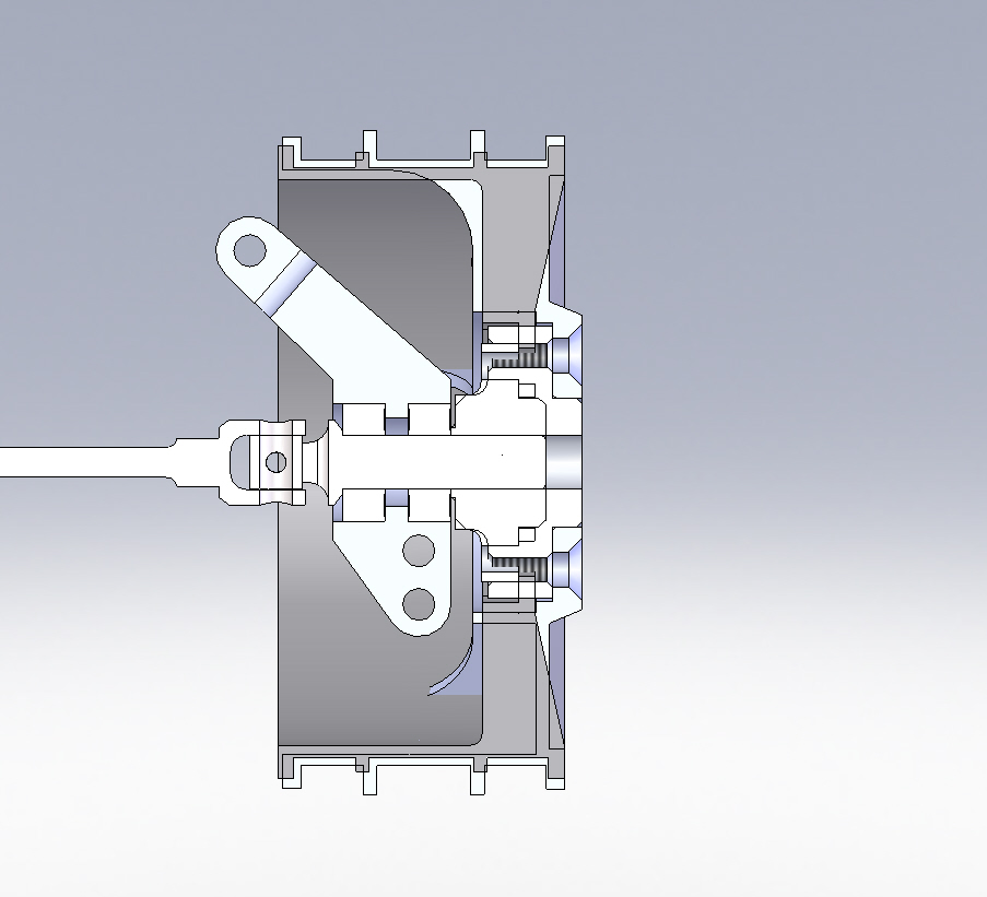

Thanks, it's what i do for a living. I know this post with be hard to seperate out the out hub and old rim compared to the new stuff. But I wanted to make sure the newer rim and new hub I designed would yield the same offset as the old ones. Here's a cross section thru the hub/axle/rim. You can see the old rim is smaller but slighlty wider then new 2.2 rim.

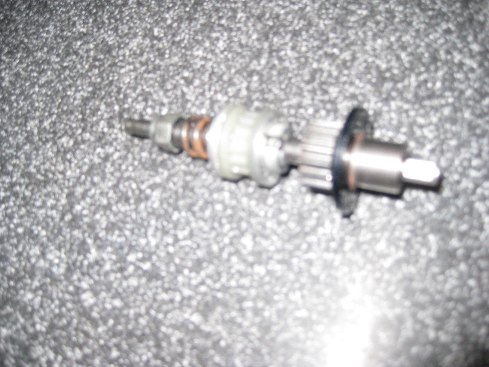

Finally got to take some pictures. Please let me know if this really is a 91 works or some hybrid.
These are the rims that came with the car, but they are 2.1 inch so I won't be using them.
91 works I think
91 works I think

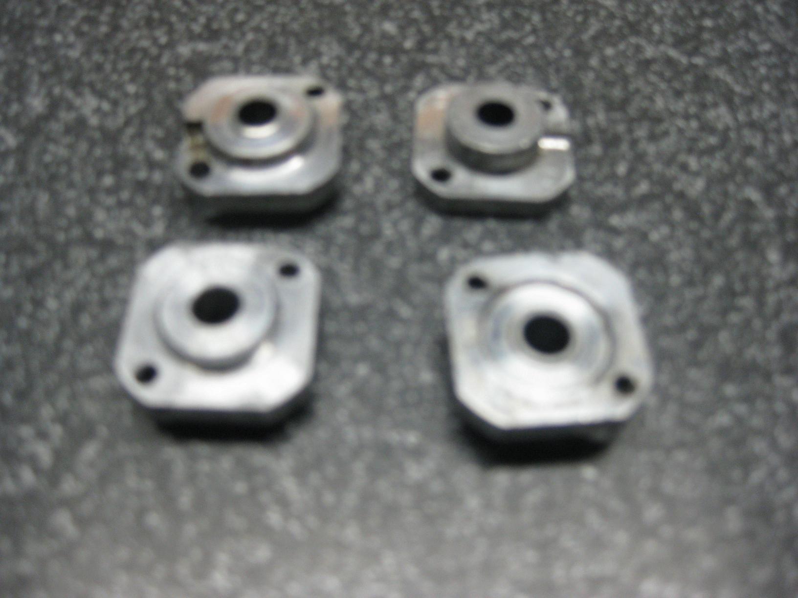

Bad picture, but can you tell me which hubs should be on the car. I think the one with the lip so the bearing doesn't rub. I got three of those and two of the others.

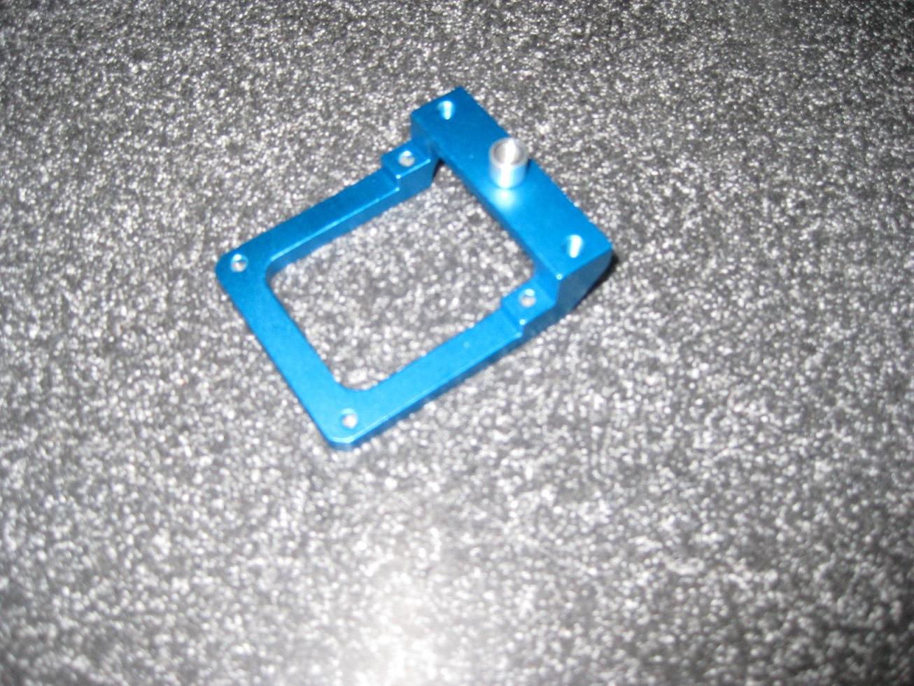

I'm glad to get the spur gear adpater. What do I start with for spur and pinion for 17.5 turn brushless small indoor track.

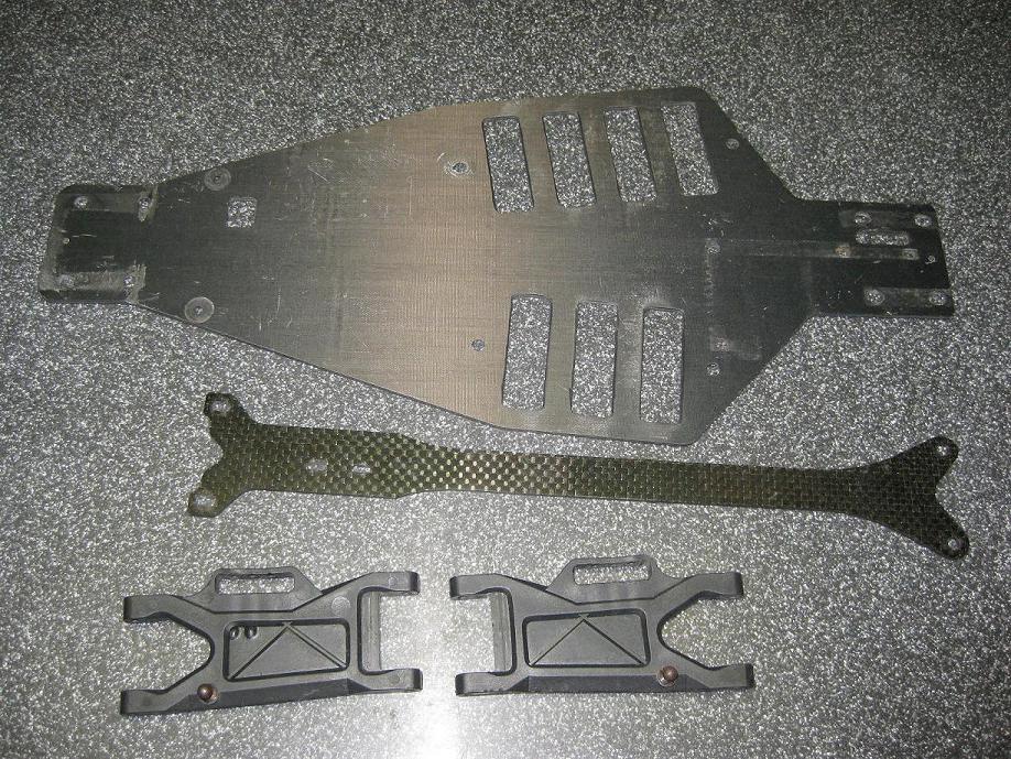

Chassis is is really bad shape, I couldn't see that from the assembled pictures. I'm going to make another one. Top deck is ok, so are the rear A-arms

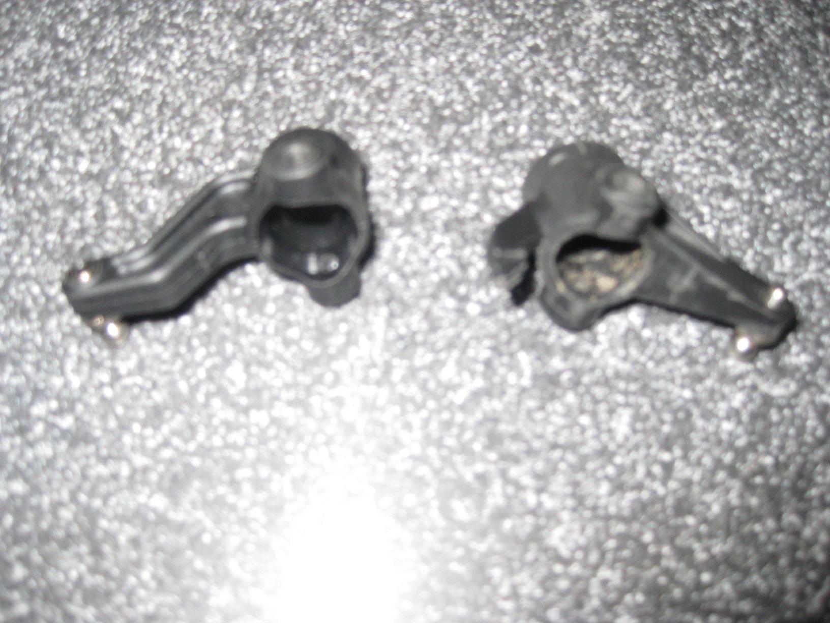

Two different steering blocks

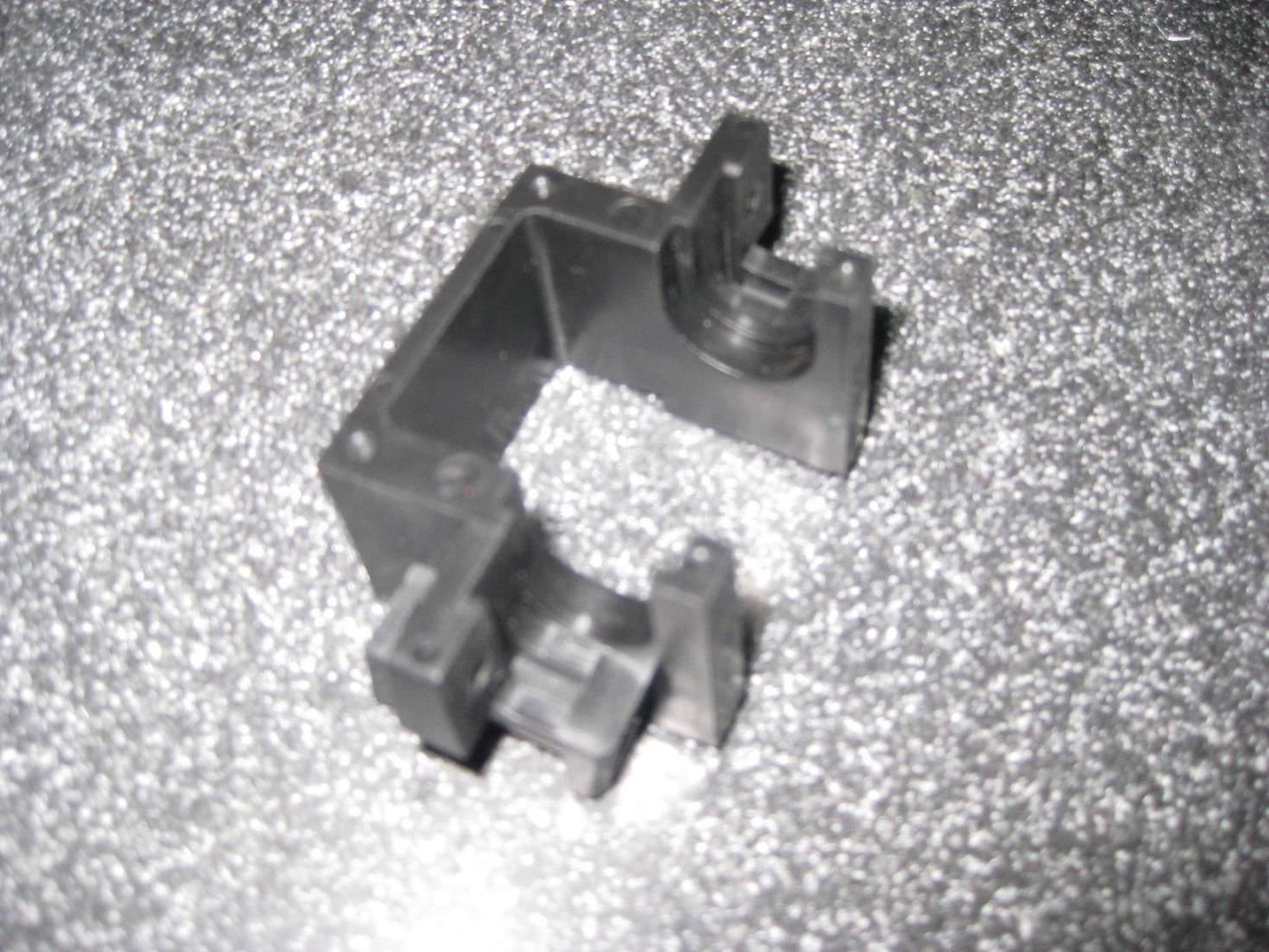

YR4 plastic front bulkhead
91 works I think
91 works I think
Is this a YR part also or is this Integy?

Black wheels from Works 93.

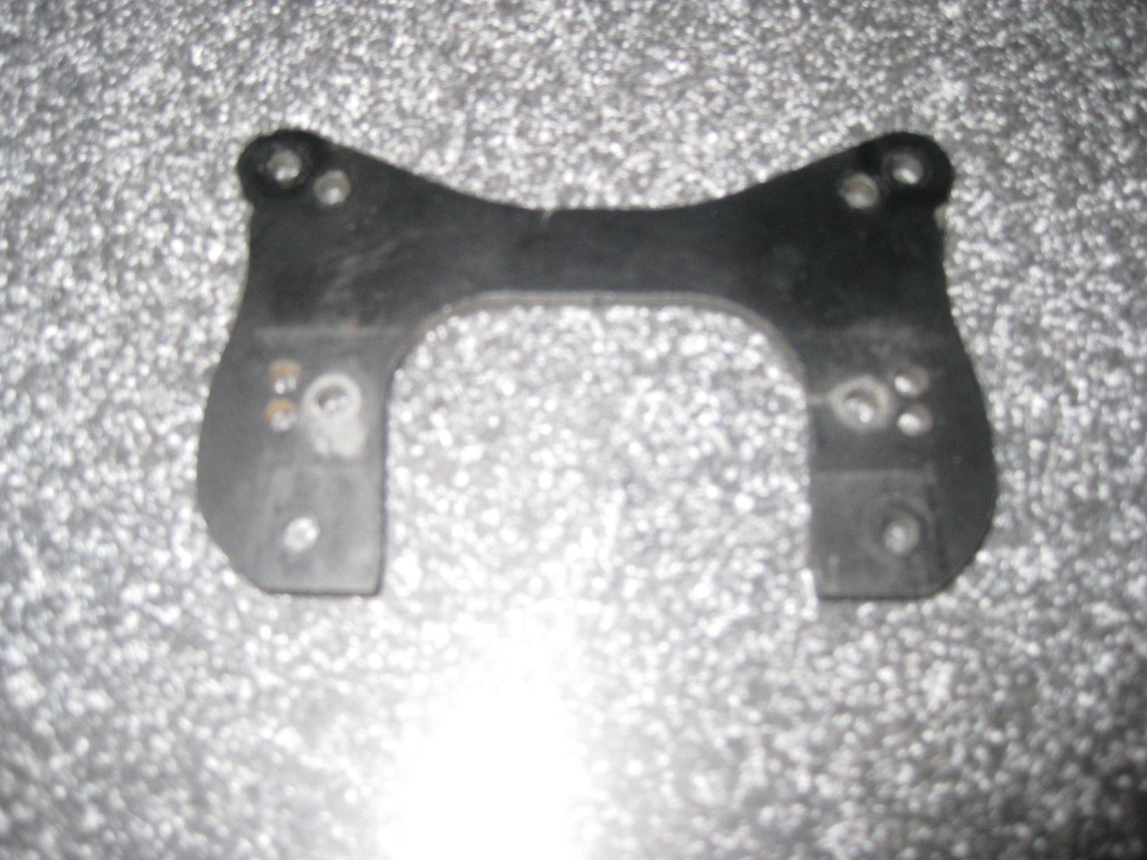

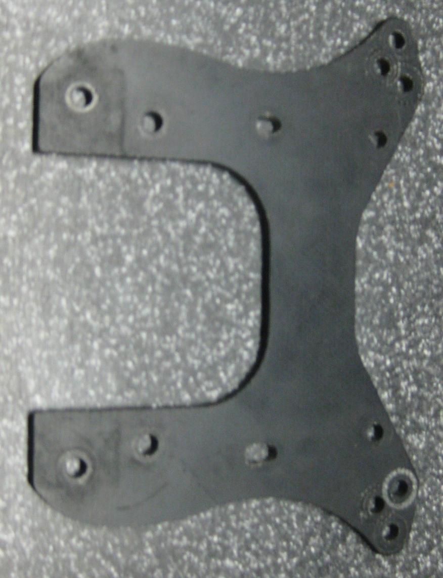

Front tower seems to be hand modified works 91
Rear tower from works 91
Wheel adapters, difficult to say
Chassis works 91 design, material ?
Top deck, tuning part
Plastic black front bulkhead YR4
Hubs, Works 91 & 93

Chassis is carbon top and bottom layer with a white (assume fiberglass) middle.
Why do you say front Shock tower is modified?
