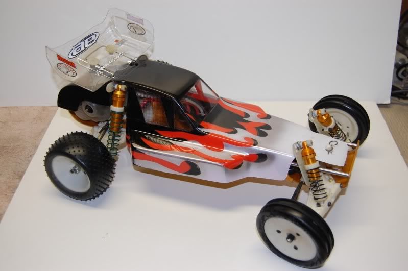

I just noticed this one you got going now, you are putting together some nice buggies. Good idea to fix the bell crank problem.
- Ruffy
- Posts: 879
- Joined: Mon Jan 11, 2010 6:49 pm
- Location: Orlando, Florida
- Been thanked: 66 times
Re: Goldie into Runner Build #2 - Stealth edition
Very nice !
I am not certain but based upon that picture and angle I think your 1st pic of the caster blocks might be 25 degree ones (not 30 per your question).
They look like mine, and I know mine are 25 deg blocks as they came out of a new package I had.
Yours may be from top to bottom, 25, 20 and 15 deg blocks.

So I am saving the chassis wrap for now...it wont go on either car, but I did get the body and trimmed it out...here it is on this car:
I'm going to pick up a mirage next. I like the Protech, but with 2 buggies, I cant have the same body on both

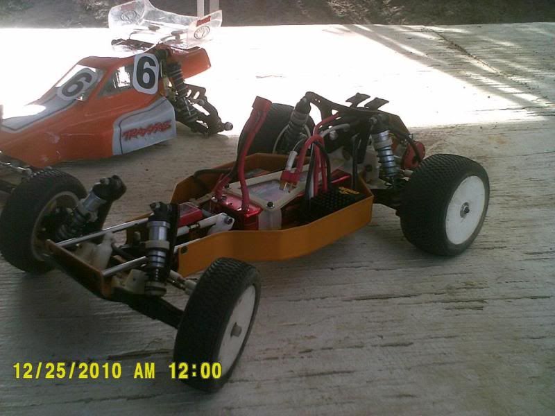

Had a blast racing tonight. Been a long time since I put the goldie onto indoor high bite clay. First time ever since I went back to all stock arms/hubs/wheels. Mounted up some clay compound tires and tossed it on the track.
Electronics on the car have come and gone, been robbed for other cars/project and such.
But currently running this:
Futaba 9401 servo
FlySky GT3B radio
Novak Tempest Pro speedo
Trinity Speed Gems Titanite motor (15X2), geared 20/87
Pretty sure I am running #2 pistons all around with 35/30 or 40/35 (dont remember which)
Here was my problem, push entering the corner (unless nailing the brakes). But great steering mid corner/exit (thinking too heavy/lite of oil).
Black springs up front/Green springs rear. Pretty much standard basic set up that most run for shock positions (middle out up front, inner top-outer bottom on the rear). Camber links in standard CE long positions.
couple changes I was thinking of to make the steering more aggressive (needs to rotate more, without loosing rear sidebite):
take 1 limiter out of the rear shocks (barely any down travel right now)
Try 30/35 (rear was slapping hard most jumps)
Maybe shorten the rear camber link (to the Ruffy/Worlds mid hole on the bulkhead)
Second issue, because of the rear slap, the back end became unsettled really easily.
If I could calm down the rear, get the car to rotate, keep the old brushed motor running fine and slap in a nice freshly charged lipo, I would be giving heck to those plastic cars.
