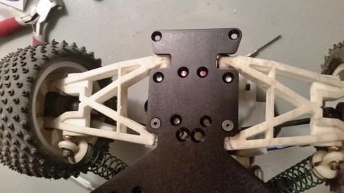

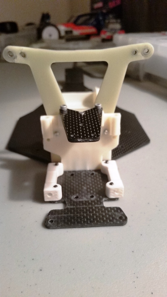

Just ran into a difference in hole pattern with respect from the early CF chassis and the latest aluminum chassis. The rear arm mount hole aren't lining up. The holes seem to be closer together front to back. My solution is to screw in the front and ream the rear holes since those screws will have nuts on them.
Any thoughts?

Re: VAE's 91 stealth replica & runner V2
Post by Niki »
Hi Anthony, check this out...
CNCrc Business Section:
"Please be aware, if you purchased one of the original run kits, a small change was made after seeing chassis failure (broken chassis at the rear arm mount due to screws pulling through the Carbon Fiber) from on of our racing members. The rear arm mounts and chassis have relocated screw holes to keep chassis failure down. This change was made to strengthen the rear of the chassis but retain the the factory appearance for those of you wanting to build replicas. If you plan to run this chassis, it is highly recommended that you opt for the race version of the rear arm mounts as it eliminated chassis failure.
Those who purchased a Nix91 from the original run, can still get the ream arms mounts needed for that chassis at Shapeways."
Look at the assembly drawings for part numbers. Old and new.
-Niki-

Oh, yeah that makes sense Niki. Thanks for making me aware of that. I wasn't up to date on my reading and just figured everything was the same. I'm just gonna ream the holes and be done with it.

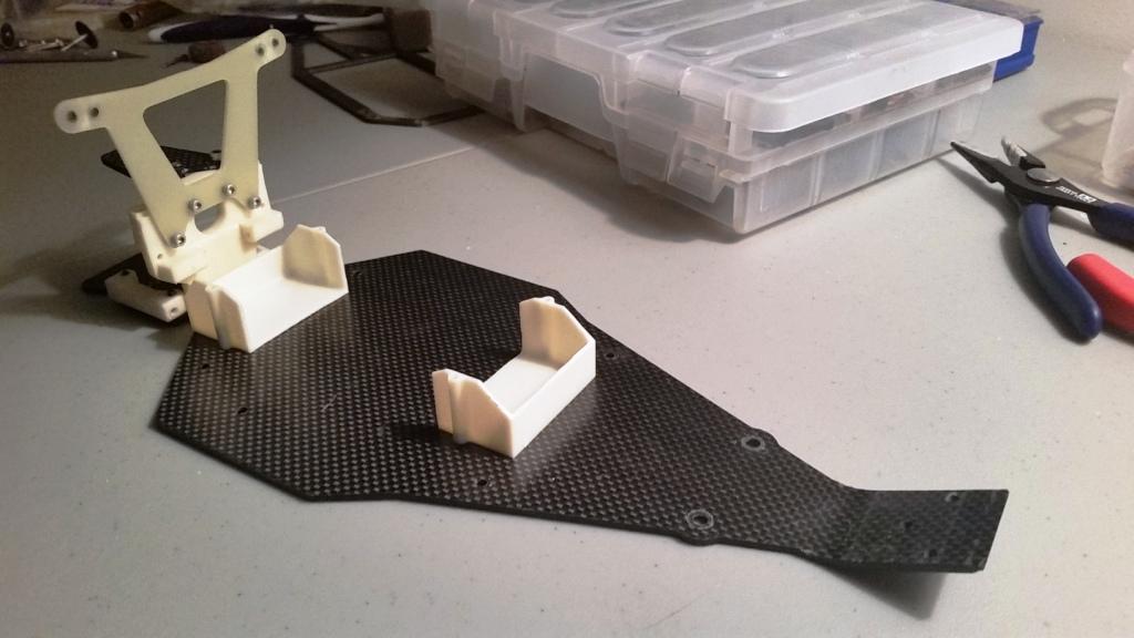

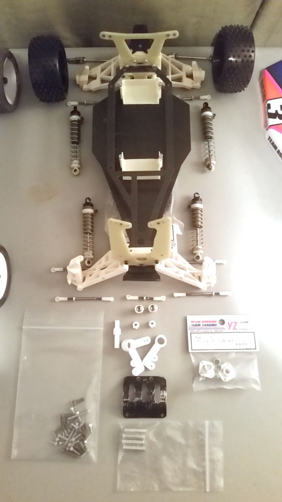

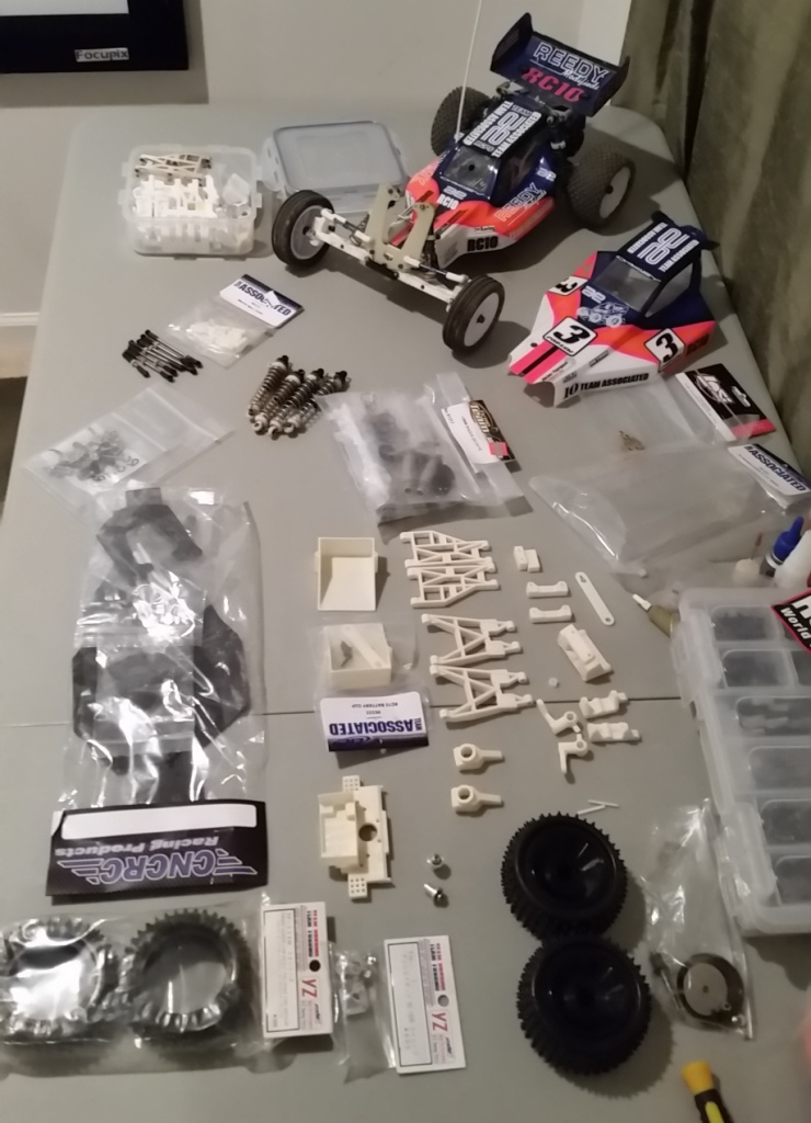

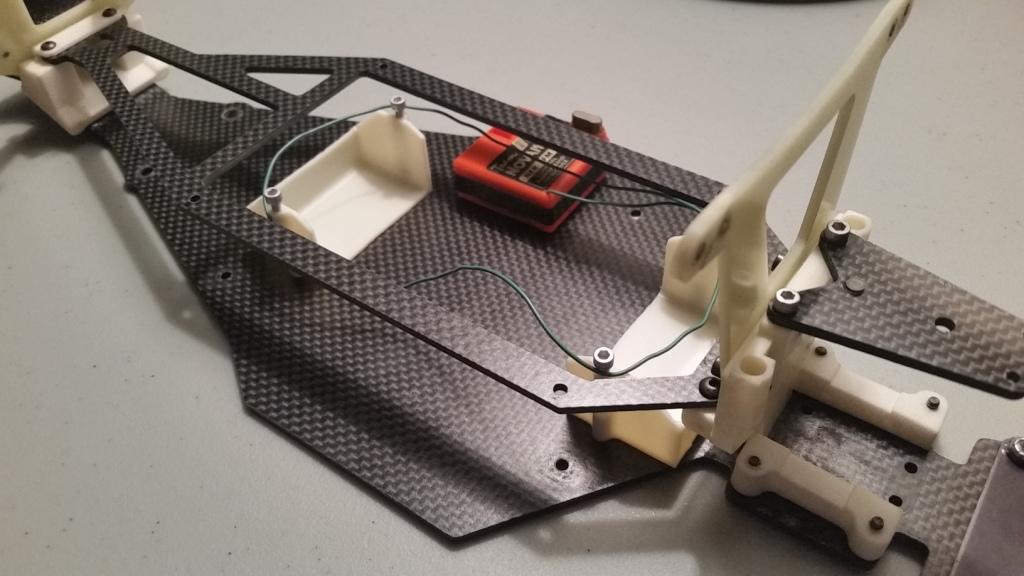

I thought I'd post an update now that I got the rear bulkhead and battery cups trimmed up. This build will likely take the longest of them all since I have a long list of parts to get yet and some of which may not be readily available.

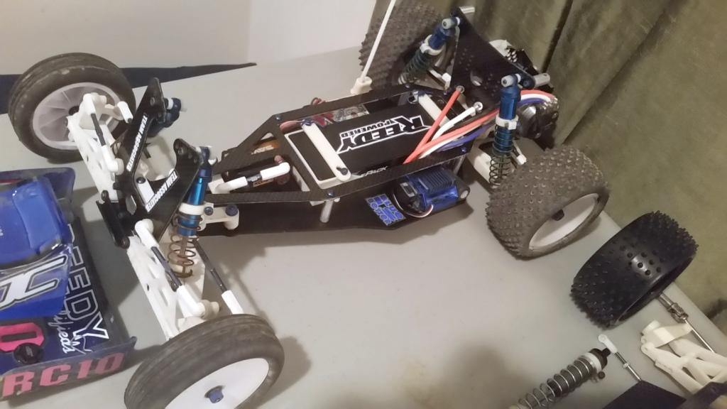

I also got my CF parts' edges glued up for my runner and the chassis kit installed. I'm thinking of keeping the blue shocks on for now, but might spring :mrgreen: for the SC BB shocks someday.

Rear arm mounts on replica chassis are pointing in wrong direction.... :wink:
vintage AE
Posts: 3012
Has thanked: 29 times
Been thanked: 36 times
Post by vintage AE »
Niki wrote:Rear arm mounts on replica chassis are pointing in wrong direction.... :wink:
took long enough for someone to say something :lol: :D gotta keep people on their toes when I get bored.

Since nobody caught the other mistake, I'll point it out...I didn't trim the bottom of the rear tower narrow enough. Good thing I built one of these already :lol:

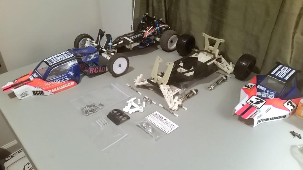

Mocking things up, I've came up with a list of parts needed to complete (what I think will complete it) the build
  • Copper springs
    Homemade battery strap
    Novak 410 M1c esc & micro NER-3FM Rx
    Airtronics 151 servo
    Red Sanyo cells SCR 1400 packs
    Stealth Trans, white with black motor mount
    Front White dish tq wheels
    10t steering hardware
    Ti pins
    Ball studs
    Universals...I have shiny, but need black
    Black antenna mount
    White shock bushings, associated?
    Shock screws
    White nylon nuts
    Front axles (not sure which where used)

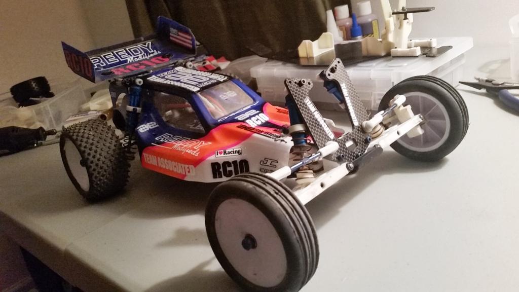

Here is what the runner looks like. I'll get some better pics out in the sunlight once it warms up.
