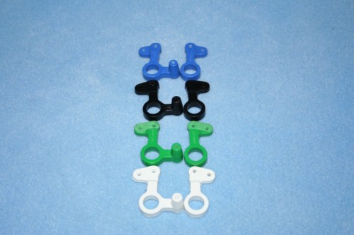

HOUGE steering experts, HELP....the center link hits the tie rod? I may pull the Losi steering out of my other car while I find a solution for this issue:

JK Racing wrote:more front end work:
Can you move the tie rod to the outside hole (Shock Tower) to give you more clearance?

Do you have washers under the steering bellcranks? if you do take them out. I use AE short black ball studs on the front end too, they give just a little more room.

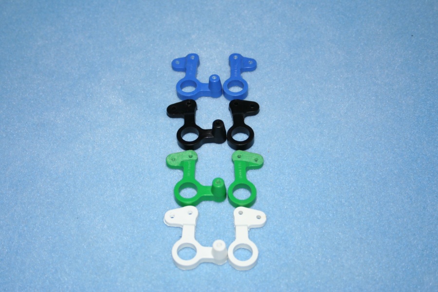

JK I use the 2nd generation Houge bellcranks that have both ball-end mounts at the same lower level as the outside balls on yours. You have the 1st generation ones. I believe this mod to his molds was done precisely for this reason.
You can see in this image from top to bottom how the belkcranks evolved the landings for the ballends.
You could file yours down until you clear the shock tower ball ends. I wouldn't change the location of those ball-ends on the tower as it changes your geometry.
File or grind the high side down until it looks like the white ones in this picture.
My 2nd alternative (and backup) has always been to use the stock buggy bellcranks, I just add two small zip ties to squeeze the bow against the driving unit part that connects from the servo. I used the stock ones recently once again without any problems, until I found my 2nd generation Houge bellcranks, bearings and threaded tube bodies.

Ruffy wrote:JK I use the 2nd generation Houge bellcranks that have both ball-end mounts at the same lower level as the outside balls on yours. You have the 1st generation ones. I believe this mod to his molds was done precisely for this reason.
I thought I had read that, thanks for the tip. I will pull them off and attack them with the dremel. I know moving the camber link location would be the answer on a shelfer, but I plan on tossing this around the track and having fun (I would say be competitive, but I know how I drive).
I need to pick up a couple "mini" nuts for underneath (one of the outside holes is stripped), then it will drop right back in. I have a set of stock steering, already with the zip ties on there (I remember that from BITD).
