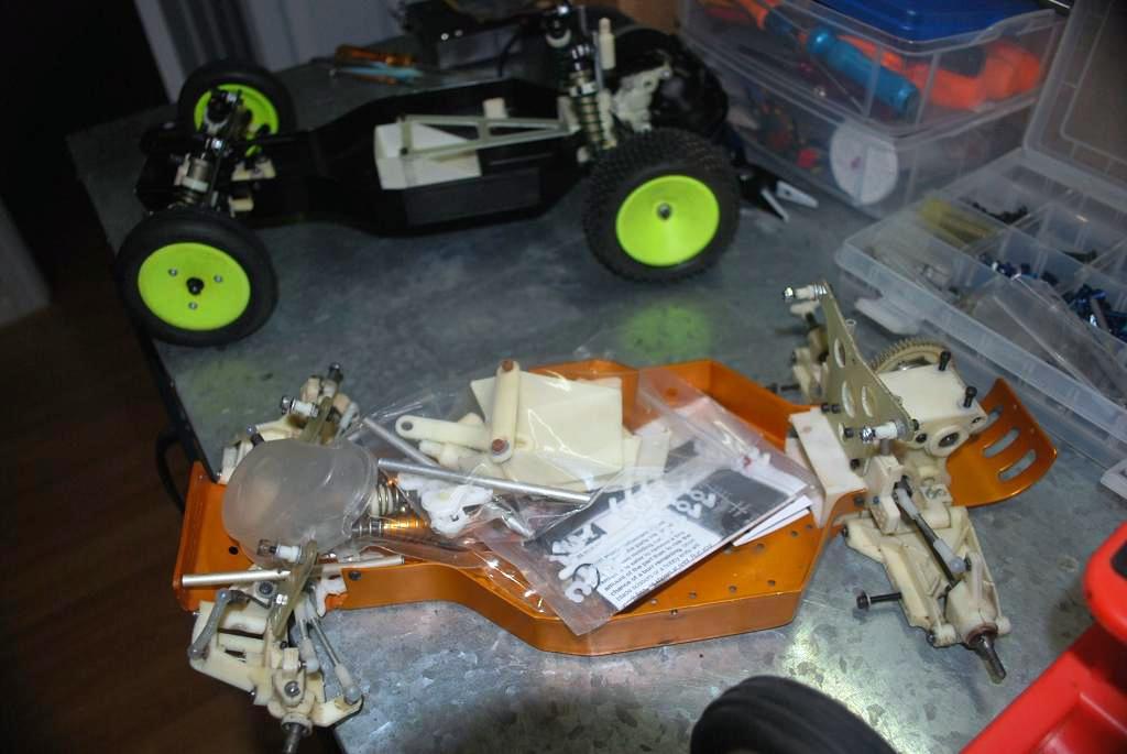

lol, that is my work office, which isn't that much fun, BUT there is a futon in my hobby room for a reason

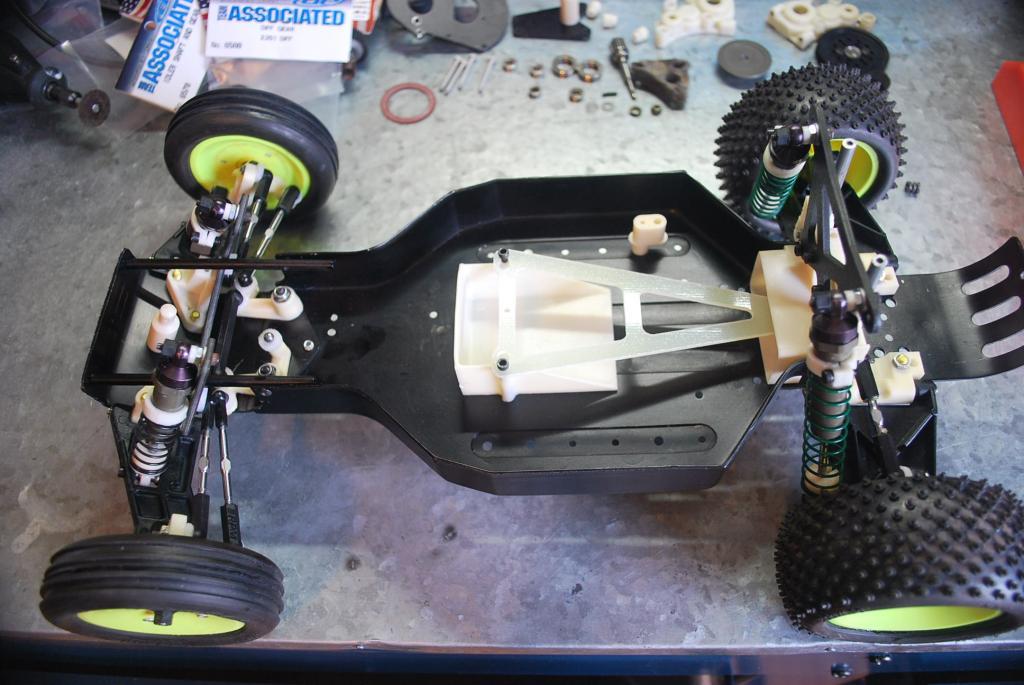

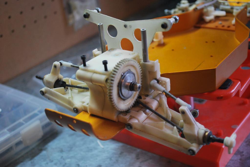

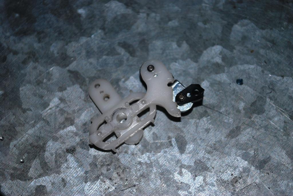

And now its TRANNY time
I think I can find a new slipper pad at the LSH, if not I will sand the surface a little bit to freshen it up.
I might keep that tranny case for a shelfer, the old one is in great shape. I only paid $8 and change for it any way.

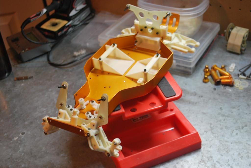

Here is what this thing looks like cleaned up so far. I had to use Associated ball cups on the inner turnbuckle sides in the front to allow for clearance of the longer MIP bellcranks. I used RPM cups everywhere else.

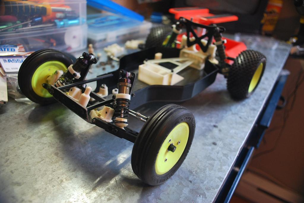

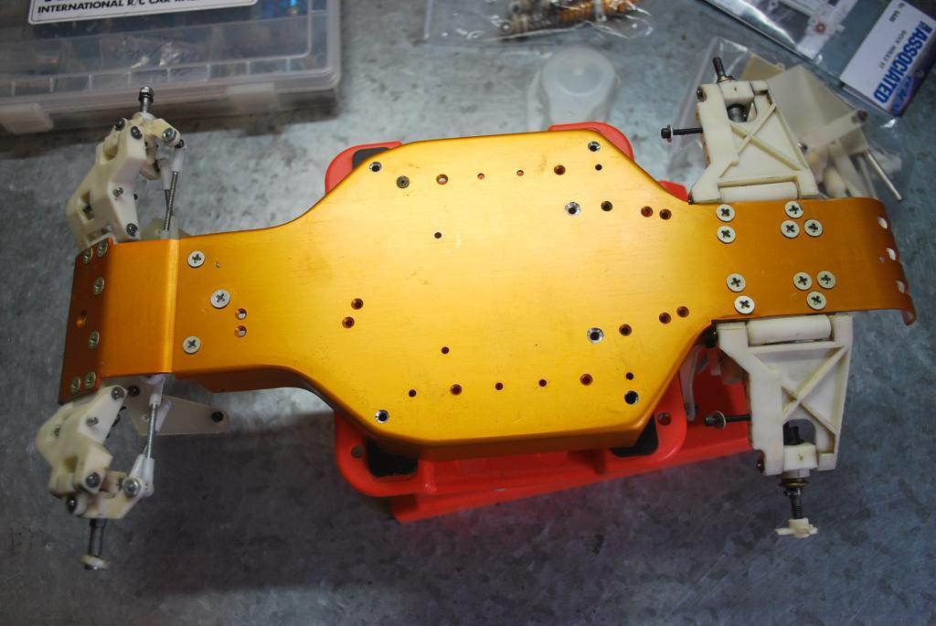

Here we go for this buggy

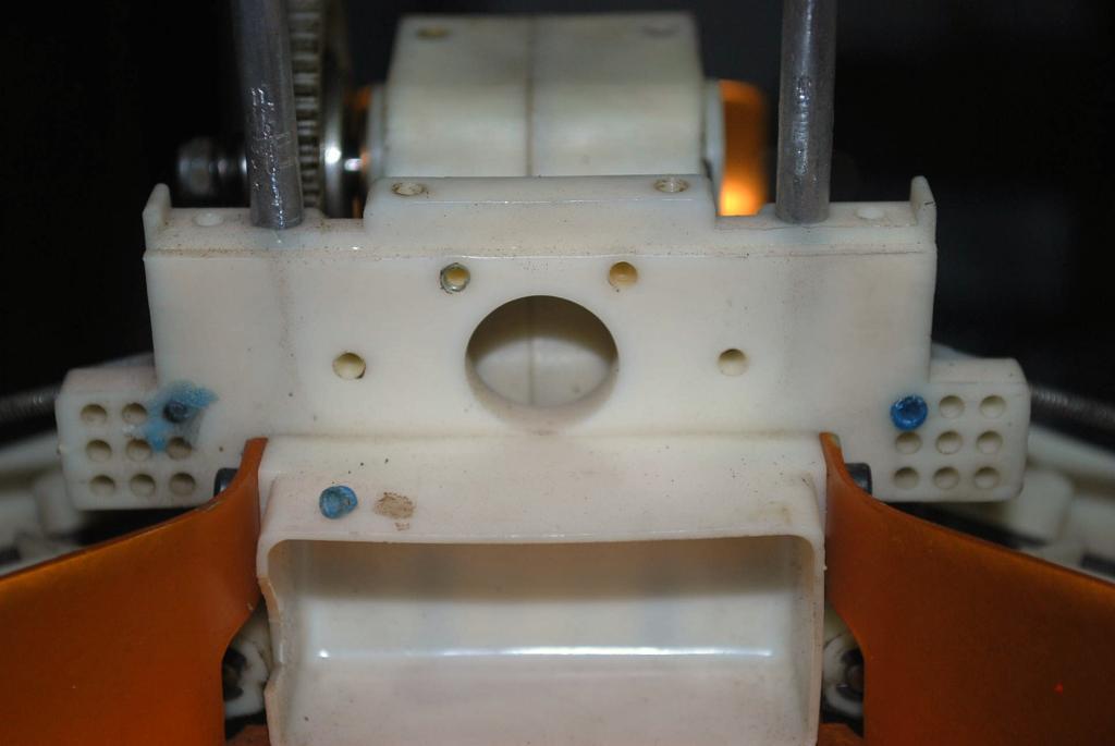

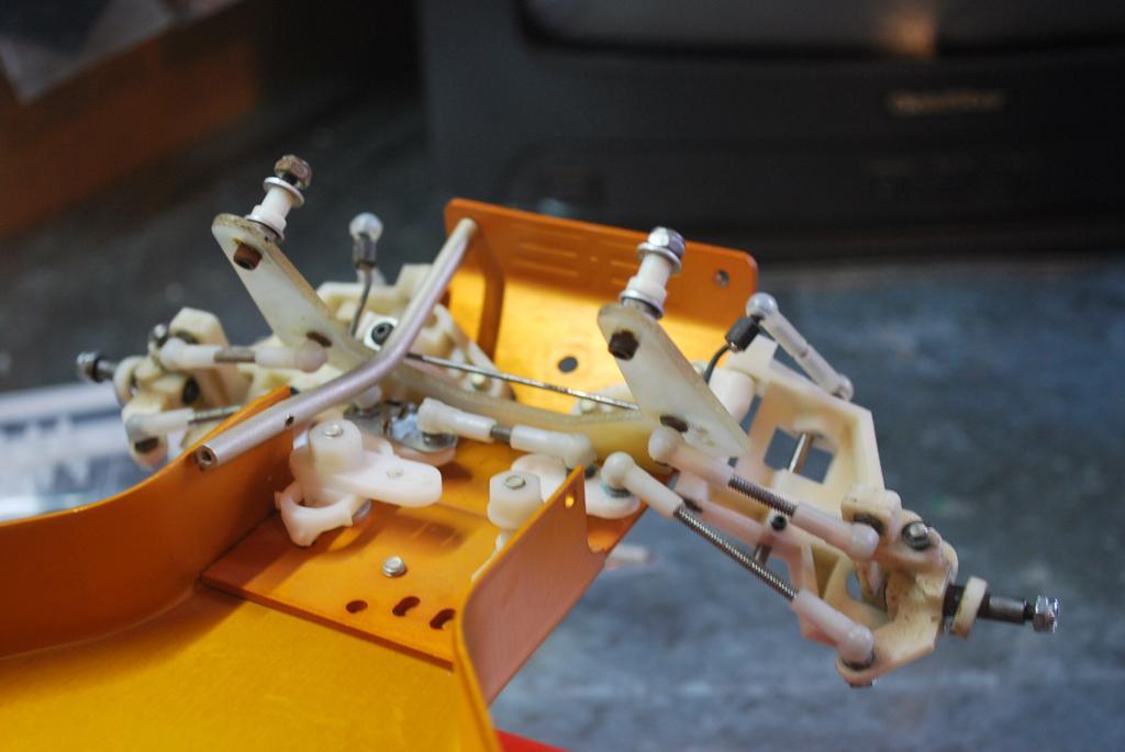

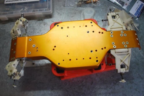

It's pretty much in very good condition. It took a really hard hit to the left nose plate, but I think it was only ran a few times before it hit something hard and then it was retired. That's my story and I'm sticking to it. It was put together really good. There was loctite on all the chassis screws, and ball studs and everything was well greased. The chassis itself is in great shape, almost a shelfer it it wasn't for a few drilled out holes.
Here are some photo updates
loctite fest Some intuitive engineering, lol Ready for cleaning. I will leave the tranny for later to clean, for some reason like getting the tranny at the end of the resto. I think that way I take my time

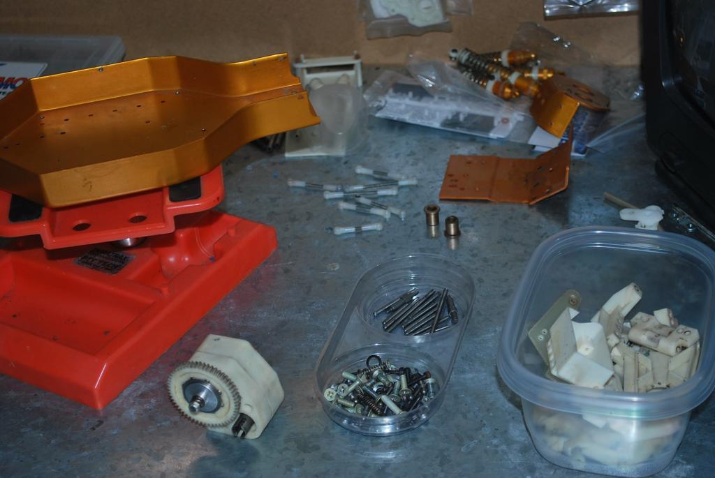

I got my shafts polished already
and the pins too.

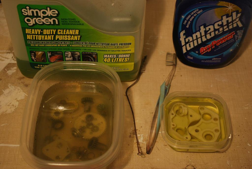

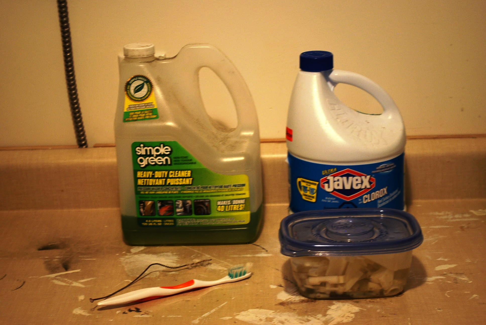

Here are my weapons of choice for cleaning and whitening this time
I washed everything good and threw the whites in a bleach bath for 3 hours with a 60/40 bleach to water ratio. Now I am in the process of the 20min boil. I'm off on vacation tomorrow so I will get it partially assembled before I go. I'm headed on a read trip from Nova Scotia to VA for about 10 days. Anyone know of some good hobby shops around Manassas, VA?

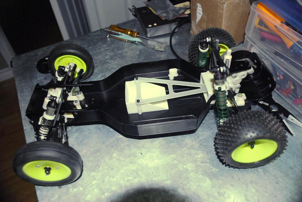

Well, here's how it sits for now, til I get back.

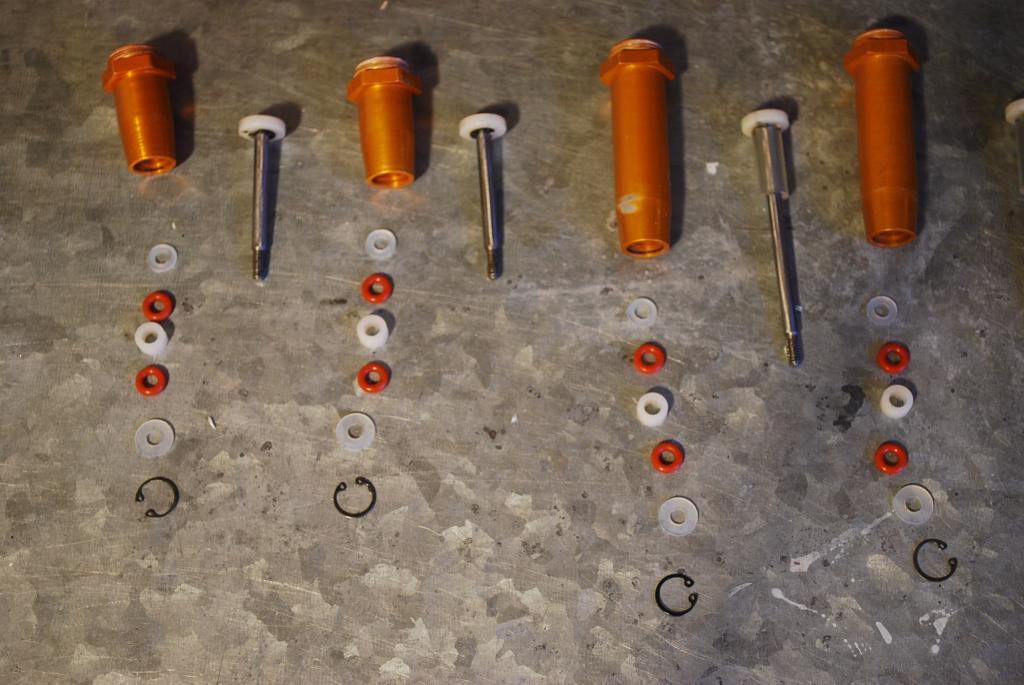

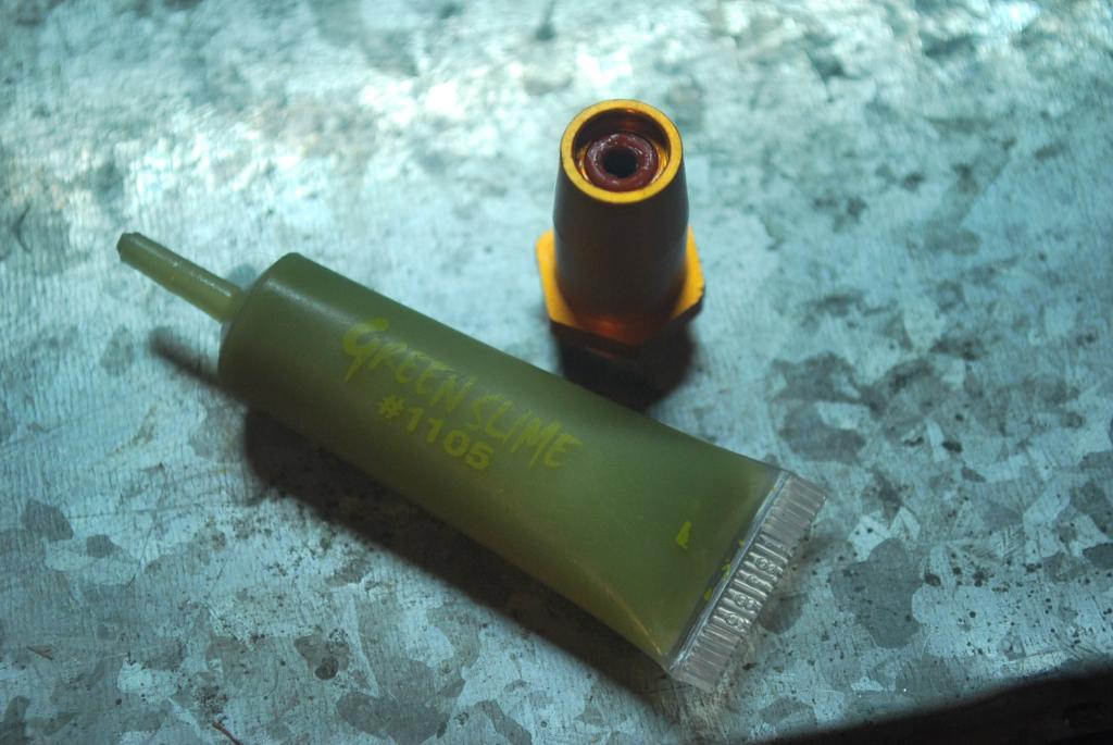

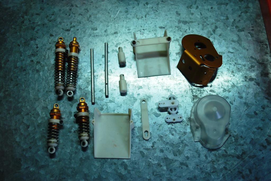

I hit the shock rebuild right after. First taking them apart, cleaning everything good, then while rebuilding them adding a very thin coating of green slime to each side of the o-rings. These shocks are smoother than the ones I did on the Worlds car somehow. They turned out really nice.

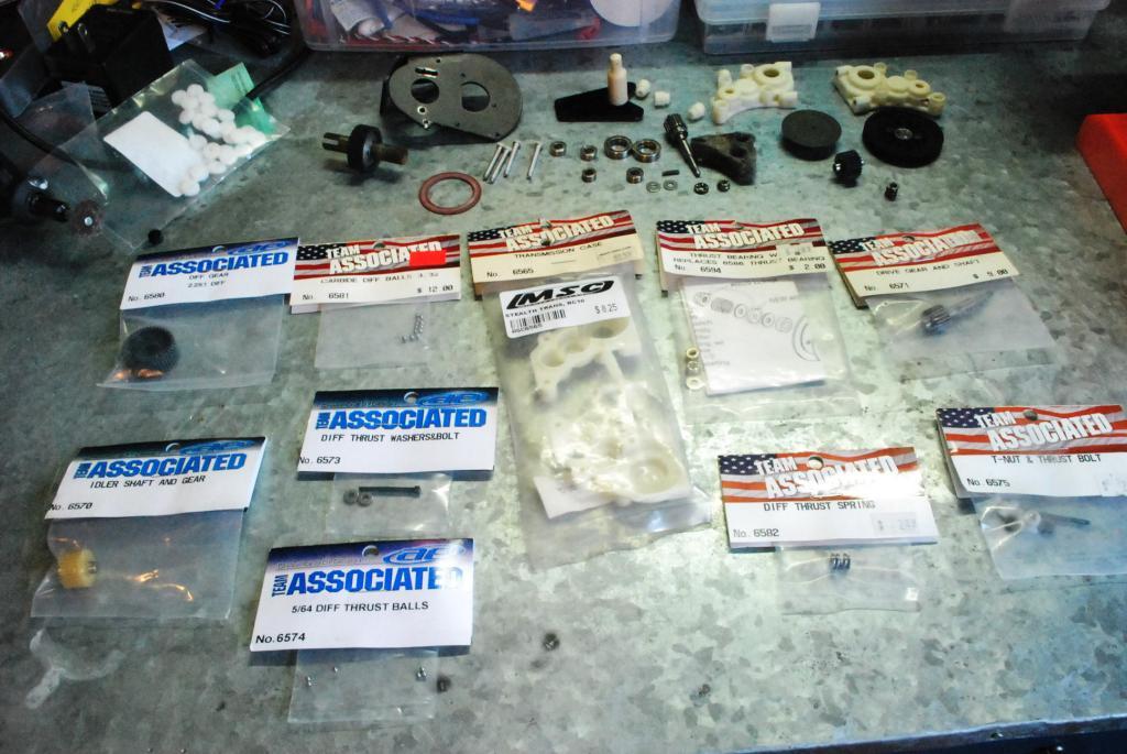

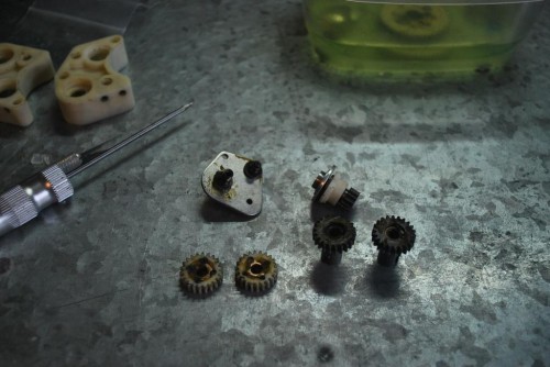

Next, it's tranny time! First off good trannys don't have bushes
This tranny was well lubed and dirty so it's having a bath and a good scrubbing. I noticed in the photo that the balls weren't dropped in this tranny yet, so I will remove the balls and wash them up
It's nylons will get some Simple Green then a 60/40 bleach bath just like the rest of the car.
