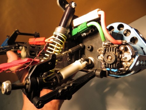

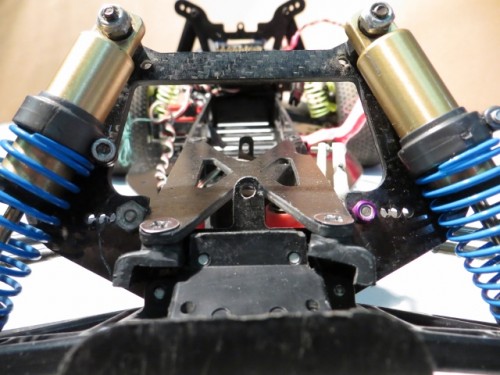

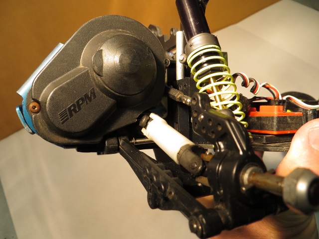

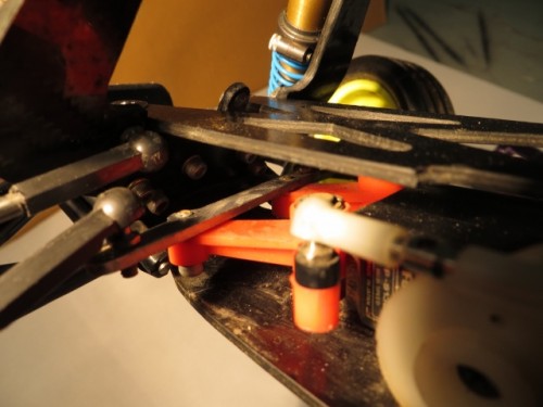

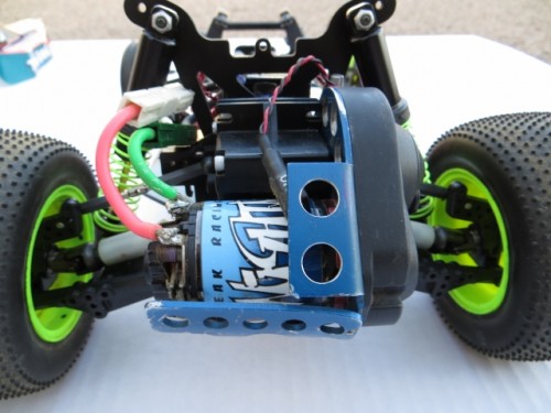

This is the remainder of the photos for the moment of the JRX Prototype chassis car.

Body: Jrx2 - There are curves in Your car chassis on both sides of servo (compare to JrxPro chassis) and You should cut the Jrx2 body about correctly from rear end (except rear shock should be "open") and so that the curves in Jrx2 body and chassis will fit together. Front end of the body should be made a little longer than the cutting lines are (I have a better picture coming from this to "my page"TheSpeedway wrote:Good Point - Race cars big and small change between and sometimes during every race.
If this car had the correct front end as it is suspected it would have raced what would that look like?
Does this appear to be the correct body for a car like this? I found TBG's reproduction on the internet and they say in their ad that its an Aftermarket Losi body.
Mark
Front end: JrxPro, except front axels should not have that set screw. Some other differences?
Yours Jirka

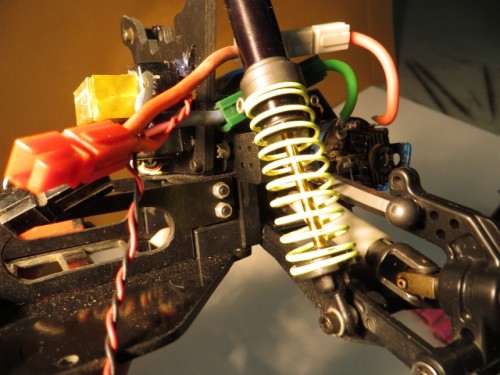

Mark, really interesting pictures

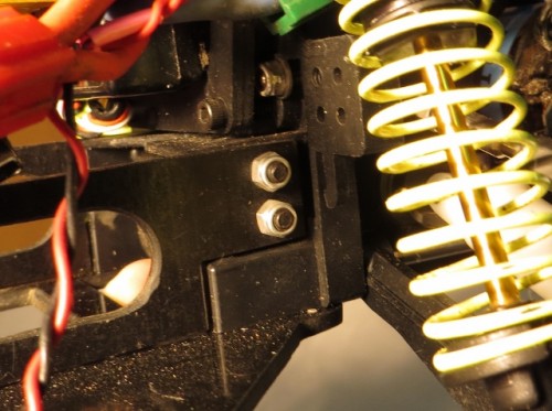

. The part between battery and servo was totally different than I thought and in pictures in "my page": http://www.rc10talk.com/viewtopic.php?f=27&t=25299 , see photos "Chassis photo 1-5 *". That part was made from one nylon piece and then the pictures from Jack's, Ron's, Mike's and Mark's are just a bit too inaccurate to see that part clear enough. Also small difference is the side rail mounting screws to rear bulkhead. On Jack's and Ron's cars they are in a row but on Yours they are on top of each other. BTW are those screws countersunk screws? Can we have a few more pictures from this part taken from rear to front?

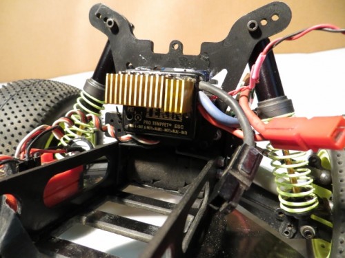

Then You have the right ESC for car

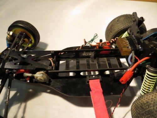

After looking at these pics closer, I'm wondering if that's a Litesink because it doesn't have the flat are for the heatsink to screw to...or the heatsink itself?
Could it be a Losi plate machined and drilled like a Litesink and anodized blue?

Isn't that what's bent over?LTO_Dave wrote:After looking at these pics closer, I'm wondering if that's a Litesink because it doesn't have the flat are for the heatsink to screw to...or the heatsink itself?

Here is the view your looking for - Swiss Cheezed. MarkLTO_Dave wrote:After looking at these pics closer, I'm wondering if that's a Litesink because it doesn't have the flat are for the heatsink to screw to...or the heatsink itself?![]()

It is a pair of locknuts on each side.Jirka wrote: Also small difference is the side rail mounting screws to rear bulkhead. On Jack's and Ron's cars they are in a row but on Yours they are on top of each other. BTW are those screws countersunk screws? Can we have a few more pictures from this part taken from rear to front? Jirka
Mark

A member thats not here anymore asked me how to do the chassis brace set up in his car just like this one.And he was from that area too. I remember the pick showing the screws sticking out the side at bulkhead exactly.don
