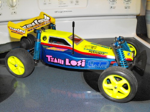

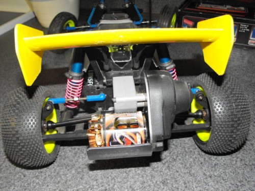

Re: Double-X gearbox for the JRX
Post by bearrickster »
I use the xx cvd's and standard xx bones
I use RPM H arms stock trans and stock xx mip cvd's. I built my car to run as much stock Losi parts as I could.
thats cool, let me know how it turns out. I built this car about 5 years ago. with out a local hobby shop to get parts from. I am sure theirs a better way. I just built it from the parts box.
