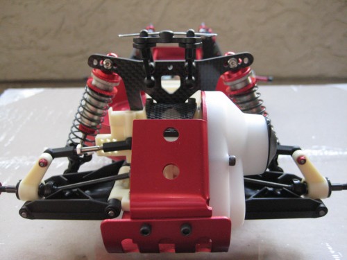

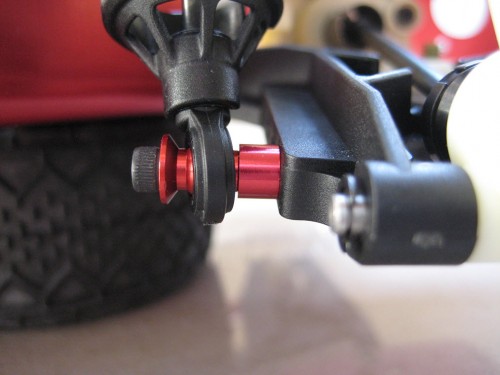

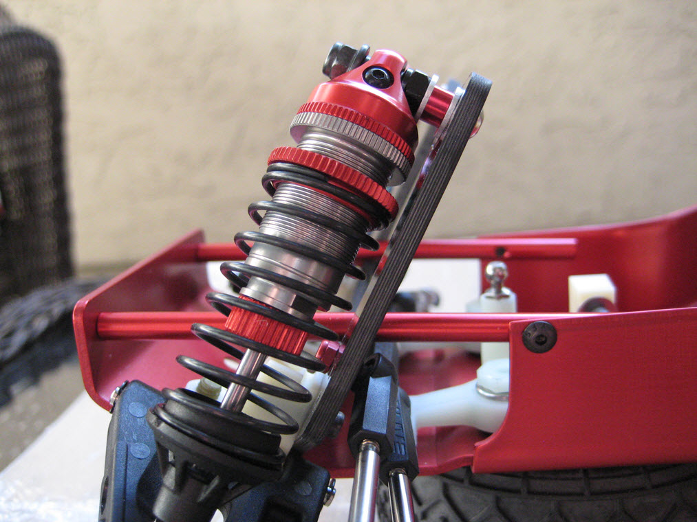

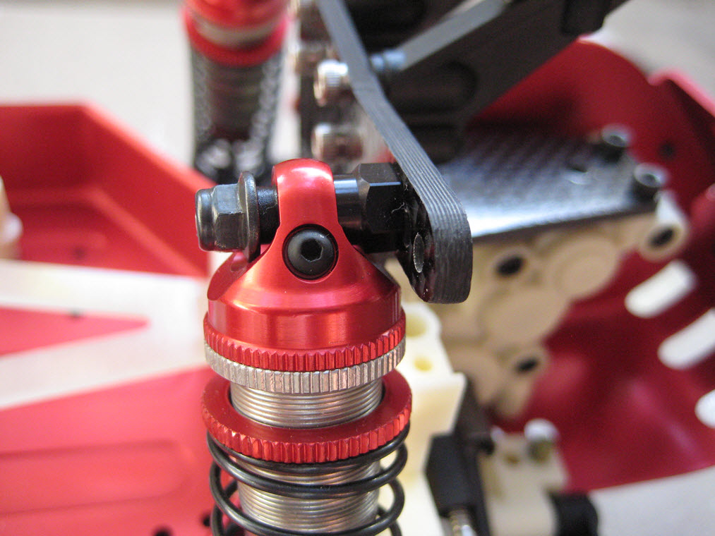

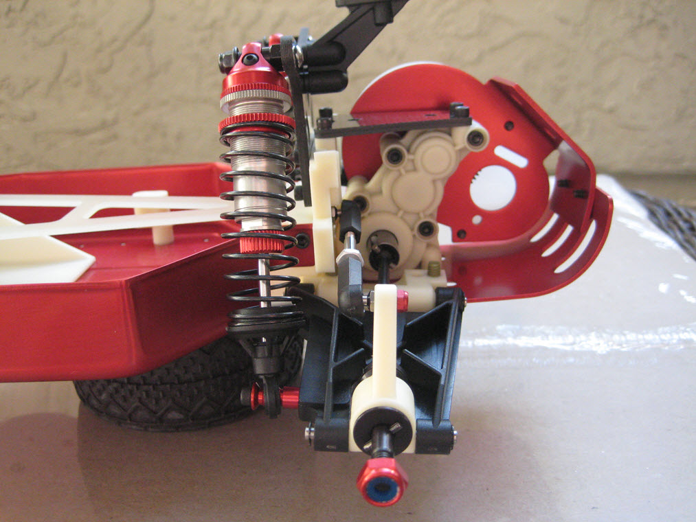

Not a lot of progress, but I had some time today to take some photos of the last mockup with the shocks. For the rear, I ended up using some 4mm spacers on the lower shock mounts. For the top, I was originally planning to modify 2 shock towers and laminate them together to provide the offset. But the way it is now seems to work OK, so I think I'll run with it like it is and see how it works. The front needed some spacers as well - that sandwich of washers and a 3MM spacer is just a temporary thing.

Please tell me it is an illusion that the rear shock leans forward, the rear arms with antisquat the move up and back. The further up they travel, the more of a bind they put the rear suspension into.

Thanks guys! I think I'll start another post for the discussion of running big bore shocks on these cars. I thought there was one already, but I couldn't find it? I'm sure I'll have more input once I get this to the track and I still want to try my rear tower idea.askbob wrote:Looks good! ...?
