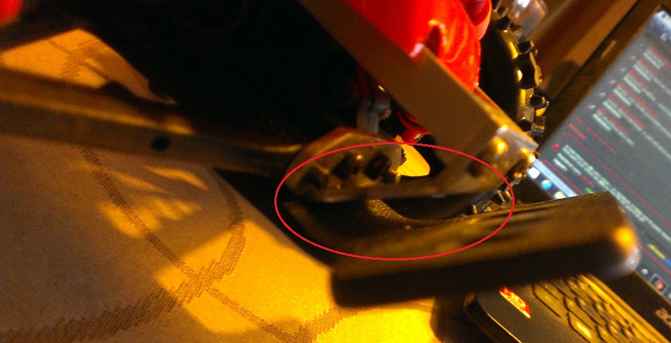

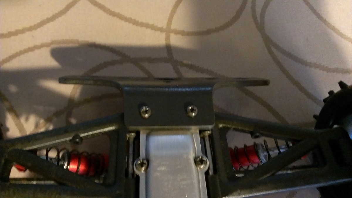

Regarding the bumper thing.
This is one is made from Kydex and the plan is to put a piece of neoprene rubber in the gap, and fixate it with a protruding 4mm screw and nut.
Hopefully this will save the tranny guard - I don´t use the shown alloy brace on my runners. Here, it´s either stock, 3D printed or homemade nylon.

Kyoshojoe wrote:When there is no give the gear box goes and possibly bent rails.
Actually, the part that always fails first, after the bumper brace bends/breaks, is the front skidplate. Almost every used, bashed Optima you see has this part bent or folded right up at the front. You rarely see bent frame rails and I don't recall ever seeing a damaged front gearbox with all the used Optimas and parts cars I've come across. The problem with the skidplate being the part that gets damaged all the time is it's bloody near impossible to find one that's NOT bent, and if you do, you'll have to give up your left nut to buy it.
I like the idea of having a crumple zone, but it's not engineered properly as such with the Optima. The bumper brace breaks way too easily, causing the skidplate to fold up. I like the idea of the Pargu alloy brace preventing this from happening. I think of the bumper brace being somewhat analogous to the RC10's nose tubes.
Dennis, I think you're onto something; I actually think the original design idea, bolting the bumper directly to the skidplate with that big nut & bolt, actually contributes to damaging the skidplate. I designed a custom bumper for Barney that's quite similar to your design. The hope is that the bumper's angle will help it to "skip" up off an obstacle, and not directly damage the skidplate as it's not bolted to the front of it. The alloy bumper brace is there just in case, but it's now a separate structural component instead of being combined with the bumper.
EDIT: I've seen some people simply cut off the bent section of the skidplate and build "runner" Optimas that simply don't use the bumper brace at all; as long as you can do without a front stabilizer and fabricate a custom bumper like these.
