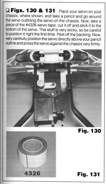

Looks good! Although technically the servo is not mounted correctly for a stock 7001 Rc10t ;)

I went back and forth on that when I put it back together, and settled on this way. How should it be?

Here is a pic of the servo part of the manual.. it works either way really, I imagine though they did it like this because of the longer arm of the servo saver perhaps? Mounting the ball at the end likely gives it much more leverage on the larger wheels? *shrug* Leverage is meaningless on a shelfer ;)
Just picking at nits... Looks great though :D

Thanks. Yeah, it'll probably stay as it is. It works great that way. I still have it set up to run with all the Futaba components and a 15T motor and the stock white spur gear back on. It will get brought down to run once in a while. I had it on 2S lipo yeasterday with this setup, it worked pretty good.
